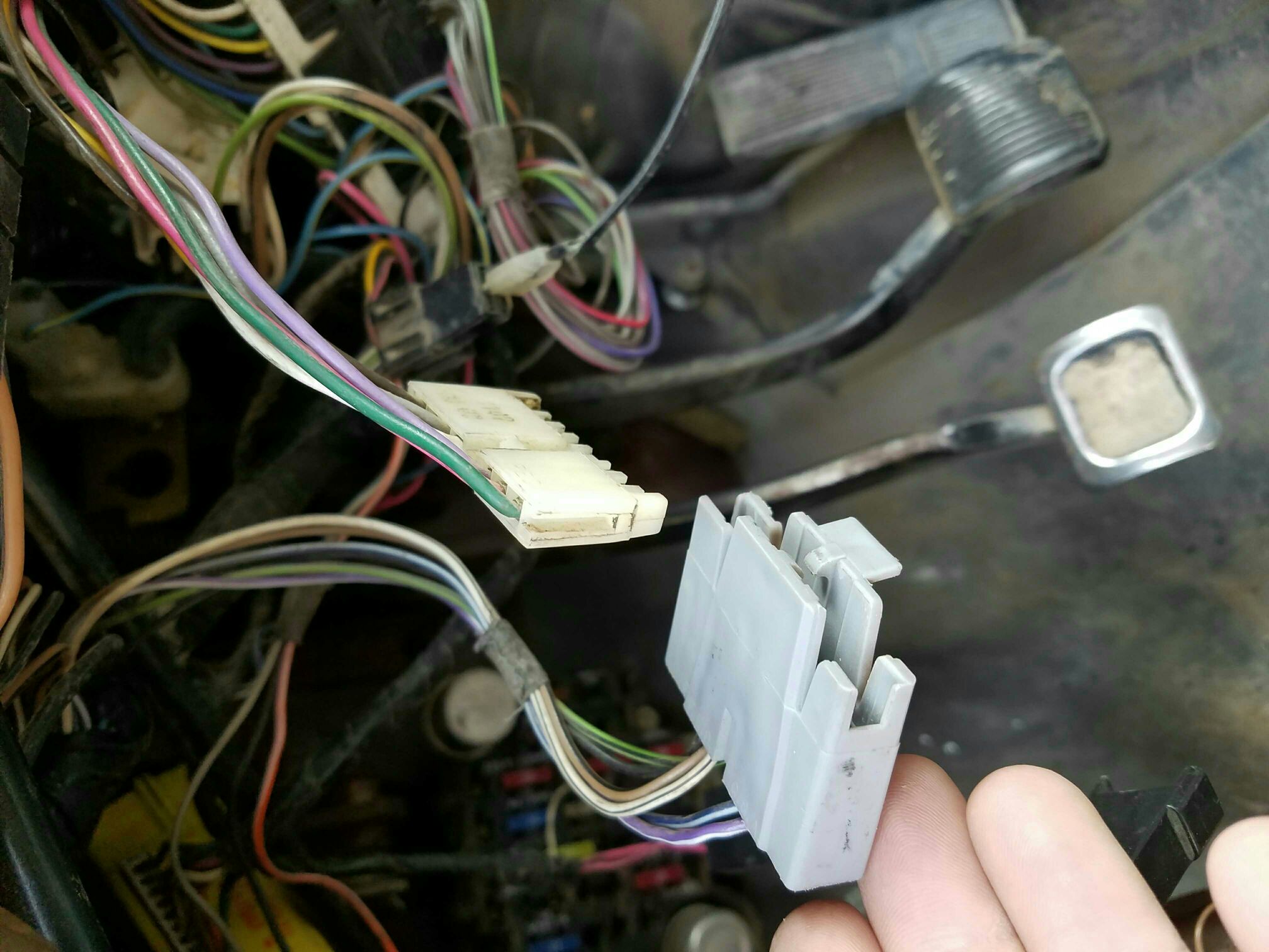

under the dash on the drivers side there is a black box Velcroed. it has a large flat connector on either side. this is the delay module for the front wipers. unplug both connectors and connect them together. this will bypass the module and rule it out. with this module removed you will have no delayed wipers but you will have high and low.
I unplugged the back box and connected those two connectors, nothing happened,
I disconnected it and with battery on I checked with a test light to see if it was getting power and nothing
