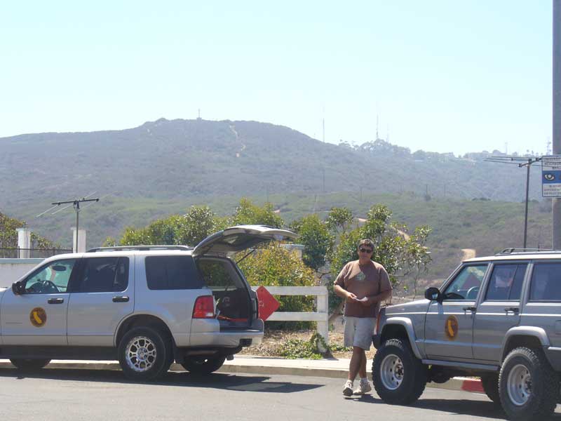

The Aussies run their antennas out front. They can see the antenna in the brush and the hood is a good ground plane. I ran my CB antenna there for a while but recently got creative and hand fabricated a fender mount to emulate the factory radio antenna mount on the pass side.
Here is my old set-up

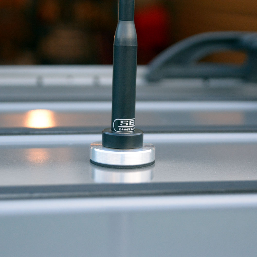

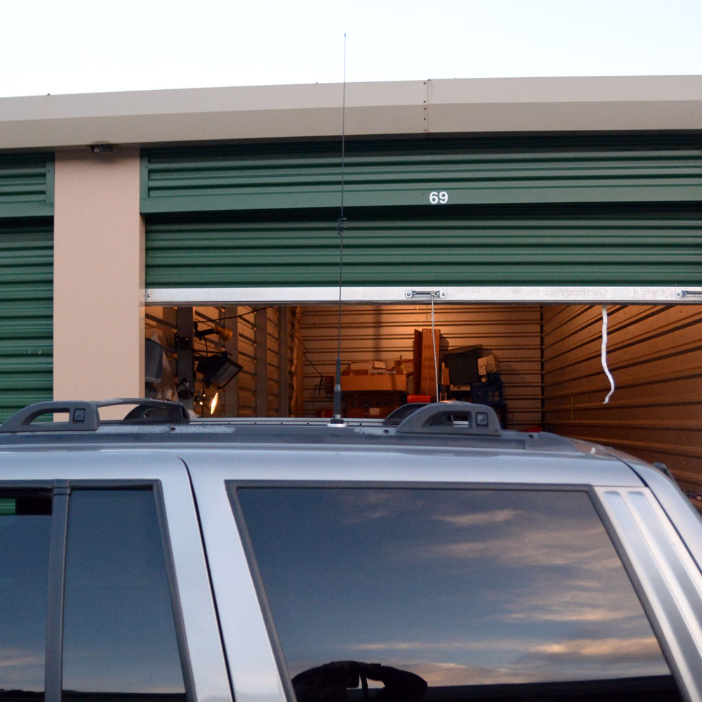

I went with a Breedlove #078 NMO roof mount (https://breedlovemounts.com/NMO_Mounts.php) for my Kenwood D710G install. The roof with a good NMO mount would be the best location. I used the same mount on my ZJ and XJ.
On the ZJ:
