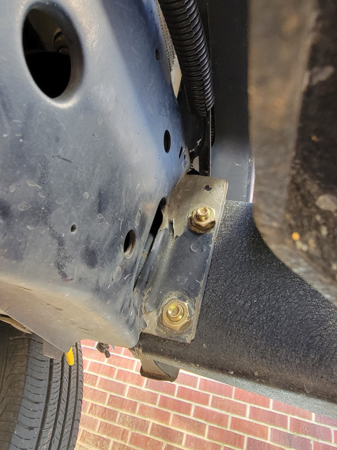

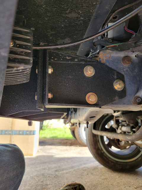

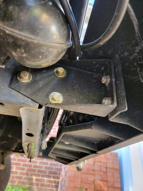

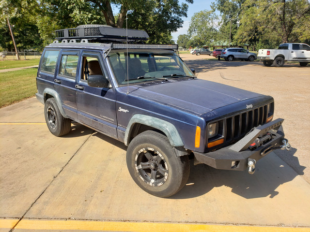

I have a 97 that I purchased with a Hooke Road bumper and a winch. Pretty heavy rig, but I notice now that it was mounted without any unibody tie-ins. Looking for recommendations for what to get considering that I'm not trying to build an off-road monster but a moderate overlanding rig. I'd love to get something strong, but I'd rather spend the big money on other things. Looking at the Dirtbound tie-ins and steering box brace for <$100. See below for the current config.
Driver side:
Passenger side:

I still wouldn't trust that bumper "with" tie-ins!
I find this pic from their webpage disgraceful and looks horrible, and if you look at your own pic it doesn't look/fit any better.

Ok, but how is that relevant to my question? I didn't choose this bumper but I need to make it work for the time being. I'm just trying to make it safe for my jeep should I get stuck someplace. There has to be a better answer to my question about tie-in brackets than "you're bumper is ugly and you should replace it."

The basic design and construction of the bumper was only meant for a "mall crawler". The main winch plate has no structure and bolted construction doesn't provide much strength along with the material type/thickness. The shackle mounts don't have any solid mounting either. The over-hang is about the most I've ever seen and no protection for your fenders!
Skip the whole idea until you can buy/build a good bumper.

If you slot the holes that are used to attach your bumper to its bumper bracket, then you could slide any number of aftermarket tie-ins underneath. It would certainly be better than the current setup, but its still pretty far from ideal.
If you shop for tie-ins, the main differences are:
- Number of bolt holes used to tie into the unibody rail. Some, like the ones that RCP_Phx made, go all the way back to the unibody tie-down hole which is a good feature. But be aware that on the passenger side, some of the holes in the unibody rail are not internally supported, so tightening a bolt going through the rail can cause the rail to collapse around the hole.
- Slot for the fender support. Some tie-ins do not have a slot, and its necessary to remove the fender support that many people say is not needed. Alternatively, a slot can be put into any tie-in with basic cutting tools.
- Material selection. I suspect that many of the ebay offerings are using low grade steel, but just a guess.
JCR is a good bet. C-Rok is another to consider. Both go all the way back to the unibody tie-down hook and avoid the unsupported holes, but both also do not have a slot for the fender support bracket.
You could also make your own and adapt them to any issues that might be a problem.
