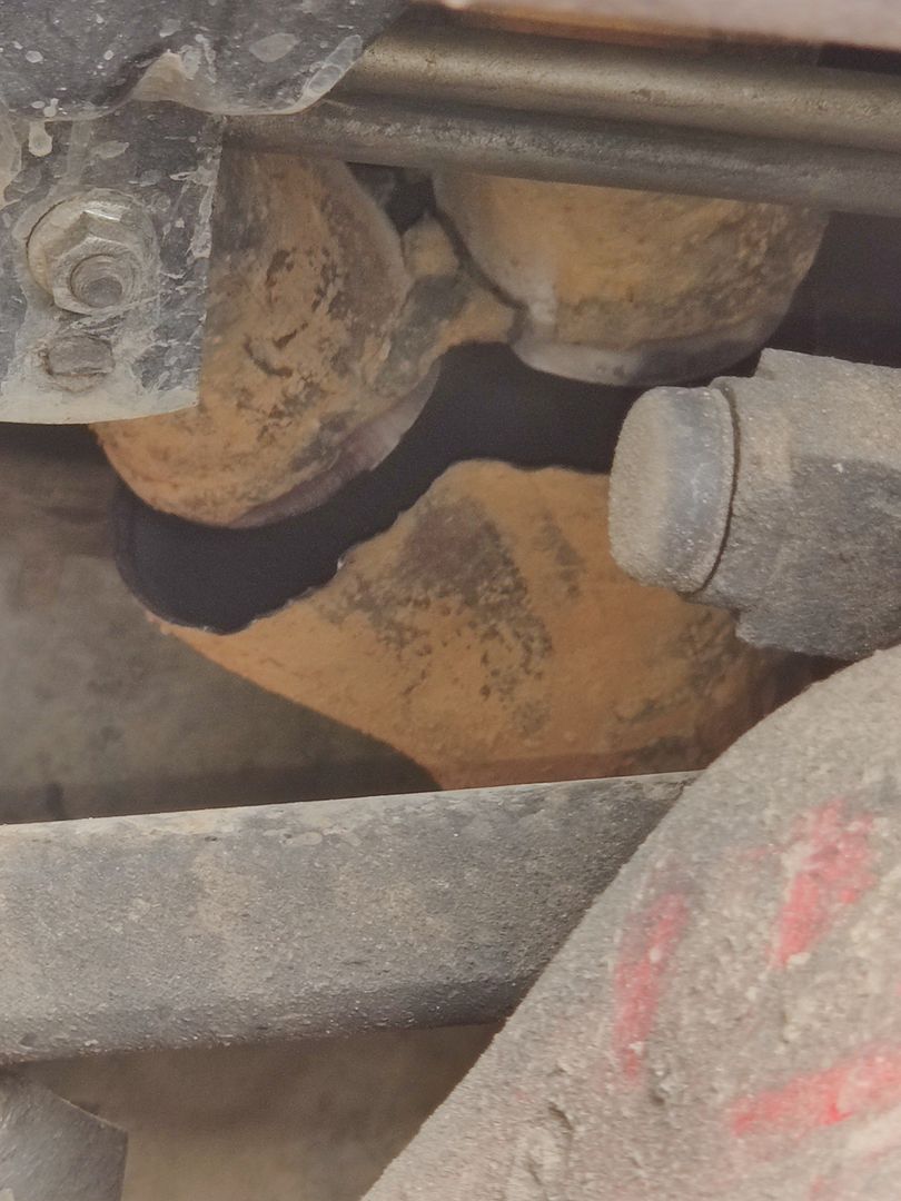

it was too dark to look last night after i got home but when i got to work this morning i checked it out.. thats what i saw lol.. too bad dallas is out of the shop at stinkyfab b/c now i need motor mounts and a new header.. i dont have access to a welder :/
