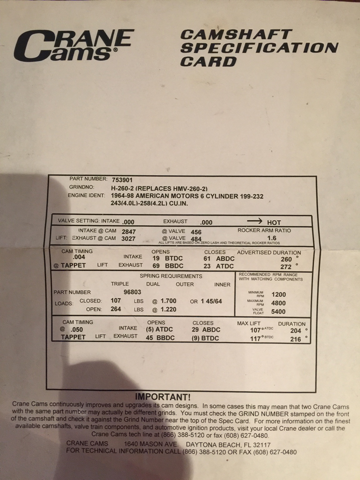

ALL the specs.
Tires, gears, trans, year, exhaust, header, intake, throttle body, what cam (lift and duration at least).
People need to know! :D
Stock tires and rims. Stock 3.55 gears. Aw4. 2000 with an aftermarket 3 inch header and cat delete exauest with thrush muffler. Horse shoe intake. Stuck the TB in a lathe and made it a true 60mm( there advertised as 60 stock but at the flange to the manifold it's 57) I'll post a pic of the cam spec sheet
