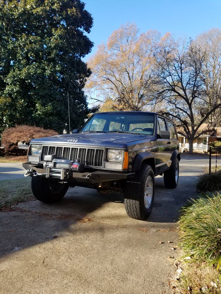

Greenspan, I'm sitting at ~2 inches of lift and 30s right now, no trimming and stock flares. No issues with coverage or travel, so unless you like the look of larger flares, you probably don't need them. I'll try to get a pic uploaded so you can see, but it's not immediately obvious that it's bigger than stock unless I park next to another XJ
Here's what it looks like

I have 4.5" lift with 33x10.50s and no problem with stock flares so 31s should fit with aftermarket flares no problem.
