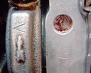

Stamping looks similar to this...

as mentioned, they are usually marked from the factory. do you have a pic if inside the housing? it is usually a letter, one going up and down, and the other going left to right. at least on all the Dana's that i have they are that way.
So i looked closer and one of the T's is going straight up and down, and the other T is going from left to right what does this mean?
It means you need to look on the surface the diff cover mates to and find the orientation of the T's stamped into there. Then match them up, and install bearing caps in said orientation.
Go back up and look at the picture MoparManiac posted.
