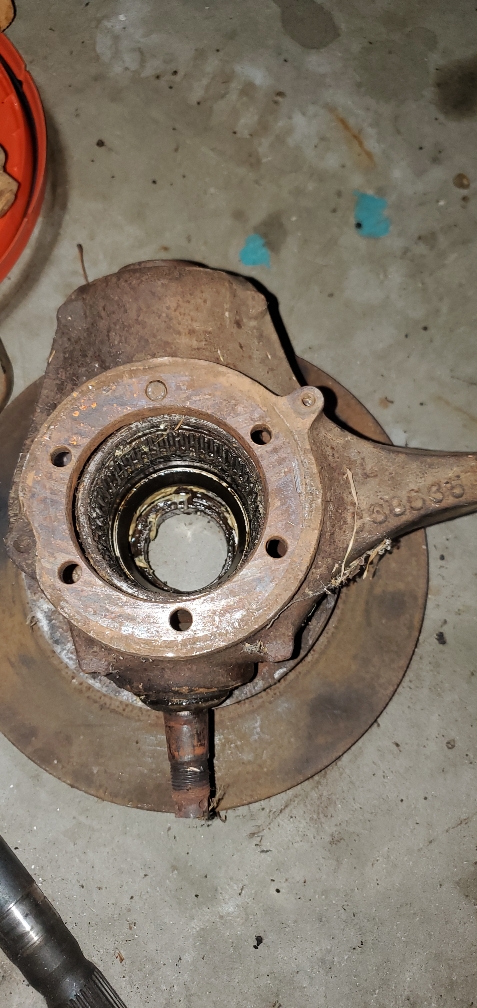

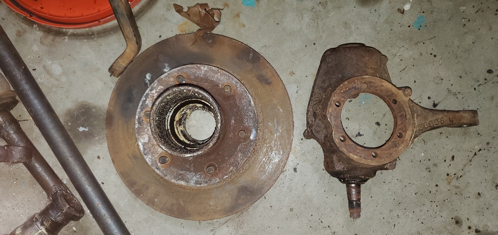

Looks like I have chevy 6 lug. Also six studs on hub
Here's both
