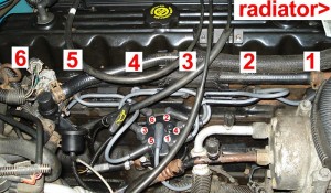

I may not be done because i havent indexed the distributor yet and i should but my problems seem to be solved. The solution. Basic tune up parts like i have read in threads before. The plugs appear to have been changed a loooong time ago. The gap was probably doubled. So plugs, plug wires, and distributor cap and rotor and no more stumble and buck. So in the process i learned to adjust a TPS, change the CPS, and to look for the simple solution first. Thanks for helping.
