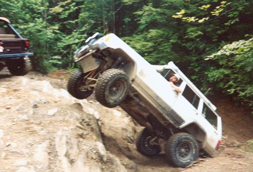

Been using the C4x4F front and rear bumper w/tire carrier since '99 and has worked well for me. I have modified the front bumper for better approach angles. If you are going to Moab you can check out the modifications that I have done.
C4x4F which I modified by radiusing upward from the winch plate around to the wheel well and trimming 2.5" off the sides where they meet the wheel well. Reinforced the inside front and sides with 1" angle iron and a 3/16 steel from the front to the side. Much stronger and have smacked it good several times and no dents on the lower edge like it used to.

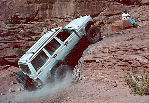

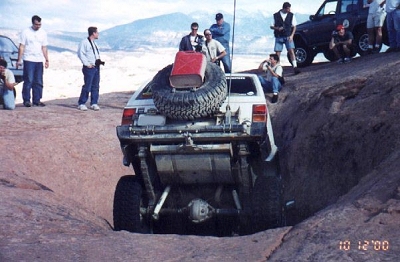

Yes and no. No it wasn't the buper's fault, and no it wasn't the swing out's fault. It was just that on the trails I run you can't have a big tire hanging off the back as I was dragging it over everything. It was acting as a lever and it cracked the unibody behind the bumper where the body and "frame" rails come together. I actually sold the swingout some time ago and will sell the bumper once I make a custom one that wraps around the sides and covers up my crushed quarter panels.
For 99% of the XJ drivers out there a rear mounted tire carrier should pose no problems what so ever and if you're going to get one the C4X4 is a very good option.
