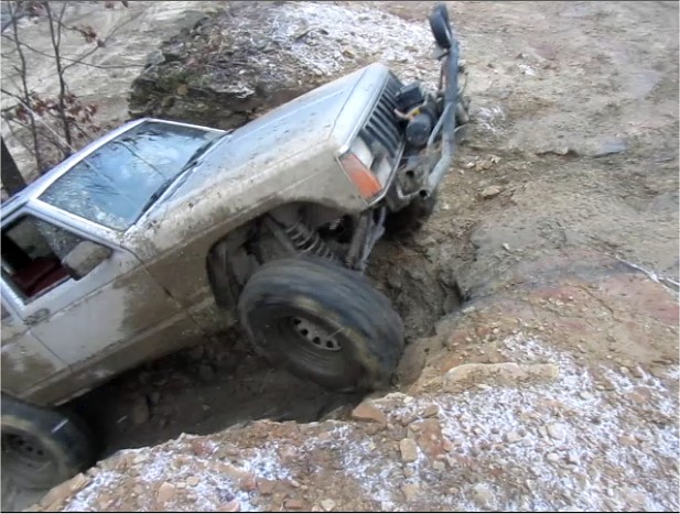

Went to my second WF and got my first real body damage on green.

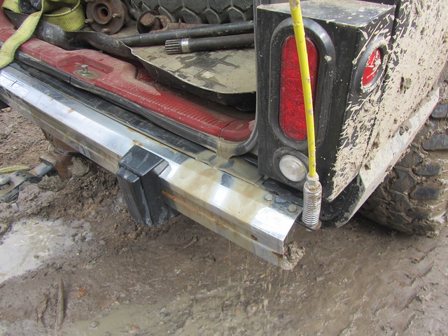

Then I started hacking sheet metal. Picked up a pair of Farmboy Fab tail light boxes and a Rustys bumper off of here, tossed on some 33's, and some F150 rear shocks to go with the JK fronts. Wheeled it some more.

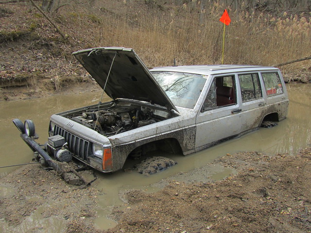

Went wheeling with Ram-Rod and his crew. Tara took this pic of my junk in whatever that hellish trail we went down was.

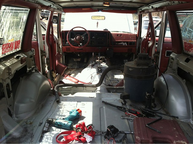

Spent part of Easter Sunday tearing out the interior.
Decided creature comforts were overrated and went with the minimalist look.

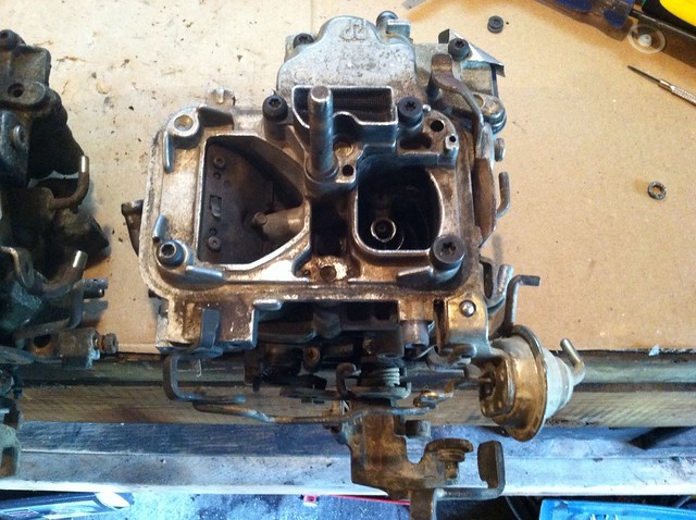

Rebuilt and stripped the 2se down into a bare bones carb.

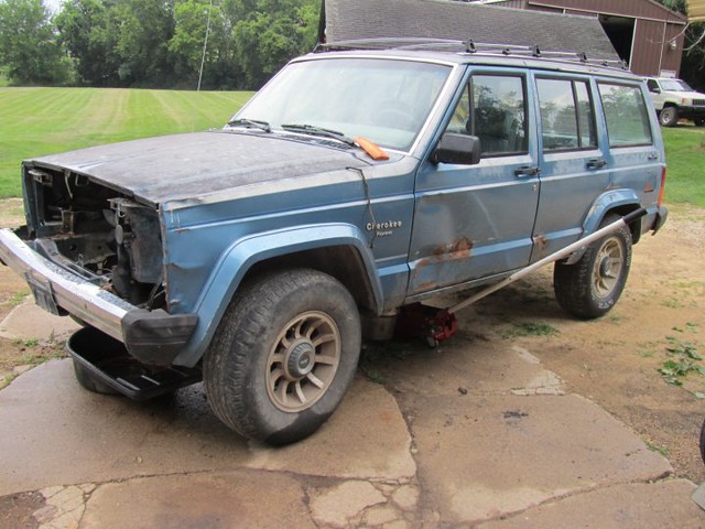

Pulled a 231 out of one of the many XJs laying around here. I had already rebuilt the 207 by that point and it was getting weird again. Figured if I was going to rebuild something, it better be worth my time.

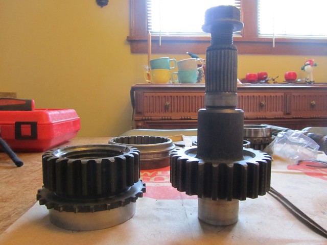

23 spline 231 long input from a 4.2L/a999/231 YJ vs short input

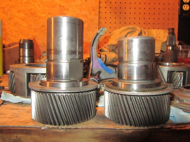

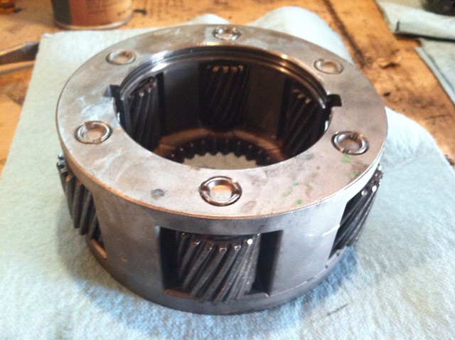

241c 6 gear planetary, early gear cut. I also used the range hub out of the 241.

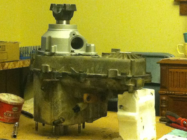

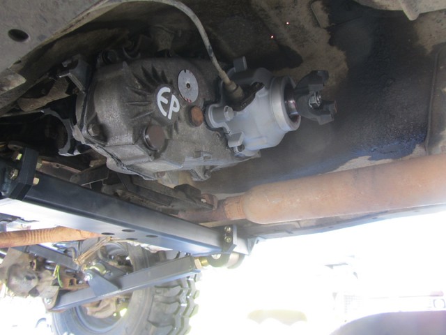

Picked up a JB Conversions SYE.
Used the front half of the YJ case since I still have the cad axle and the back half of the XJ case.

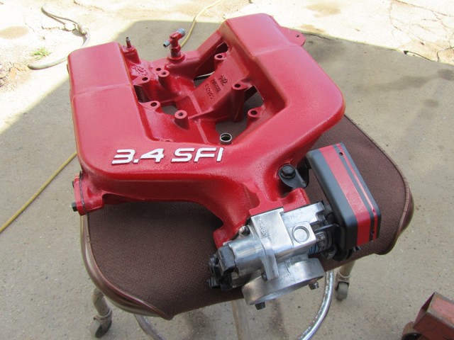

Painted the upper intake and polished the TB. Why? Who knows.
Nice and clean.

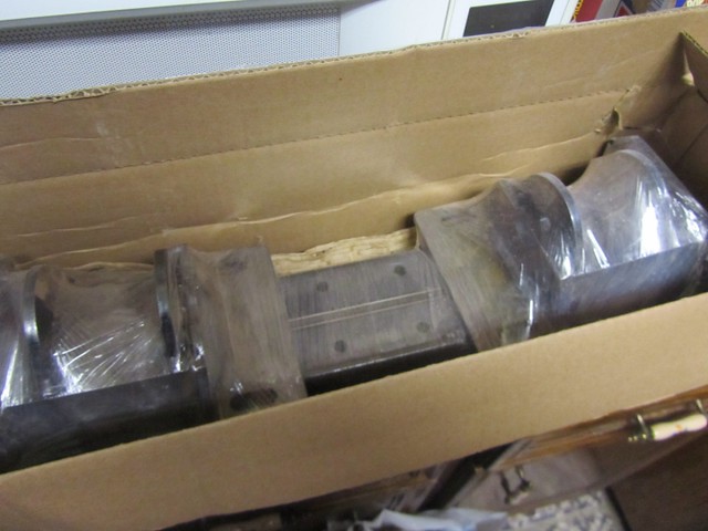

First roadblock, the flex plate. The 2.8L is externally balanced and the 3.4L is internally balanced. You can't use one out of the S10's because of the Chrysler trans. You either need to machine the weight off and have it neutrally balanced or there's a company that sells them.

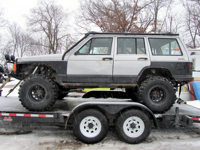

Somewhere in that time frame I cut and folded the rear quarters and put in a set of HD Offroad No Lift Relo's.

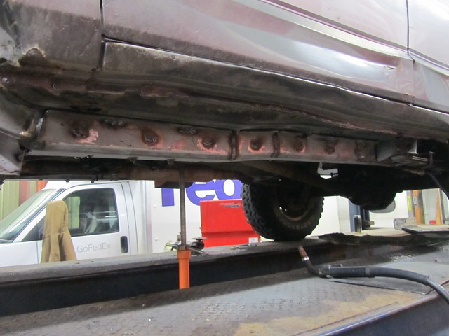

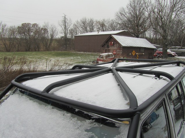

A few months later I had Brian put a cage and 2x6 rockers in it.

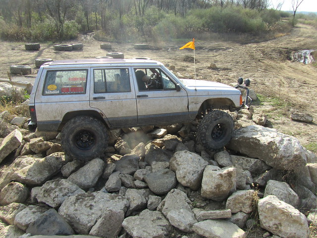

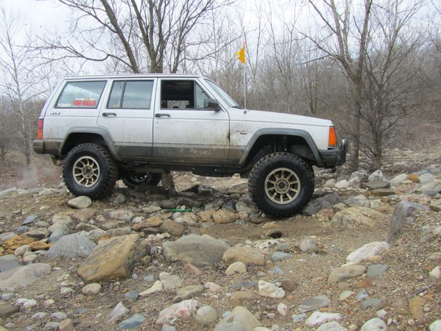

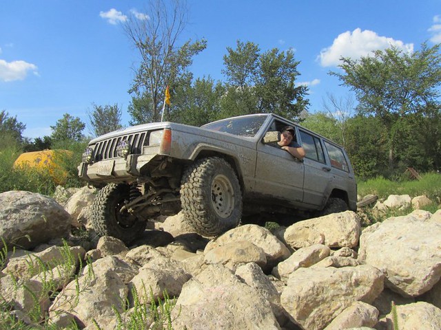

Went wheeling with Jerry, John, Brennan, and co.
Let Zac behind the wheel for a minute and he tried to chop down a tree with my junk. Hm, that didn't work out well.
For some reason I trusted him enough to drive it again so I could take this picture.

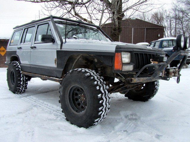

And this is pretty much how she sits now. The rear is up a little higher now since I moved the shackles back a hole.
