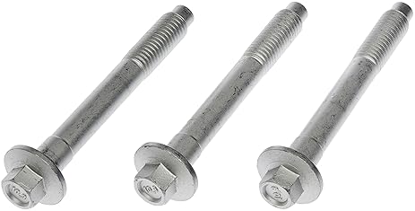

You can get them on Amazon with next day or 2-day delivery:
Dorman 917-509 Hub And Bearing Mounting Bolts
https://www.amazon.com/Dorman-917-509-Bearing-Mounting-Bolts/dp/B01ID3YKXI/ref=pd_sim_263_4?_encoding=UTF8&pd_rd_i=B01ID3YKXI&pd_rd_r=RCBPHRV62HWKPAZKCYHE&pd_rd_w=OQ6Cd&pd_rd_wg=qgyx5&psc=1&refRID=RCBPHRV62HWKPAZKCYHE
You'd be better off getting the correct ones versus generic due to the unthread milled down tip that helps you get it started.

My experience with Dorman's fastener selection has been that they are subpar. Chinesium at its best (which is to say, worst).
The pilot tip isn't a big deal. It's not a blind hole, and if I really need that feature I have a flapper disc on a die grinder. I think I can manage to properly thread the fastener into a hole 3" away. ;)
Also, real, graded, structural bolts will cost me about 50% less than those will. Additionally, I can get them in the preferred yellow-zinc coating (yellow zinc has better corrosion resistance than silver). At any rate I'm going to goop the heck out of it with antiseize anyway.
