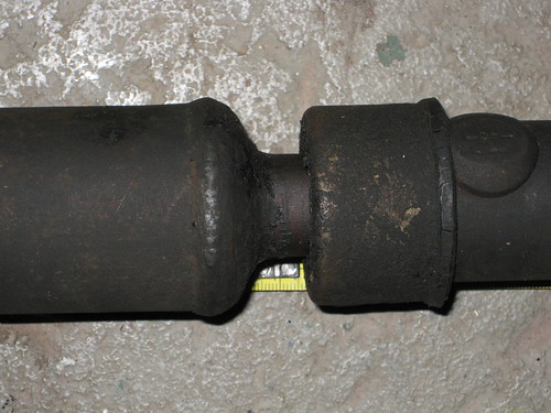

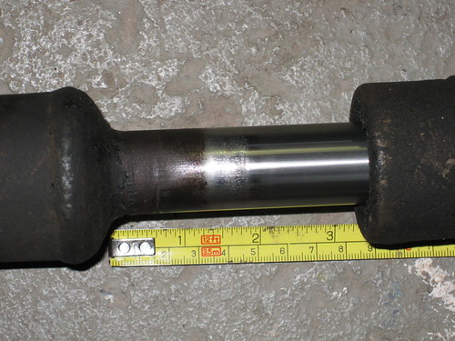

I took some measurements. Fully, compressed, the driveshaft appears to have about a .25" of space between the two sections. Fully, extended, there is about 3.25" of space between the two sections. There looks to be about 3" of travel. I had an overall fully extended measurement of about 34.5" from u-joint cap to u-joint cap.
One thing that I can say is that you may need to give it a good tug before it extends. I think the grease in the slip-joint. creates a vacuum.
'98 Automatic Front Driveshaft Fully Compressed
'98 Automatic Front Driveshaft Fully Extended
that looks like what mine had,

Hmm, all I can say is that pictures don't lie or forget. I also pulled this driveshaft out of a '98 XJ classic myself. From what I understand, all auto front shafts are pretty much the same. Perhaps it is binding.
