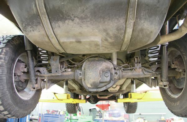

Hey guys just was thinking off the top of my head If you could take a rear axle from a ZJ and put it in an XJ since the ZJ has coil overs It would be fairly cheap if you had the fabrication skills, welding skills and patience. Just swap and make control arm brackets? What do you all think?
You can do anything with enough skills and money
Not much point in doing this though. The grand Cherokee aluminum 44's aren't worth swapping in
Also it just has coil springs, not coil overs
The zj runs coils springs and shocks, not coilovers. For the trouble of building coil buckets, control arm mounts, shock mounts and a track bar mount you'd be better off building a triangulated 4 link with mounts where you want them using the rear axle you already have. Or go to a 1 ton axle so you get the strength upgrade as well as the suspension upgrade. The factory grand cherokee mounts are week and hang pretty low.
My bad guys I meant coils and the whole point i would want them, or anyone who owns a jeep as a daily driver would appreciate a smoother ride
If it is strictly for ride quality it is a waste of time. If you want more travel, better control of axle wrap, and increased adjustability I wouldn't hesitate to go to a triangulated 4-link. Shackle angle and shocks can make or break the ride quality of any leaf spring set up.
Much cheaper and easier ways to do that.
I've daily driven lifted xj's and never felt the ride was an issue, unless I was running cheap or dead shocks
