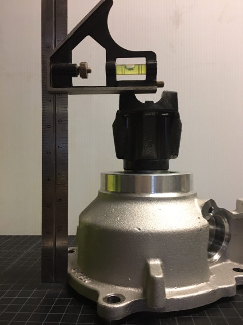

I just ordered an Advanced Adapters SYE kit for the NP242j in my 1991 4L Auto XJ with 3 inch OME lift. I'm trying to get an idea of the drive shaft I'm going to need without ordering a custom one if I can avoid it.
I have heard that often people can use a ZJ with auto and np242 front drive shaft. I'm hoping this will be the case for me or even better if I can use an XJ with auto front drive shaft as I already have one extra of those.
I know the length is going to vary from Jeep to Jeep with various lifts and other differences. But if anyone can tell me the length of the AA NP242 SYE kit shaft and fixed yoke that extends from the transfer case body I can use the TC housing as a constant measuring point to get and idea of the driveshaft length I will need for my Jeep.

Just following up here on my original post incase anyone else is looking for this information down the road and finds this thread. The Advanced Adapters NP242 SYE kit extends about 7 1/4 inches from the t-case body.
