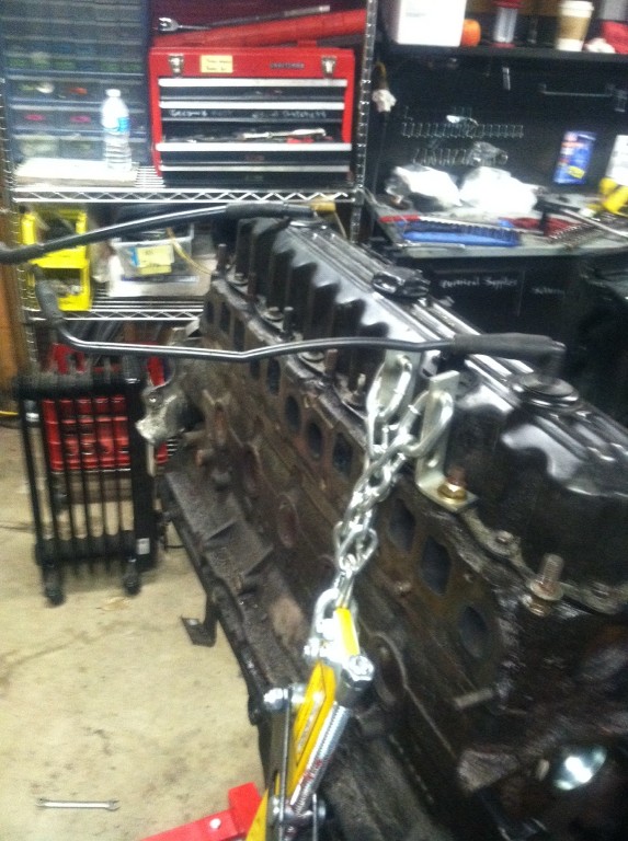

You should be able to see where I mounted the hoist from the pictures below, but on the exhaust manifold side, top of the engine, I used the 2nd and 3rd rear most head studs. On the distributor side of the engine, I used both top AC bracket bolt holes. I had to use some threaded links to allow me to hook the L-brackets from the load leveler onto the AC bracket side to get everything to fit where I wanted it.
To get everything straight and level I purchased a load leveler from Harbor Freight which I would HIGHLY recommend. It made adjusting everything a lot easier and took the stress out of maneuvering the whole thing away from the transmission, out of the Jeep, onto the engine stand, off the engine stand, and into the back of my dad's truck.

Thanks so much for taking the time to put up these pix, Jonner! That's a major 'solid'. Wow; I didn't think about using two studs and a load leveler. I was going to use a stock lifting eye from another car but it would have to be routed out a bit to slide over the 7/16 stud. I have a sweet bracket off of a Toyota for that A/C bolt attachment. I actually have a load leveler; got dig it out. Thanks so much,
