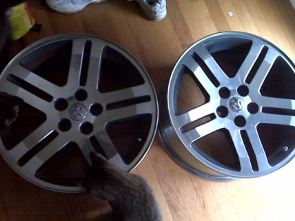

Found a smoking deal on some factory aluminum 18" wheels from a charger
$125 for all 4!

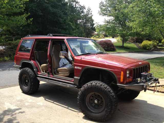

Anyhow, I have 33" Trxus mts and want to stay 31-33", cus anything smaller will look silly on my jeep

As far as I know about every tire manufacturer makes a 33 to fit an 18... what I'm more worried about is the offset and strength of those sports car wheels... even with some big wheel spacers it will probably still look a little homosexual. Just sayin
I think the whole jeep is gonna clash with them racecar wheels.
These are a stock JK Sahara wheel with 255/70/18 which is roughly 32.6" tall.
Just so you have an idea of what a 18" wheel will look like ... and yeah, I do feel kinda icky rolling on them, my friends crack jokes ... but they were free, and they got me on the road so I could get to work.
I think they look kinda sweet, I've seen another in the area that had charger rims. Looked pretty badass. Obviously these wheels aren't gonna get wheeled, I'm not worried about strength. Besides, these wheels live behind some big V8s.
As far as rubbing, I rub a Some now, just adjust my driving style. I'll get used to it. Thanks for the suggestions
I like those rims, would rather have those than my wife's leftovers (not a real fan of the Sahara rims is my problem really) ... for use on the road though ... I gotta admit they do work great, and should be a lot safer running up and down the winter roads than a set of Muds (and they'll last longer too). They almost make it look like a factory optioned XJ ... sleeper-ish, until I roll up to a stock one.
