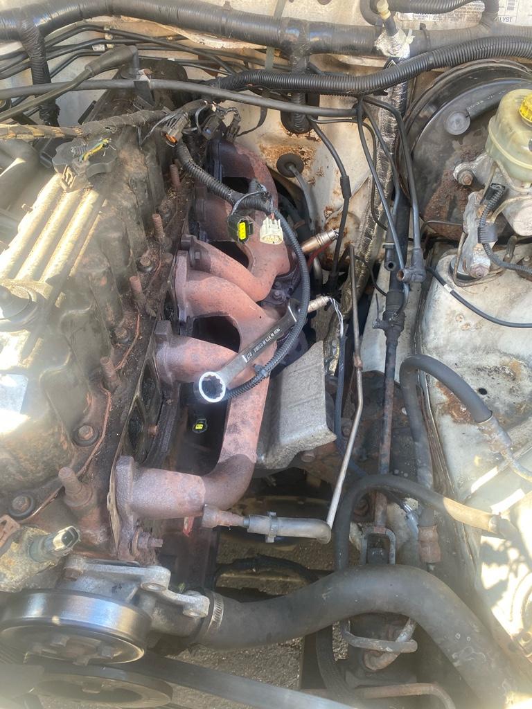

Changing out the o2 sensors and the rear post cat o2 sensor was hard wired in by the PO. I'm anticipating pulling the exhaust in the near future and was to add the plug back in. Dealer tells me the PN is 5013970AA but the crappy images on the internet don't seem right. 5013970AA looks like a square 4 way and the o2 sensors are round. Anyone have good intel on the correct part number?
The pre cat and post cat plugs are a slightly different shape to avoid mixing them up. I need the post cat plug.
BTW, really loved pulling the intake to gain access to the pre cat o2's. Also ended up pulling the entire exhaust so I could rework the dorked up bungs. 3 or the 4 needed a lot of work to restore the threads
Just a picture of the fun
