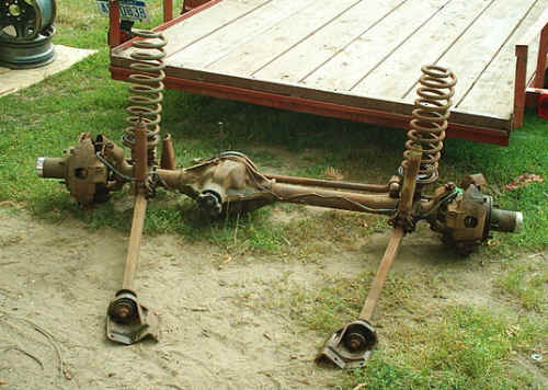

Sorry, i have limited time to search but i got a call from a bud who has a line on a 1976 Ford F-250 D44/D60 combo. Is this something that i should grab for my XJ or ZJ? I have to let him know shortly, oh and the front is disc to disc and the rear drum to drum $300. Any quick help would be appreciated!!! - Thanks!! -B

correction the f250 axles are 8lug. and all you would need would be a bracket kit like the ones RE sells or ballistic.

I would go for a F150 5 on 5.5 rather than the F250 8 lug setup personally. Here are some specs for the F150. However, if you like the 8 lug setup... go with the 1978-1979 F250 Reverse Cut / High Pinion setup.

There's no problem using an HP44 out of an F-250. I have one under my jeep right now that I bought already narrowed and welded up from someone.
If you're planning on running high steer and want 5x5.5, either axle works as you'll be ditching your Ford outer knuckles, spindles, and caliper brackets.
