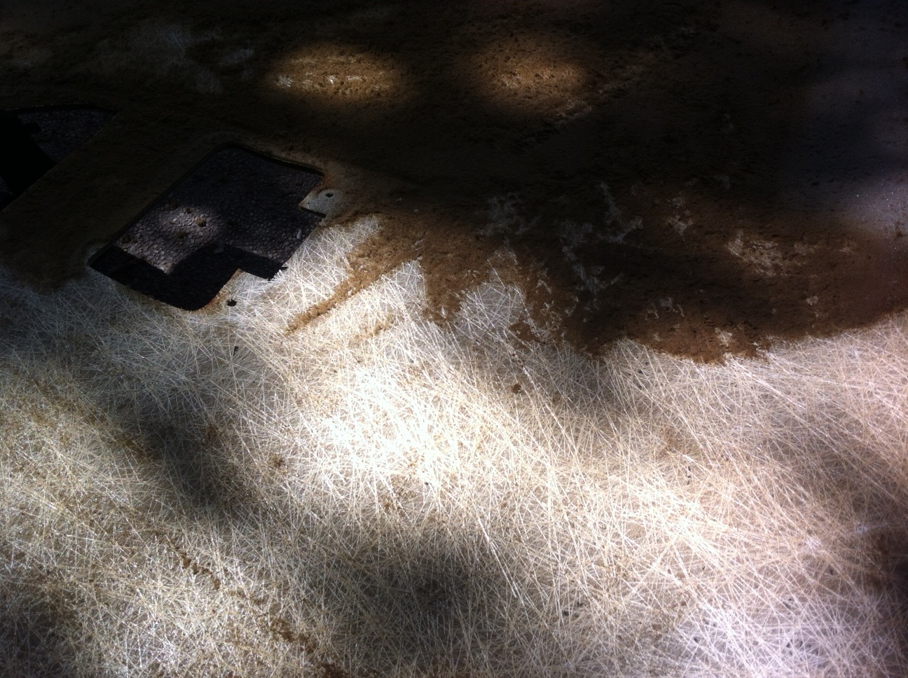

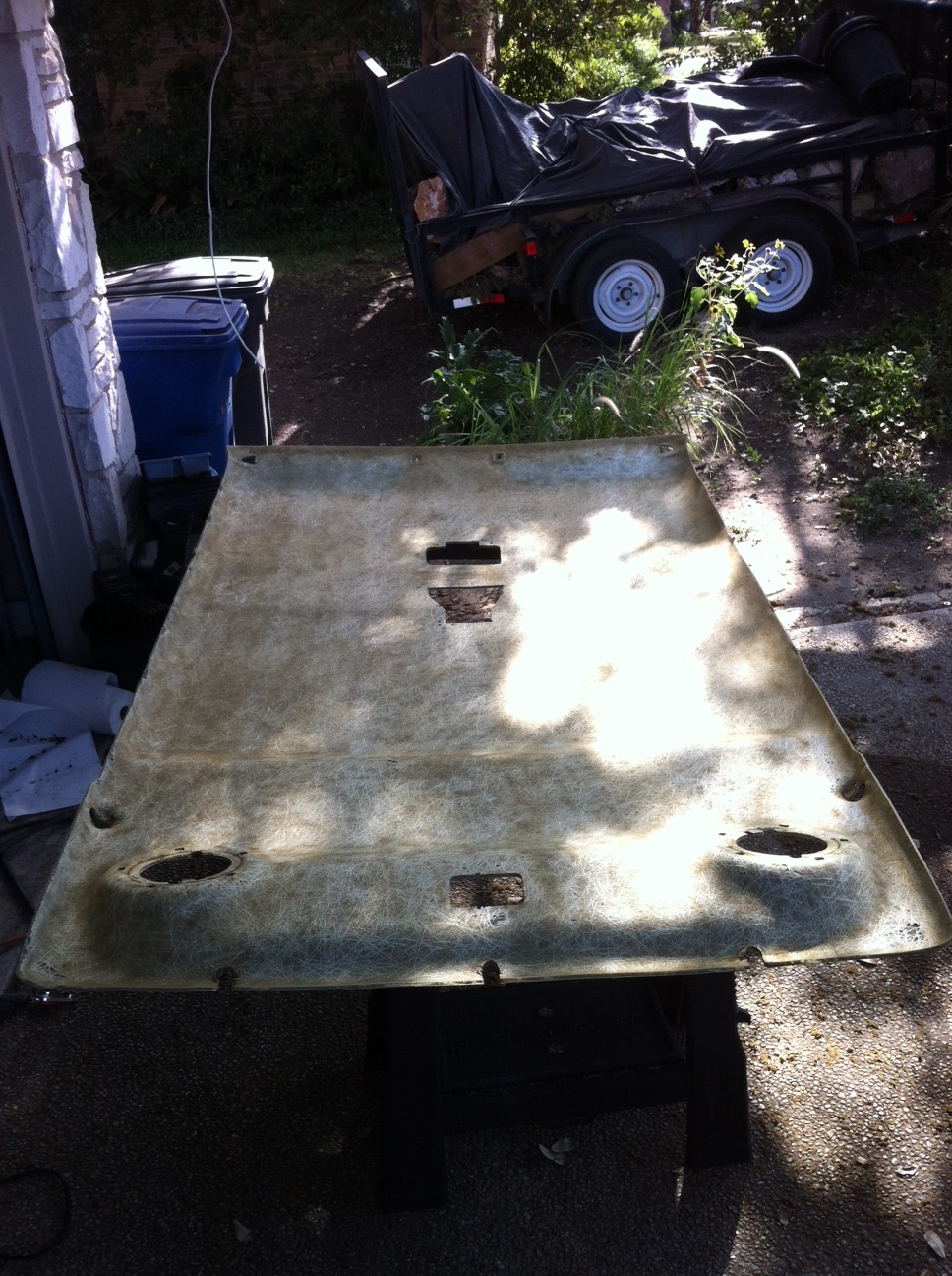

In my case, was referring to the main headliner board itself - the shaped piece that appears to be open-cell foam sandwiched by fiberglass-like material (long strands sealed in with something harder than foam, but flexible). This board is what the headliner material (the foam-backed cloth) is ultimately glued to.
A friend recommended applying fiberglass resin to the headliner board before applying glue to ensure the board didn't soak up the spray adhesive. Even though it had a nice solid surface after stripping the headliner (low-speed drill and a wire wheel combined with a fine touch made this SUPER easy - took 45 minutes start to finish), I went ahead and slapped on a layer of fiberglass resin to give it some reinforcement, and to give the glue something better to stick to.

A SS wire brush was used to remove the old foam from the board, hitting it twice to get is completely free of the old foam and glue.
The edges of the board had a few soft and/or damaged spots and were repaired with five-minute epoxy and drywall tape. The rest of the board was left untreated.

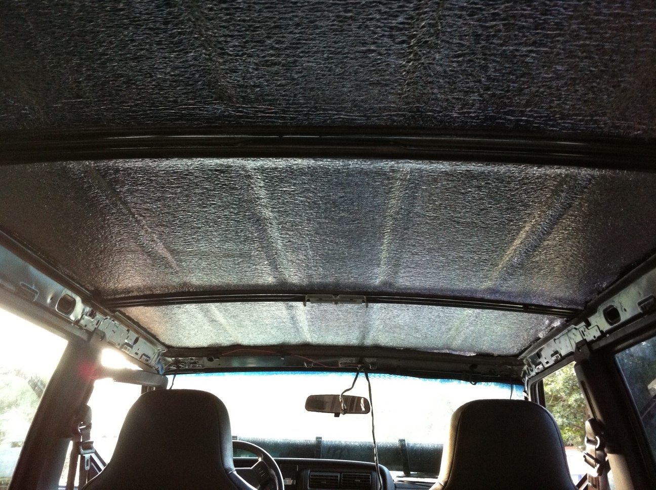

I did figure out the wire wheel + low speed drill trick... It only took about 45 minutes to strip the whole thing, plus another 20 minutes to throw a layer of fiberglass resin on it. I also installed EZ Cool (ordered it after seeing Muddbutt's "Tin Foil Hat" thread), which took a little shy of 30 minutes... I'm quite glad this wasn't my first spray adhesive rodeo.
