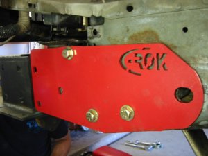

I do believe that our frame plate would help out here.
I know there are mixed opinions about the cross frame box braces. I personally think they are beneficial but I know for a fact that they do not prevent frame failures like these.
What I've seen with the cross frame supports that grab the box at the sector shaft output is that they hold that portion of the box rigid but the box pivots about that point and still allows noticable flex at the bolt locations.
Our plate stiffens the entire area where the box bolts to and distributes the point forces from the bolts over a much larger area which reduces the stress concentrations that cause the cracks.
