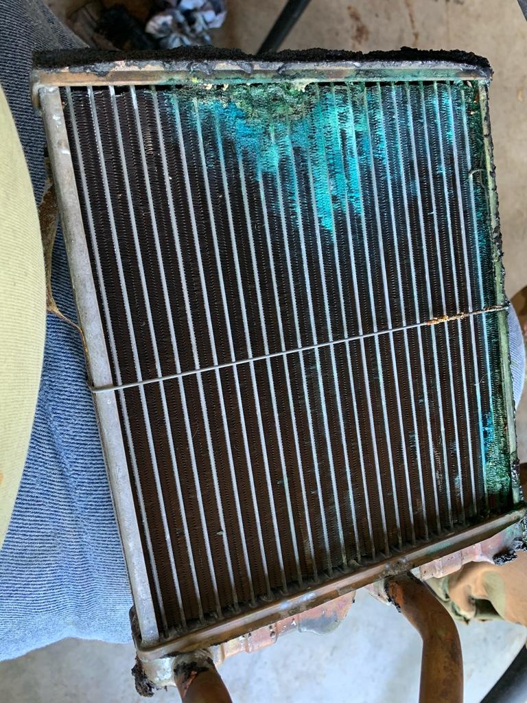

All summer I have known about needing to replace the heater core in my 1994 XJ. I'm dreading that job as everything I have read requires a lot of component removal (dropping the column, removing the dash, disconnecting the A/C, etc.). I never use the air even though the system is pressurized. I'm thinking of just removing all the A/C stuff altogether.

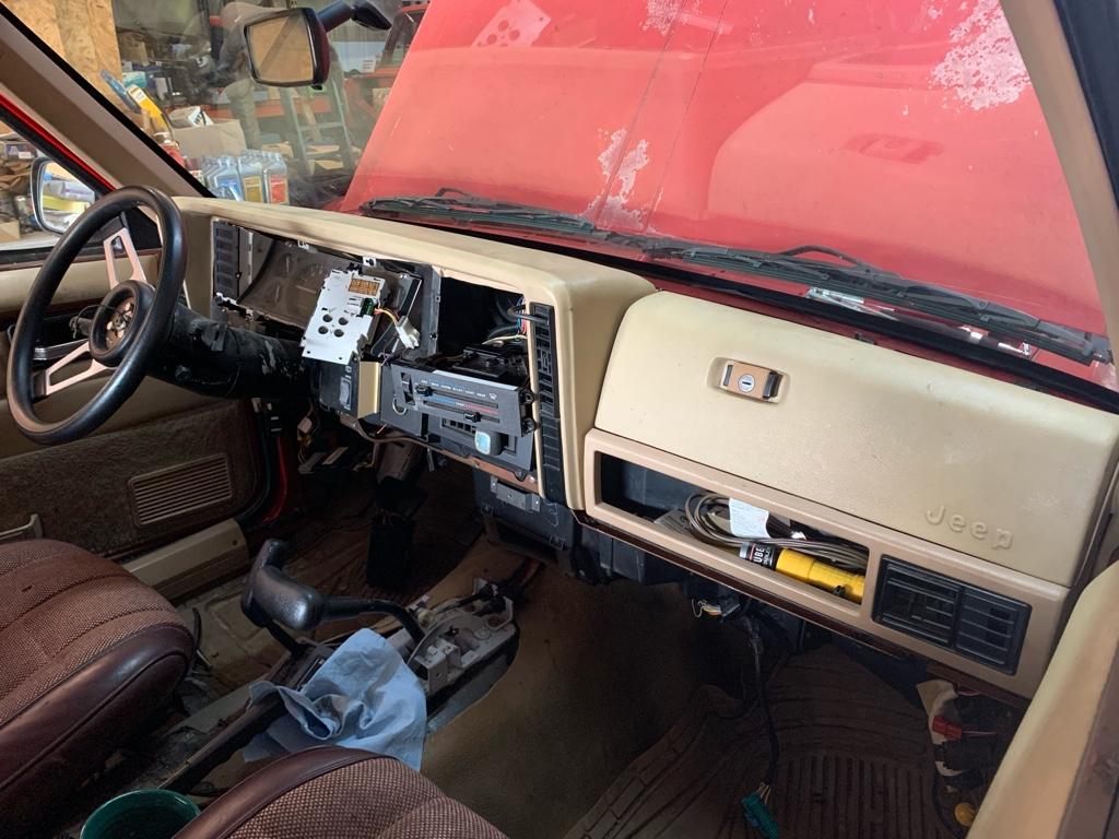

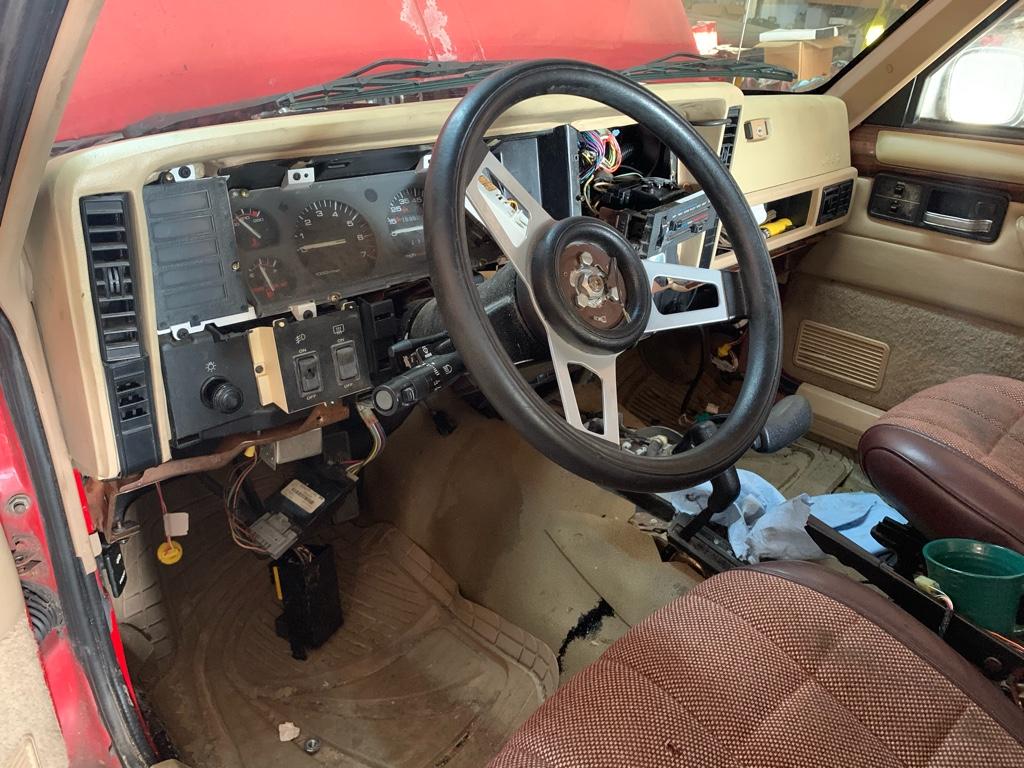

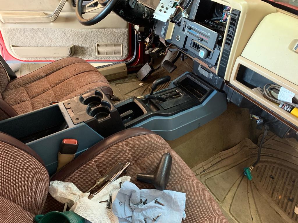

I'm not sure on the earlier ones, but on late models i've been able to get the dash out without having to remove the column. Lowering it to it's lowest setting was just enough.
The dash also comes out, for the most part, in one large piece. The hardest part is finding all the little screws that hold it to the firewall, and unplugging everything underneath.
Yeah, and it's going to be even more fun with my big, fat hands....LOL.
Last time I removed the dash in my old xj I didn't have to remove the column just unbolted it from the dash and let it hang down on the seat. UNCC's right the hardest part is finding all the plugs and disconnecting them as well as splitting the through firewall fuse block. Besides that you just have to discharge the a/c and drain the coolant from the heater core to remove the hvac box.

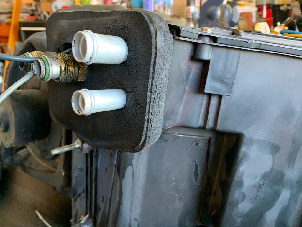

For my 1994, they list an aluminum and a copper/brass heater core. The copper/brass is actually cheaper. Is there a benefit to going with one over the other?

It looks like I'll be getting ready to replace my heater core soon. It's starting to get cool out at night and I need to be able to defrost the windshield and interior glass. It's marginal at best now.
I found RockAuto has great prices on either an aluminum or copper/brass heater core. I think I'm going with the copper/brass one made by APDI/PRO For $36.

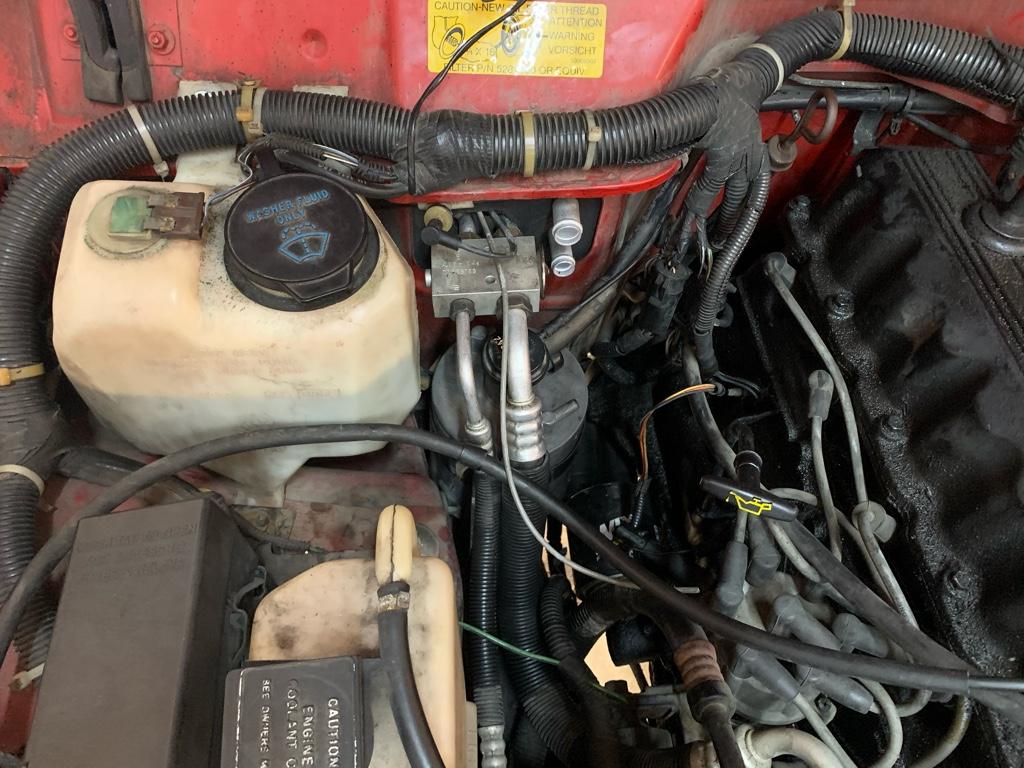

The AC system is still sealed but doesn't blow cold. I never use the AC. Since I have to open the AC system up, would it be worth reconnecting it? I don't use it but are their any benefits to having it functioning?
I have thought about deleting everything with the AC system to clean up the engine compartment. I would just use a delete pulley in place of the AC compressor. It just seems like the added expense of recharging the system just isn't worth it.

If you don't use it, I see no reason to put it back together after you drain it. KP helped me with my heater core in my '01, and like Tim said in earlier posts, we didn't remove the dashboard. I remember dropping the column as low as it would go and removing the pax side seat so we had more room to work.
One thing we went to the store for was weatherstripping for house doors. We reused the heater box, of course, but the foam seals on that box had decayed to the point we couldn't reuse most of it. Weatherstripping was the closest approximation we could find to what Jeep used OEM, and it was readily available.

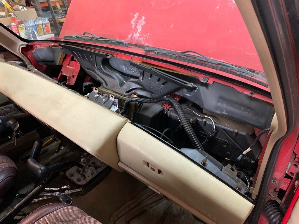

I've always seen everyone take the dash loose so it could be pulled back enough to pull the heater HVAC box out. Did you have to undo the dash so it could be maneuvered around?
Yes, we pulled the dash loose.

If you have not done it already.... Remove two bolts on column and drop it down. Loosen the side brace for the column or remove it. I usually remove it. Take the defrost vent out and remove the 4 I think it is bolts up top. There are two bolts on each side of the dash. Unplug and remove the fuse panel and all connectors and the whole dash comes right out. Of course it's been a few years since I did one.... I could have missed a few things..... :gee:
That just sounds way too easy...………
