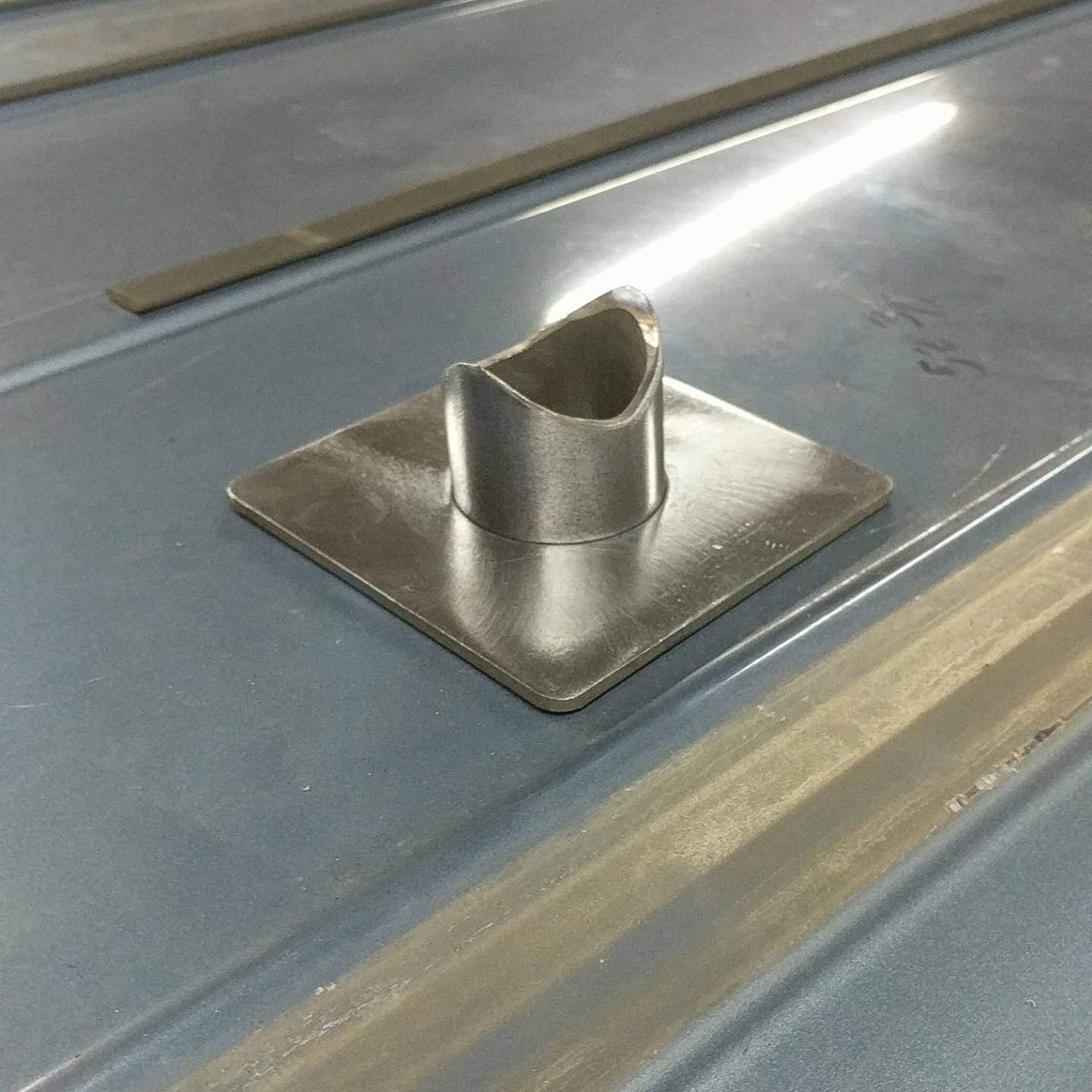

How did you seal around where to pillars go through the roof?

Yes everything was pre bent. And most was pre notched. But 99% of their notches i had to touch up. Without the X it would fold up in the event of a rollover. I just got in my PRP seats this past weekend so I'm in the process of installing them and have come across a few issues with the b pillars and the harness bar in my way. So the harness bar is getting cut out and a new one bent to make a little extra room and it will get ran for Winterfest.. Then I'm thinking the b pillars are going to get cut out and remade so i have more room up front.
But i had plates made for the roof that were welded around the tube and then sealed between the roof and plates.
