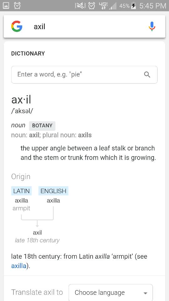

I feel a strong need to point out there is no such thing as an axil.
Still not a Jeep part, just something that tends to hit them when wheeling. LOL. It’s also a ring gear, not a crown wheel. All good though, we were able to figure it out.
I am grateful someone other than myself spoke up. My inner stickler had almost gnawed through its tongue.
Well you guys are upside down, so I guess I can forgive some brain scrambling. :D
