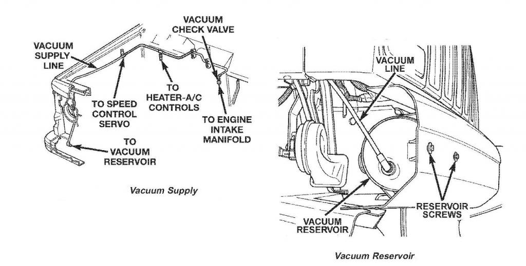

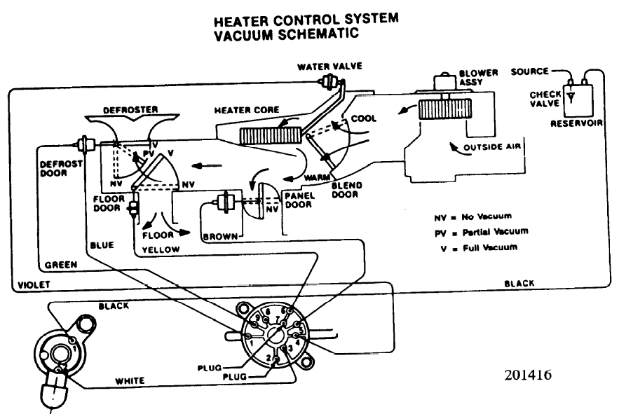

Anyone have an actual vacuum diagram from the firewall to dash? Am I missing something?

So if I'm looking at this correctly, at the firewall, the black one (I've got Black/White coming out the firewall) is the vacuum?
If that's still not fixing it do I have to hunt down all the vacuum lines in the dash?
Additionally, from the back of the heater control - the white vacuum line is just a small U loop that goes back into the manifold/plug for the back of the heater control which doesn't seem to look like anything in the diagrams
There are 2 plastic tubes going through the firewall.
Pinkish one comes OUT of the firewall from the heater control to the coolant valve in the engine bay.
Other one is the vacuum source for the heater control from the vacuum reservoir.

Here's a diagram of how I have it set up currently. I'm using the 6mm as the source, blocked off the other 6mm and am using the two 4mm as source for the rest. I am going to replace the vacuum line going to the TC because it's rotted out though that shouldn't be causing any of the HVAC issues (I don't believe)... (HC = heater control valve / TC = transfer case / CC = cruise)
