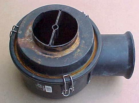

its kinda ricey but this is what i used http://cgi.ebay.com/ebaymotors/REAL-...ht_5351wt_1214
