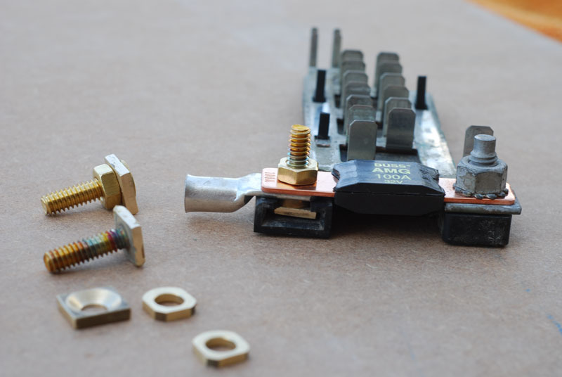

If you have an HO PDC you can add a fuse at the end of it.
Components, the way I did it:
Assembled:
Somewhere around here is a picture of everything in place, but I can't seem to find it at the moment.
