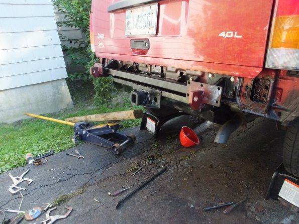

I ended up getting just a swing out from a friend on the forum and having a spindle and bracket fabbed at a local machine shop and then yet another friend from the forum helped me get the brackets welded on.

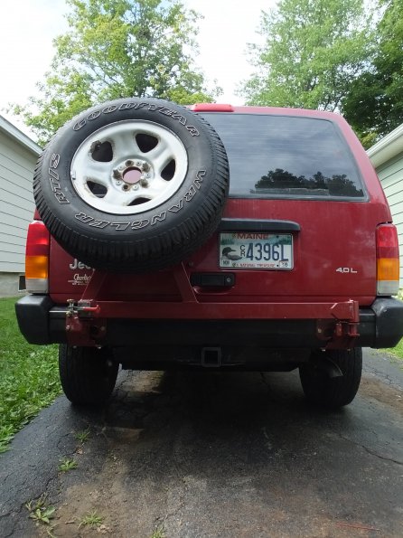

I have the JCR one and don't think it is worth the money. The new style pin and latch are nearly impossible to get set correctly where it neither rattles or is so tight you need a pry bar to open it. Right now I have it set to pry bar so I don't go insane from the rattle. I think the problem is that the carrier flexes too much so I plan on getting a piece of angle iron to run across the bottom and make a triangle instead of the upside down "v".
Everything else is great about it. I would definitely recommend getting it powder coated as it is hard to get everything painted on it.
I have the JCR also, one of the first ones of the new style. Zero problems with the latch, no rattling or its not hard to open. But I also have two tabs welded to the bumper & carrier so I can lock it (always feared the carrier would swing open while driving)
I like that tab idea. I got one of the first ones as well. When I first contacted them about the rattling they said that the pins are matched with the latches. I'm glad that you aren't having any problems. I will contact them again about the issue. To be fair, I really like it besides the rattle.

No, the only problem I have is every time I close the carrier I have to lift the carrier up or else it'll just smack the bumper and won't latch. JCR said it was the spindle and I can return it for a replacement, but I've been to lazy to take it apart, hasn't been to big of an issue to me. They're customer service has been great, though.
After getting with JCR again, they sent me a new latch and pin for my tire carrier. Took about 5 minutes to install and it is now easy to open and doesn't rattle. Now I am completely satisfied with my carrier.

I was also in touch with JCR over the weekend, I guess the jig was off for the first few bumpers, so they're building me a new bumper to fix the issue. Awesome to deal with
As the guy who owns this carrier/bumper now, its ratting again :D and driving me crazy.
I fixed it for about 30 minutes over the weekend by wrapping the pin in electrical tape. But after a short drive it was back to making a ton of noise.
Guess I'll reach out to JCR to see if they can send me a new latch and maybe a new pin too.
