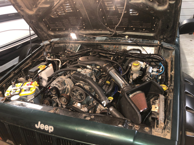

Exactly, I am coming to the end of the swap. I have had the 5.9 magnum swapped in for a while, but Just did the AX15 swap. If you have any questions on the swap let me know.
