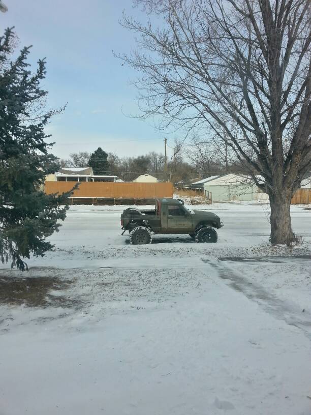

So an update, nothing really exciting has happened to this jeep. It does some things and drives down the road.
Anyways son specs:
1992 unitard
ax15
Long bed 2wd
Shortened from 119.6" to 108ish
Converted to 4x4
D30 with an arb that isnt hooked up
D44 with a lunch box
37" slicks
Wheel spacers
Doved rear with 2dr xj skins
Xj tail lights
And a few stickers to keep it togetjer.

And the photo suckage continues.........
What? Are you afraid to get close to it? :laugh:
And are those wheelie bars? Or shackles? :shhh:
man, that first one is like Dr. Who or something... head spinning.
The first picture mad me laugh too lol. That thing is pretty cool man! I have something similar planned for the back of my truck...I like what you did there

Did more things today, I think I have a total of one million inches of lift. But on the bright side, I have up travel and way less axle wrap.
Ditched my spaghetti noodle bastard packs and chevy shackles for some 3" what ever leaf packs and 1" lift shackles what ever XJ. Now I did run the factory mj shackles as pictured, but they were too short. And in classic personal fashion I didnt get any pictures of the final product....
