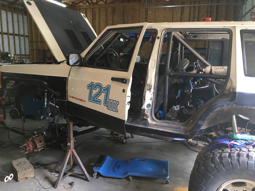

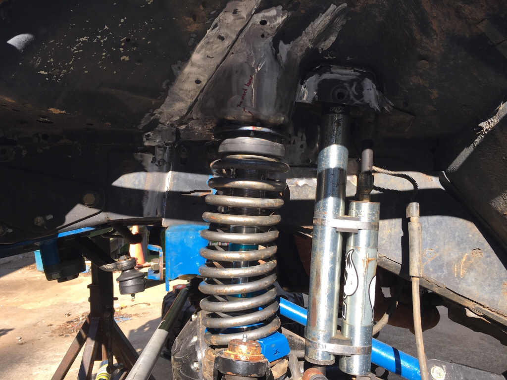

Originally Posted by Bent View Post
That jack stand on the drivers front makes me ascared.
I see what you're talking about but it's been adjusted since that was taken. They're not going anywhere.

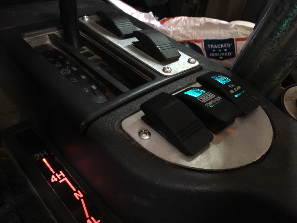

Got my switch panels from Dirtbound Offroad installed. I'm really satisfied with the clean look. Should of done this awhile ago.

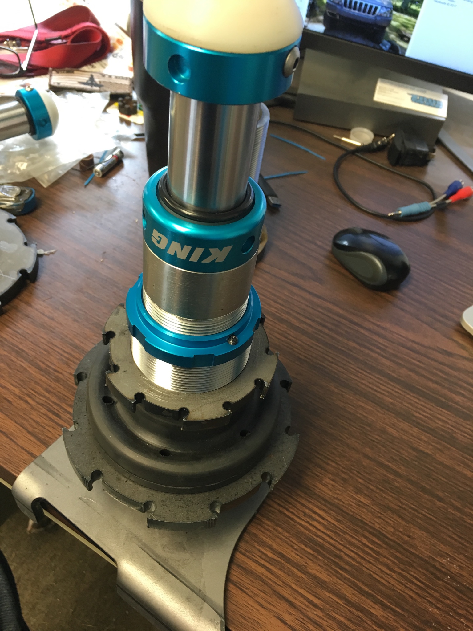

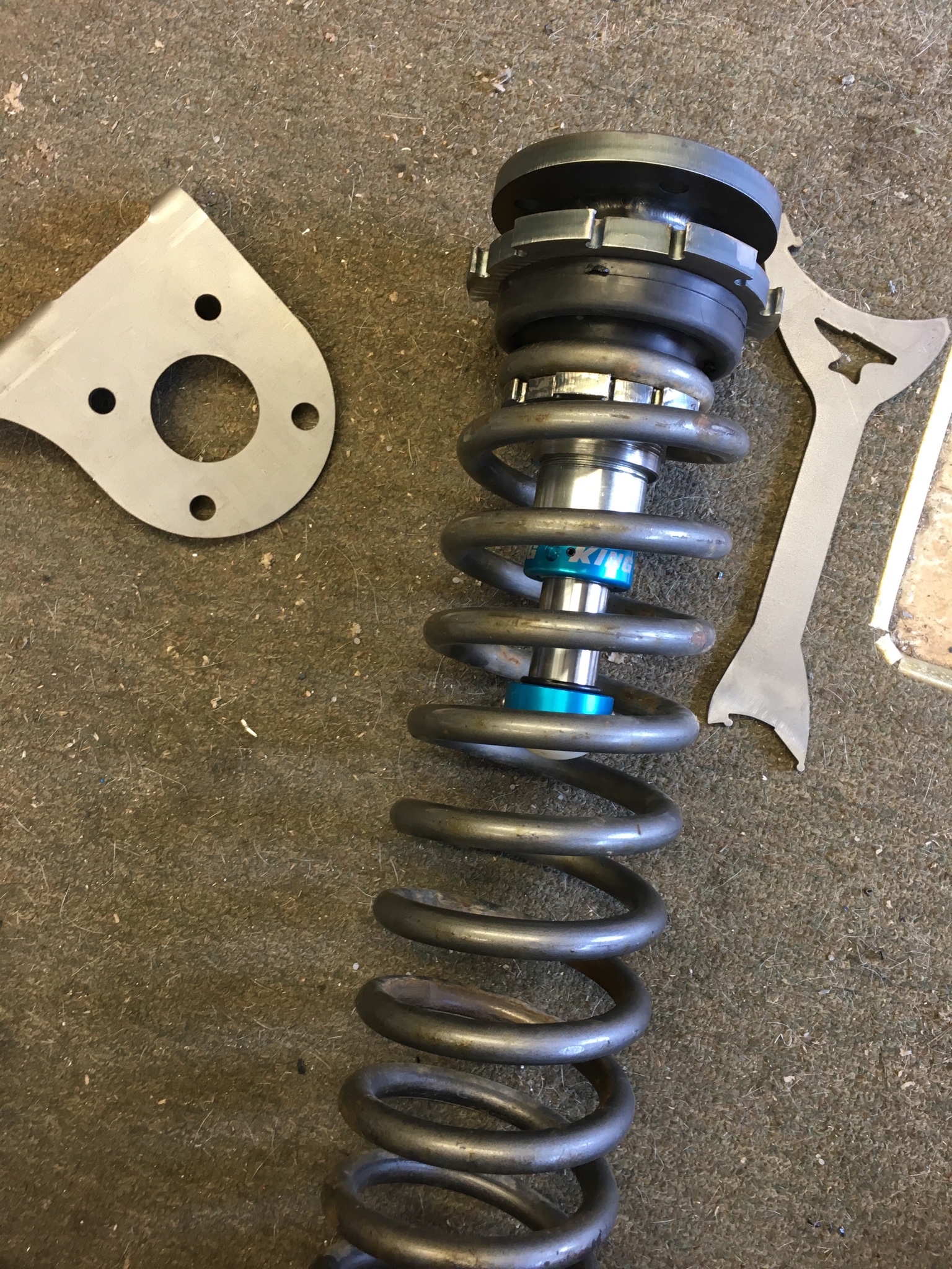

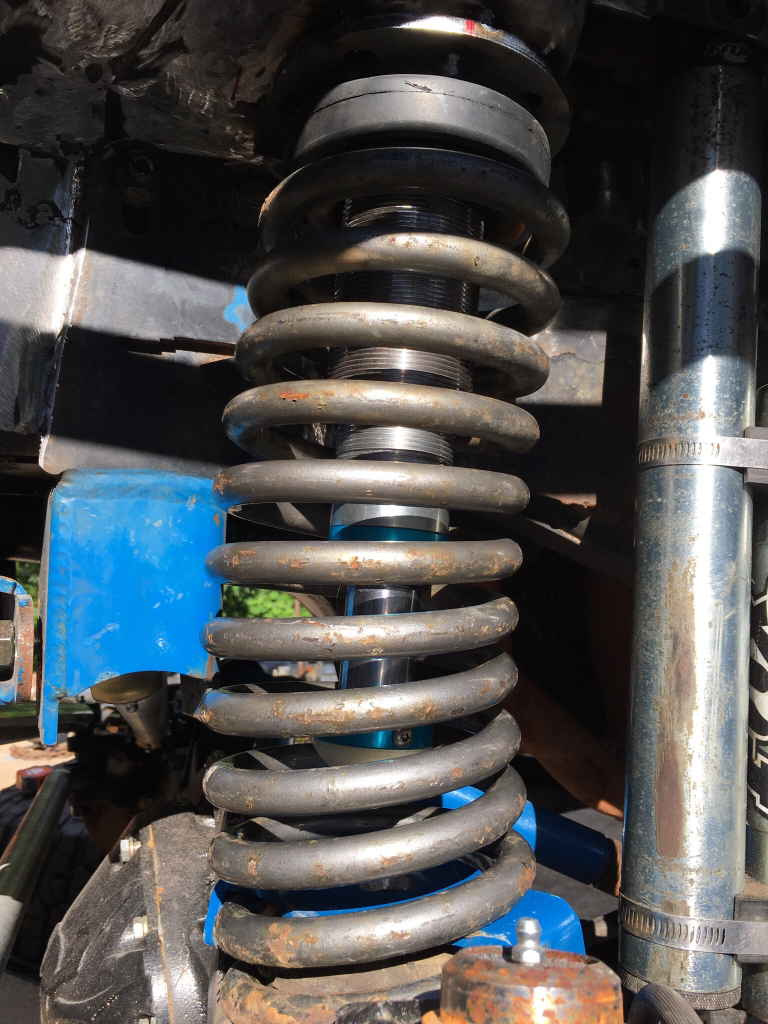

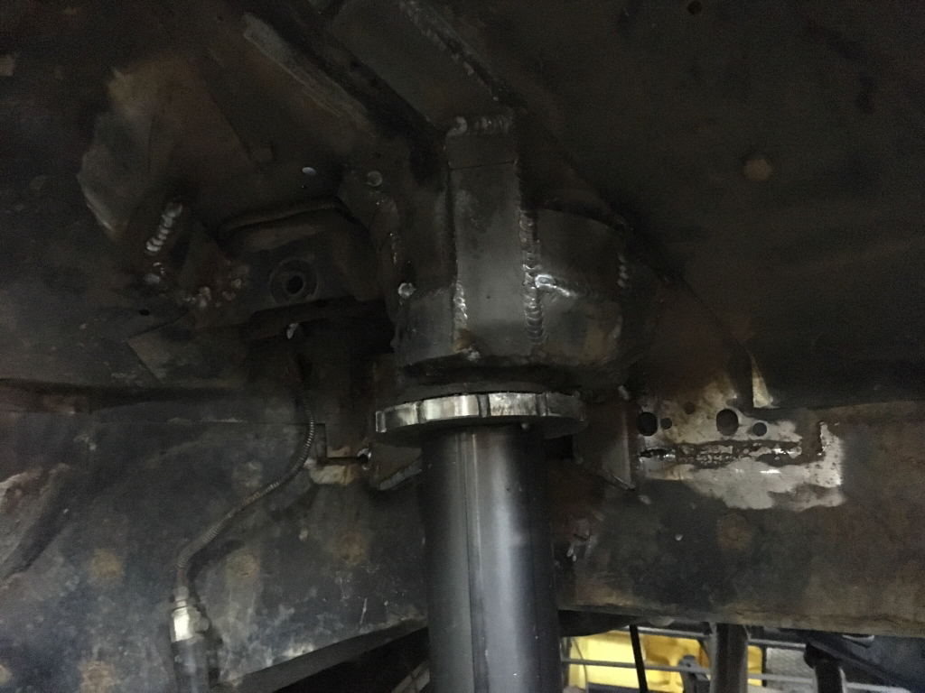

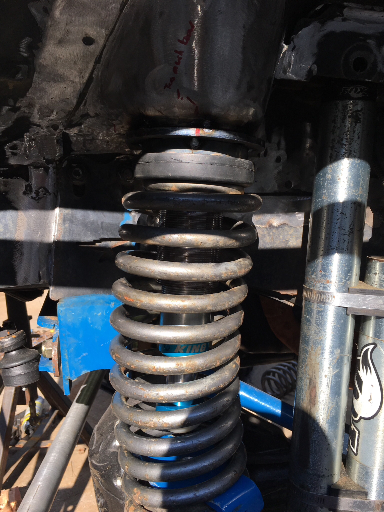

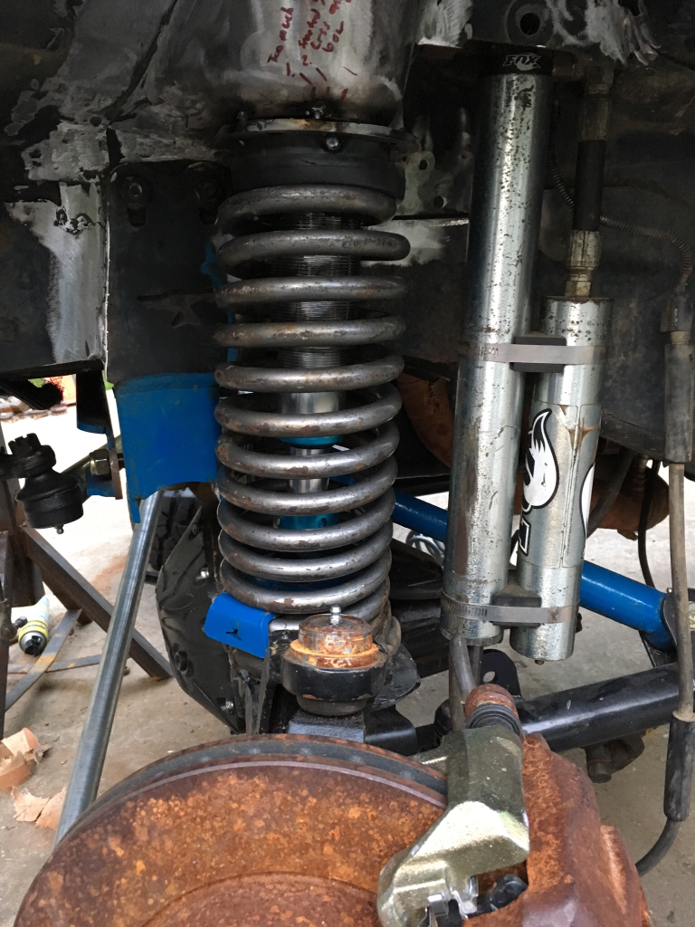

Got a little further on the front bumps. What you see here is the final version of how the bump is held and how the coil is retained. The bracket you see will be on the inside of the engine bay. We are running out of time to design a proper bracket to be laser cut out, so we're sorta making it up as we go with what we have.

Originally Posted by Ghost View Post
Shipped to 29550? Looks sexy!
Way too much lol. ~$1250 bumps included. I'd guess only super serious jeepspeed people would buy these, the rest would probably make their own if they were up to it.
I think I need to adjust fire on the picture sizes. I'm using tapatalk for the first time in forever and I guess full size is big?
Yea IDK the MJ needs these but it will need the ACOS.......
I hate taptalk.... just a little too big.
These bad larrys adjust your ride height too, if thats why you are wanting out of the ACOS. I think we could cut cost down on them if we found a way to run a regular bump, The King Air bumps alone make up half of the cost....
Yes I know. I was thinking sway away or anything cheaper than king.... I told a certain someone this but I doubt the mad man remembers........
lol King are the only ones that fully thread their bump. But a non threaded version with a set screw or whatever doesn't seem impossible.

Those bump stops are coming out sweet.
But yes, justifying that price tag to the Committee of Ways and Means is going to be tricky.
