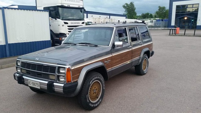

So, last week a rather sad looking XJ Wagoneer appears via my eBay email, poor pictures and poor description... my favourite !! and it was in the UK on Italian plates... what could go wrong my Corona diluted brain wondered.

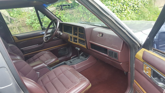

Interior is surprisingly good with just a tiny tear in the drivers seat, one of the rear door panels was partly off and it looked like some of the trim was missing, luckily I found it the back with the factory over mats. the only down side, and probably easily sorted is the saggy headlining looking like a Harem.

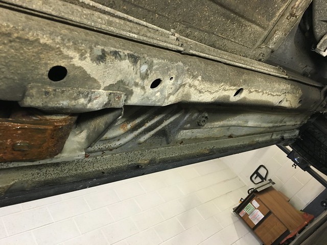

Floors and boot floor, like new, I suppose this was my biggest concern that I would be drawn into a load of welding, but apart from some surface corrosion, it is fresh as a daisy.

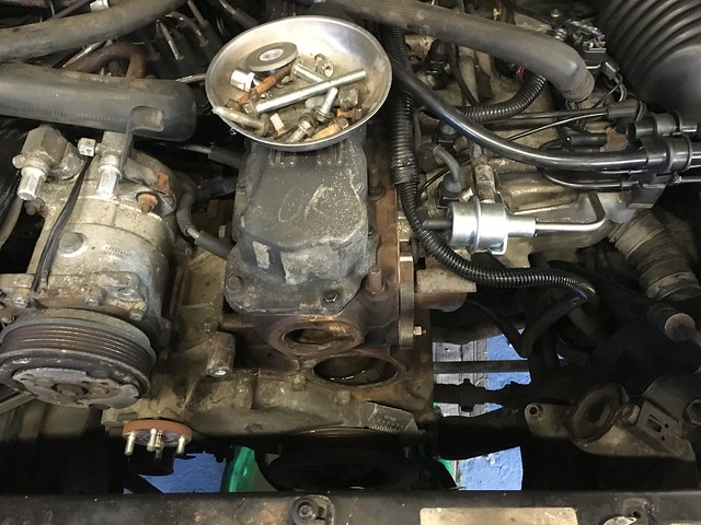

Work has begun, the blowing exhaust was down to a snapped manifold stud, unfortunately non of the stud was exposed and being the rear most stud, access for drilling out was limited, so I whipped the head off and left it for my local engineer to get it out (did not fancy snapping an Easy-Out and making the job worse).
De-pressurised the Bendix 9 and stripped that off now, sourced a regular booster/master cylinder set up.

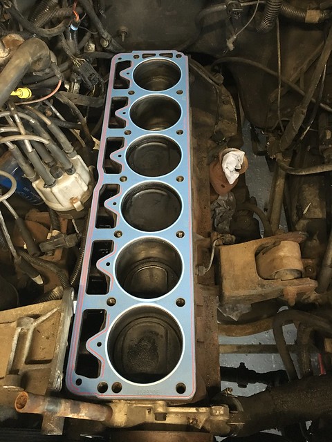

With the snapped manifold stud recessed in the head and not being able to get close I decided to whip the head off and get the local engine centre to do it and check if the head needing skimming.
I use a local guy, used to have race engines done by them and they do a great job without going daft on prices.
With the snapped stud out and a light skim it was time to start building up.

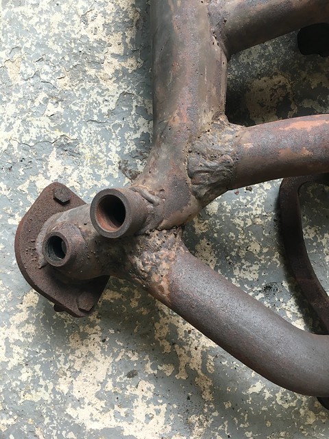

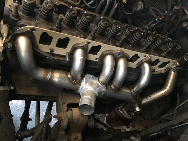

Apart from the blowing at the snapped stud, the manifold was blowing too, it looks like repeated welds over the years and new cracks were bound to occur.
I planned to order one from the USA with some other bits, then I found a guy in Germany with a NOS one kicking around, including shipping it was less than £100, so a no-braniner.

Great deal on the manifold. The pistons look nice and clean. You may have a real winner here.
A common problem on a vehicle that has set for a while is that the injectors dry out and don't work well. A can of good injector cleaner may help. Cracks in the manifold can also cause premature failure of the O2, but don't bother replacing until you get it all back together and running to see if you still have a problem.
Adding a flexible coupling between the header and the tailpipe will lessen the odds of the header cracking again if you plan to keep it a while.

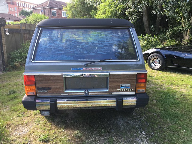

While idle I decided to look up the origin of the sticker on the tailgate
Turns out they are quite a big dealer of American cars, looking through the gallery on thier website I happen across this picture
Apart from it being the same colour, what also caught my eye was the roof mounted CB aerial. I decided to ping an email off to the dealers for s*&ts and giggles. Get a reply from the owner of the business saying it was the only one they sold in Grey with Burgundy interior, so it must be the same car. He is the guy far left, his brother next to him, the guy stood on the door sill is the new owner and the guy on the far right is that well known [sic] Italian Actor and Comedian Massimo Boldi.
Manhattan Jeep (the other badge on the tailgate) was their US supplier of Jeeps, so it looks like it went to Italy earlier than I thought.

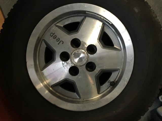

The 5 spoke wheels were stock on the Wagoneer, but mine has ended up with the lattice ones at some point, that said the spare wheel is still the 5 spoke

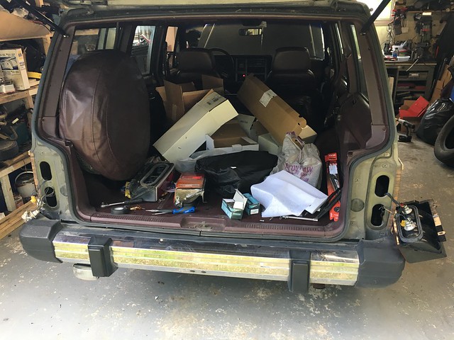

One of the Wagoneer specific rear lamps were smashed when I got the Jeep and the other has a small piece missing. As I needed amber turn signals anyway, I was going to use the early European spec ones, but the prices of new units is stupid and there were no good used ones at the time, so I ordered a pair of the US spec ones until I decide otherwise.
The lights conversion was a little untidy, so finished that off

Someone in the UK currently has a set of the correct style Wagoneer 5 spoke alloys from a Renegade, though at the moment the asking price is a bit too much for my pockets and I can't see them having much appeal on this side of the pond to anyone else.

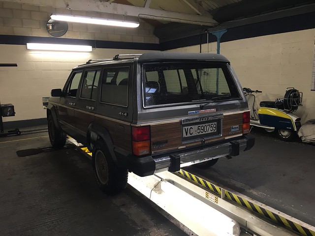

I am pretty much ready for its road worthiness test, "MOT" in the UK and taking it Friday afternoon, if it passes I can then apply to register it over here :clap:
Re: XJ Wagoneer in England

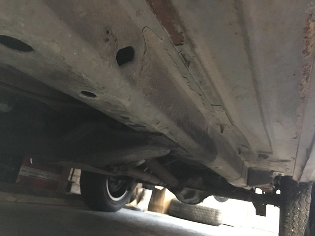

Friday I had the afternoon off to take the Wagoneer for its MOT.
Having a proper mooch underneath I was pleased with how solid it is

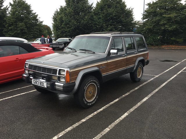

Those gold honeycomb wheels are awesome. I'd leave them on.
It was looking like I would not have a choice, the set I had seen on eBay actually sold for strong money and they needed a refurb.
I was mooching around eBay a few weeks later and spotted a XJ that was being sold complete but only good for parts, it had the correct 5 spoke wheels. I shot the seller a message to see if he would sell the wheels as I had neither the time or space to part out a car (it was a facelift diesel, so not much use to me).
He came back saying he would, they also need a refurb and missing some of the centre caps.
