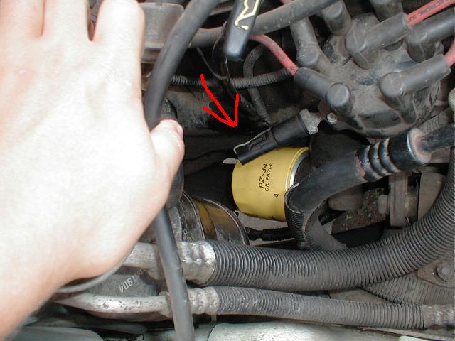

here is a pic. you can kinda see it is sagging a bit. the above pic from ADam J is the part that is sagging. this pic is the best i could get. it is pretty tight and at a weird angle in there. appreciate all the help

If it is not hitting or leaking, tighten it up and leave it. What brand of filter is that? And is it the correct size?
