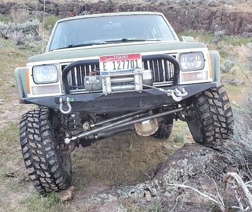

Heres my old set up . Over the axle track bar and also adjustable on frame side. I can't find pics of what frame side looked like then

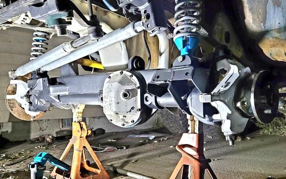

Next pics are current over the axle track. Frame/axle side is tunable. Track kissing oil pan at full stuff.
This steering doesn't flex steer hardly at all. The 1ton steering would steer pretty bad under articulation.
I really have no idea how a guy can get propper steering bolting stuff together.
My shit ive putt together cut apart so many times. Finally got smarter(not smart) and started building options into everything cause chances are if i have one bolt hole id wish for that 1" one way or the other.

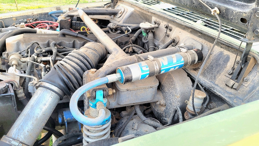

I stop the up travel based on the shock compressed length which will keep the trac bar about 3 inches from the oil pan. For the OEM JK draglink, I have sourced a right-hand drive JK link which will curve correctly when used OTK on a left-hand drive JK in my case XJ. I guess I could get more up travel if I extend the shock mounts lower.

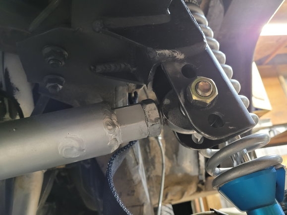

If I move the body side trackbar mount up 1 inch and at maximum height on the axel side will give me about 1/2-inch clearance above the diff cover. All my measurements were taken at my preferred bump stop position and at ride height.
