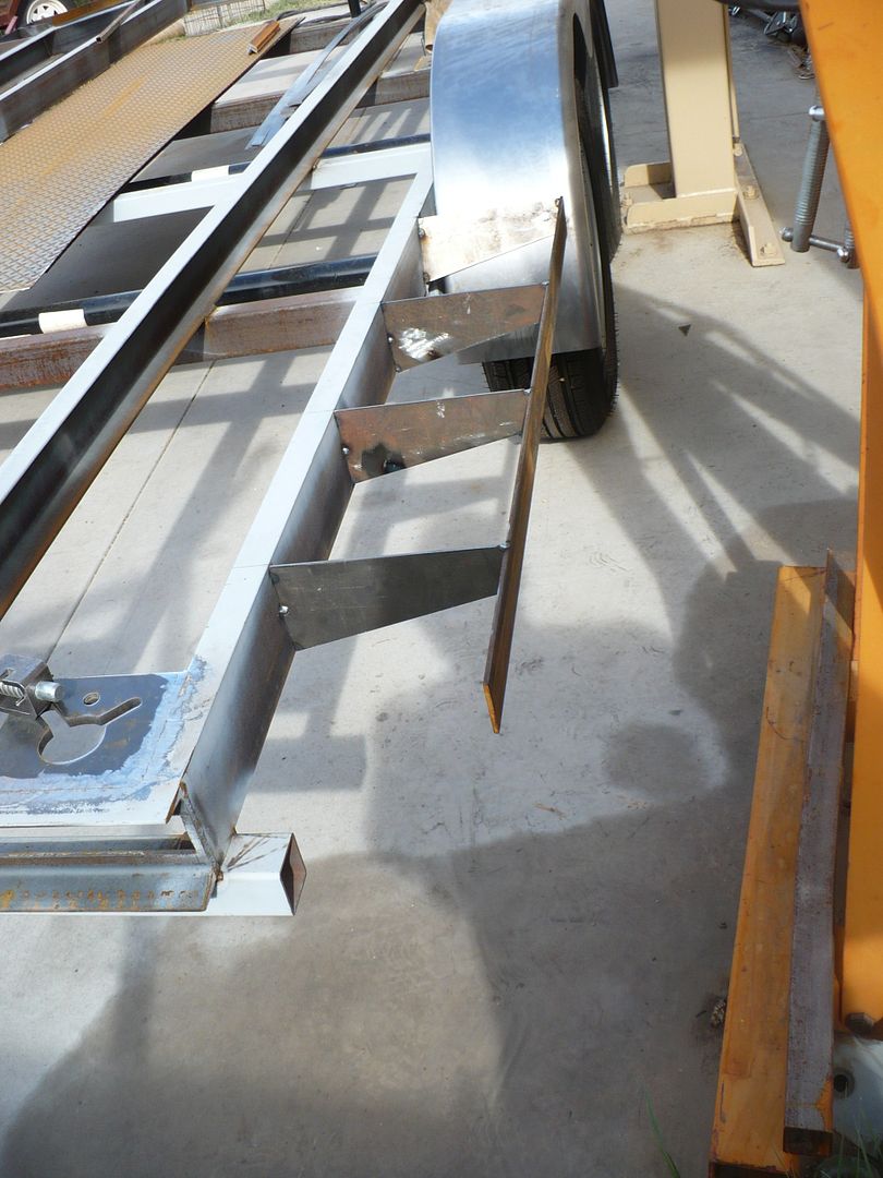

Maybe i missed it but are you going to put anything under the chain pockets to keep them from bending up?

Kickers off the Channel. I just got back from my fishing trip so it's time to get back on it!

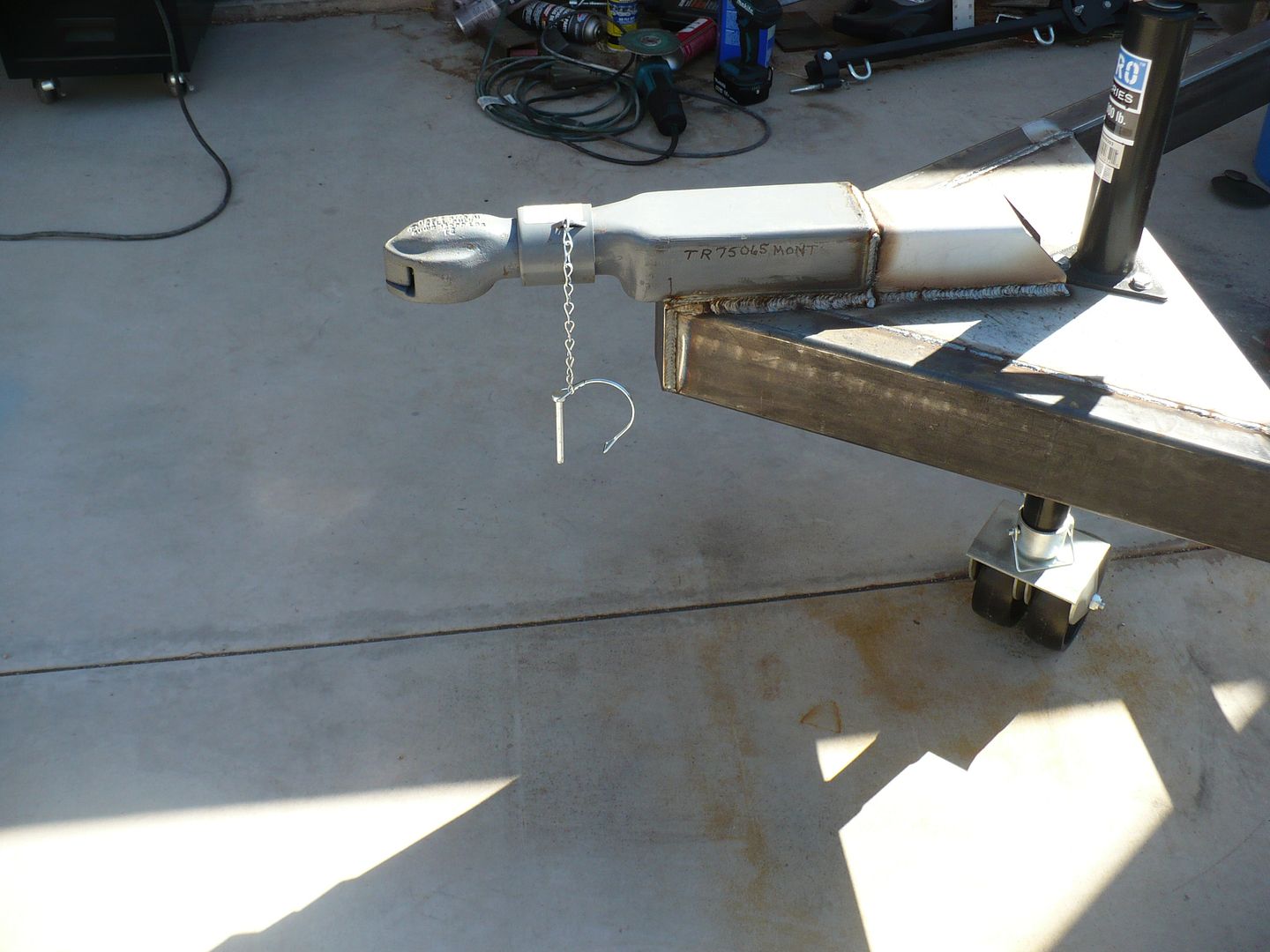

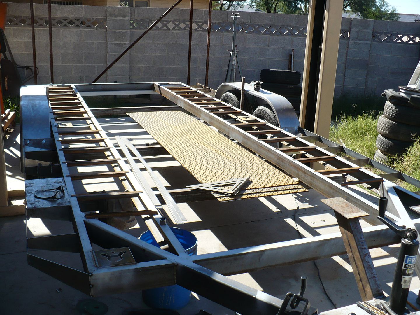

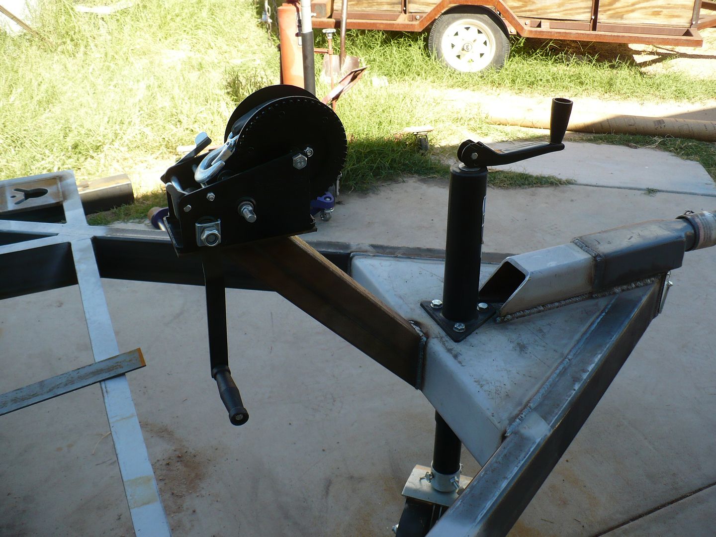

I got the tongue/hitch portion completed today. Since the 3"x3" weld was so close to the receiver weld I decided to make it a triple pass weld.
  #52
Old October 22nd, 2021, 10:51
RCP Phx RCP Phx is offline
Join Date: Mar 2003
Location: Phoenix,Az
Posts: 16,462
Re: Trailer mods

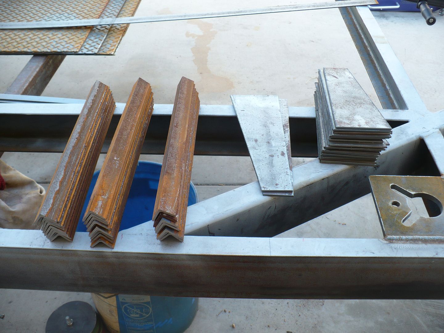

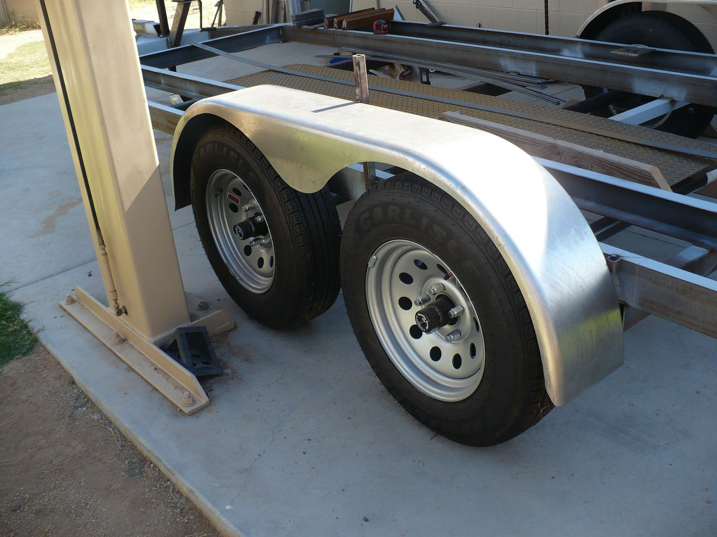

I've been busy this week cutting steel! I got the winch done and all the diamond plate supports cut along with most of the pieces for the ramps. Yesterday the (new) new fenders came in and the fit mocked up great! It's actually starting to look like a trailer.

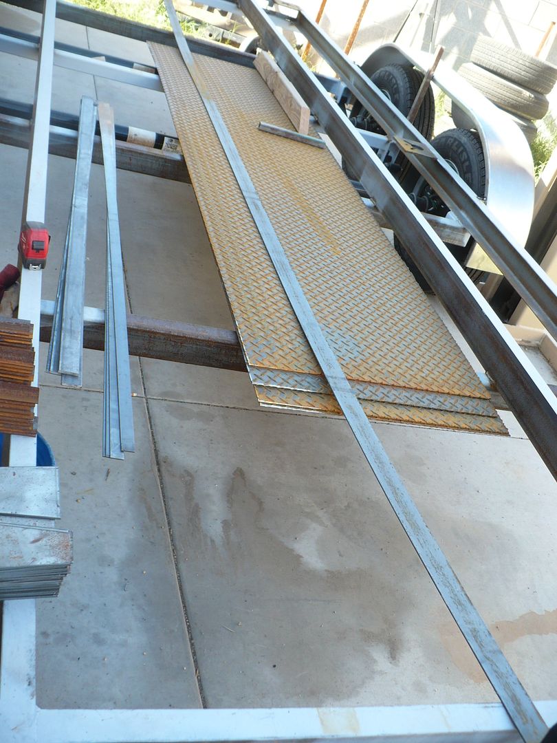

What seemed like a easy task (30 cross supports) has been a time consuming project since they equate to 180 precision cuts!

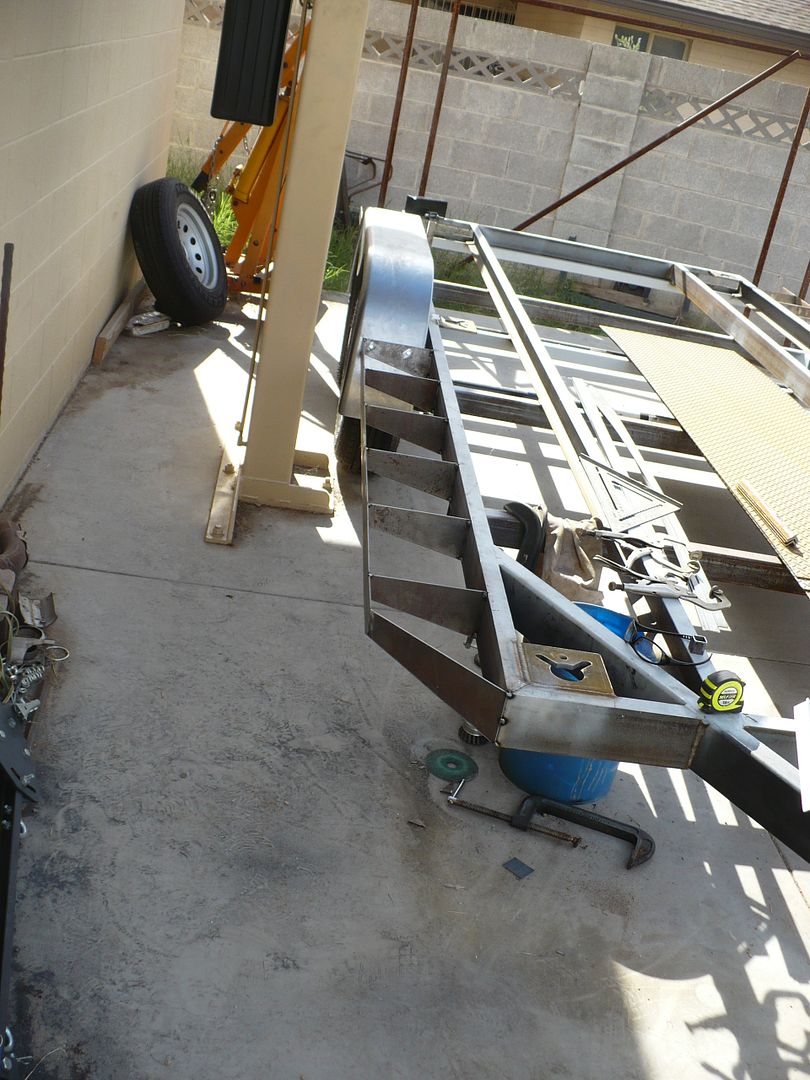

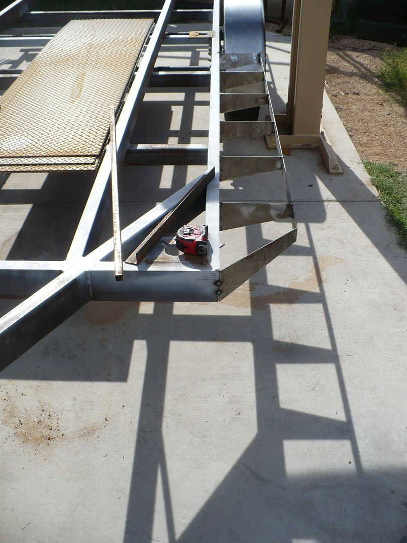

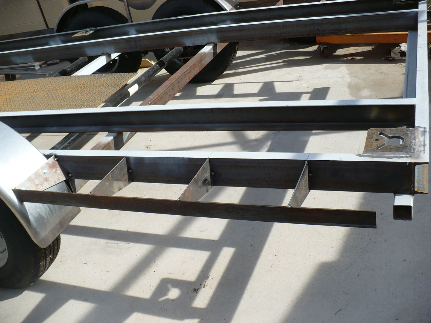

Today I took a break from the tedious cutting (inner supports) and started tacking together the outer supports/fender mounts. It's all a slow progress!

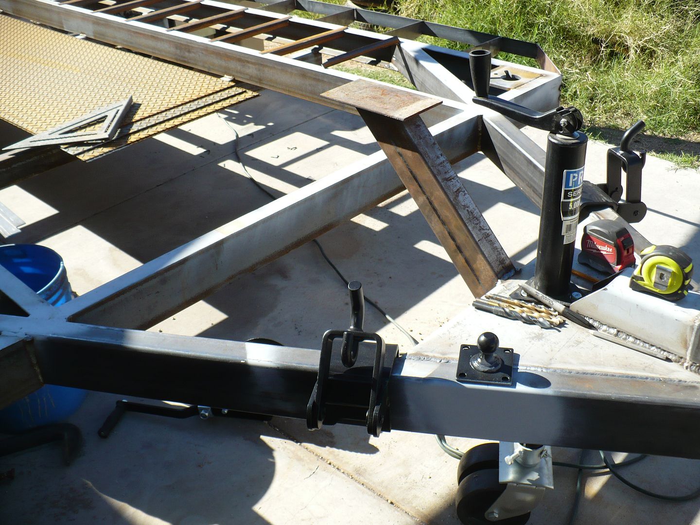

I finally got all the cross-braces cut, but before I can weld them (and the diamond plate) I need to get all my holes/tapped holes done before I lose good access. I also received my equalizer hitch mounts and sway bar mount.

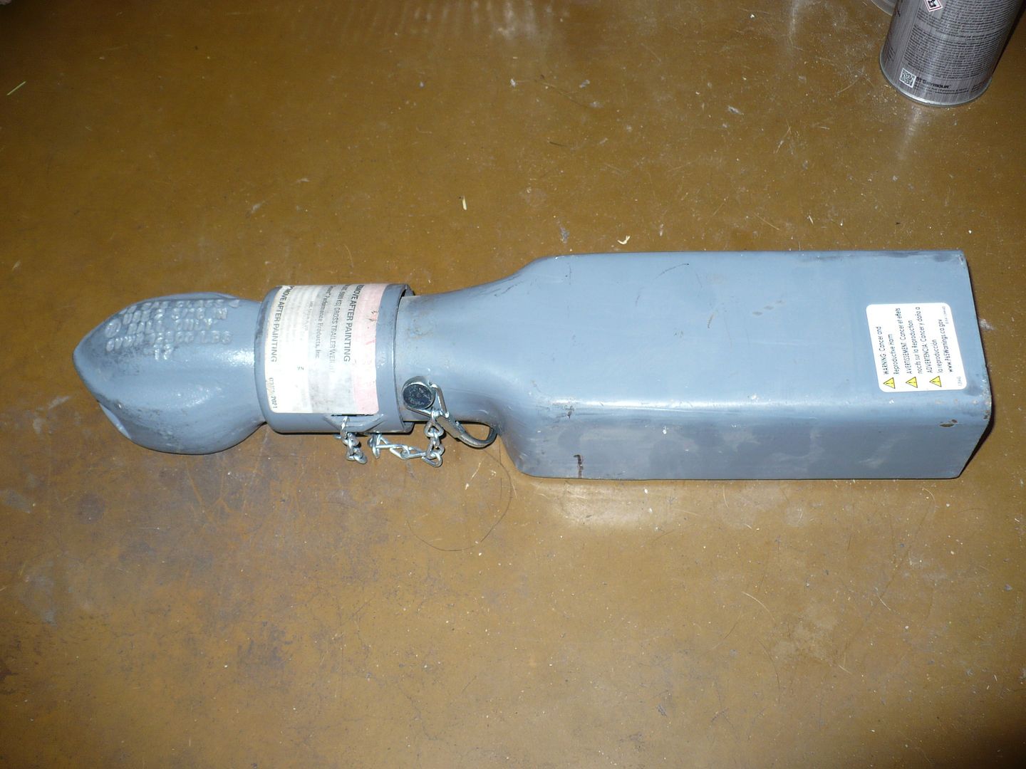

It's time to get back to work, I just received my Bulldog hitch (2-5/16" ball/12,5000 lb). I couldn't meet the 50* A-frame design so I went with the 3" straight coupler.
I'm curious if there's a reason you chose this style? I have one, and it's always a pita to operate. All my other trailers are the my common design....although I have no clue what either is called?

It's stronger and much more wear resistant than all the others!
I figured strength might be the reason, I noticed the high rating. Hadn't considered wear, my car trailer has about 40k miles on it in the last decade...maybe I better Check the tongue for wear, it has the other style.

It's probably not a issue for most but my sons shop does fleet maintenance so he see balls that totally wear thru the coupler! Today I have to get the safety chains figured out and ordered.

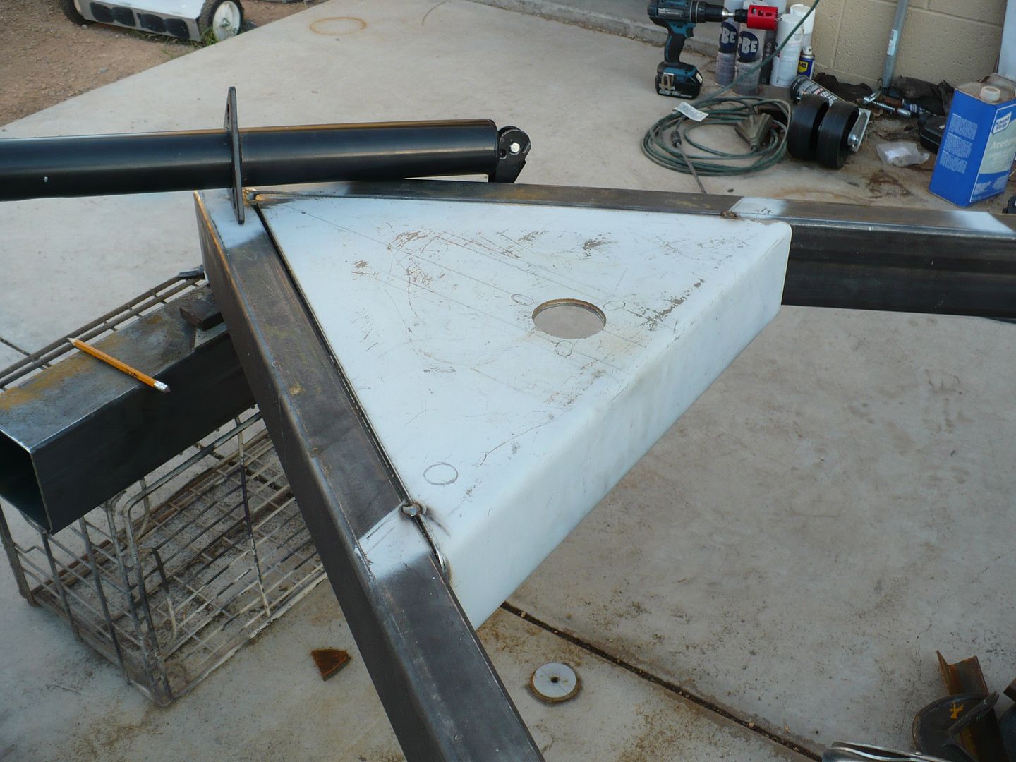

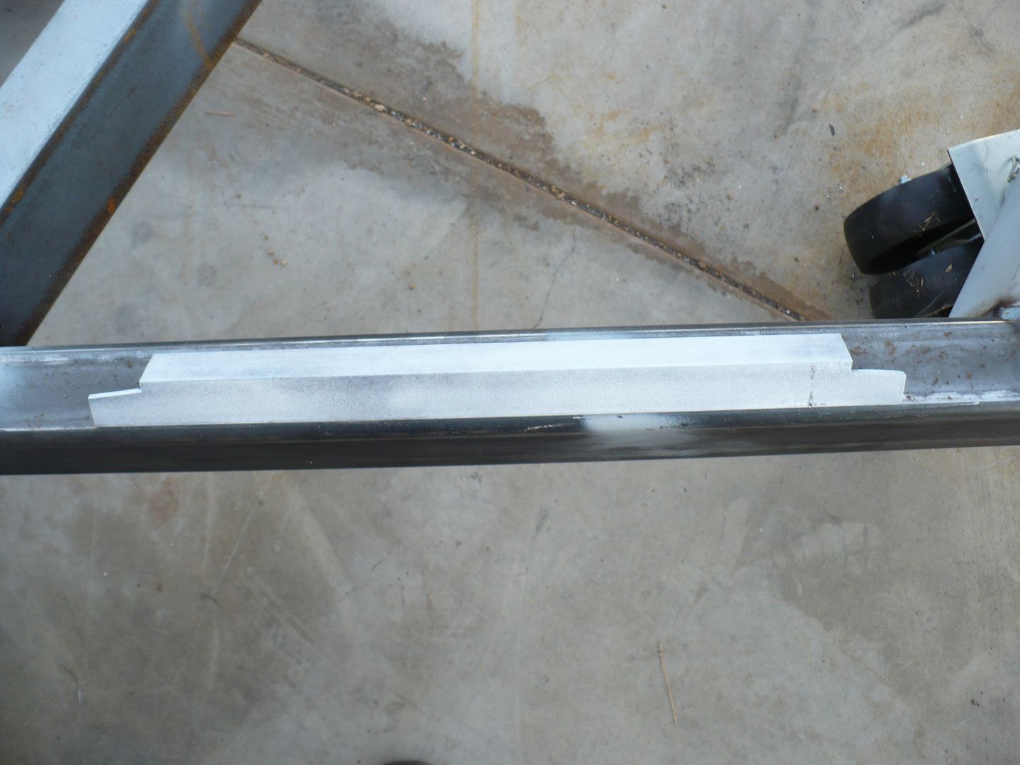

I have to finish up some welding from underneath plus painting so I needed to test it all out! I also mocked up my hitch.
