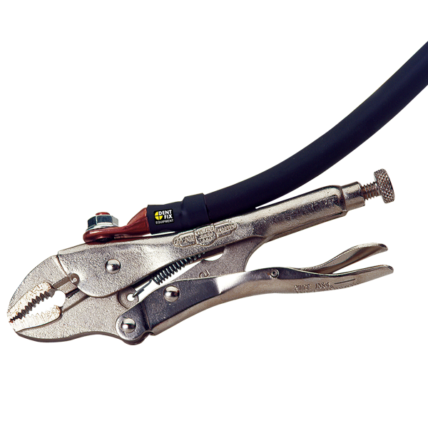

This doesn't answer your questions but since you mentioned a poor welding ground...I replaced my welding clamp years ago with this vice grip hack...works pretty good.
