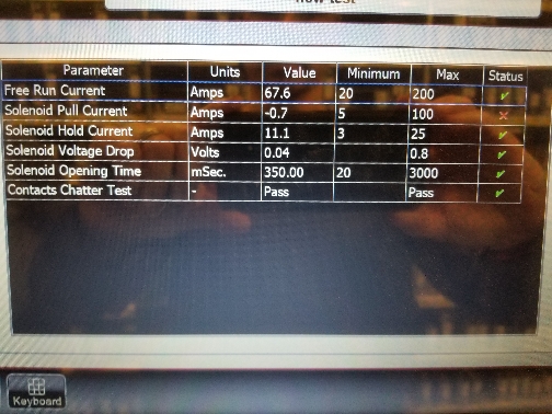

The real problem ended up being a bad starter. I didn't think to test the starter because it had been replaced only 3 months earlier. However, after cleaning the NSS, changing all the battery cables, testing all the grounds and replacing the 3 components of the ignition (switch, actuator pin and cylinder lock) I decided to remove the starter and take it to the auto parts store for a full test. Turns out it didn't have enough solenoid pull current amps. After replacing the bad refurb starter with a new one, everything started normally. All is good...for now.
