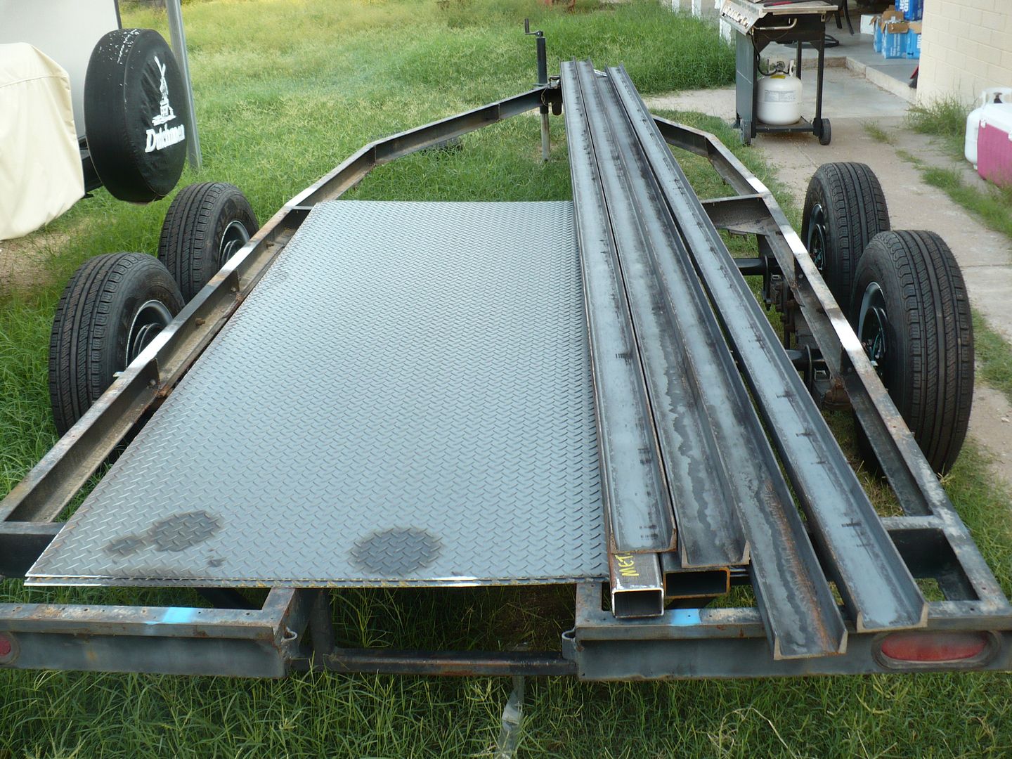

Just paid the invoice, not to bad at $1600 for 4pcs of 4" channel, 1 pc of 2x4x.188, 1 pc of 2x3x.120, and 2 sheets of 1/8" diamond plate.

I got a clue as to about how much the trailer will weigh, I'm not going to use it all (I needed the length) but the loading weight was 1041lbs.

I got lucky, they had the load already on a truck for delivery to the shop so I talked them into dropping at the house instead!

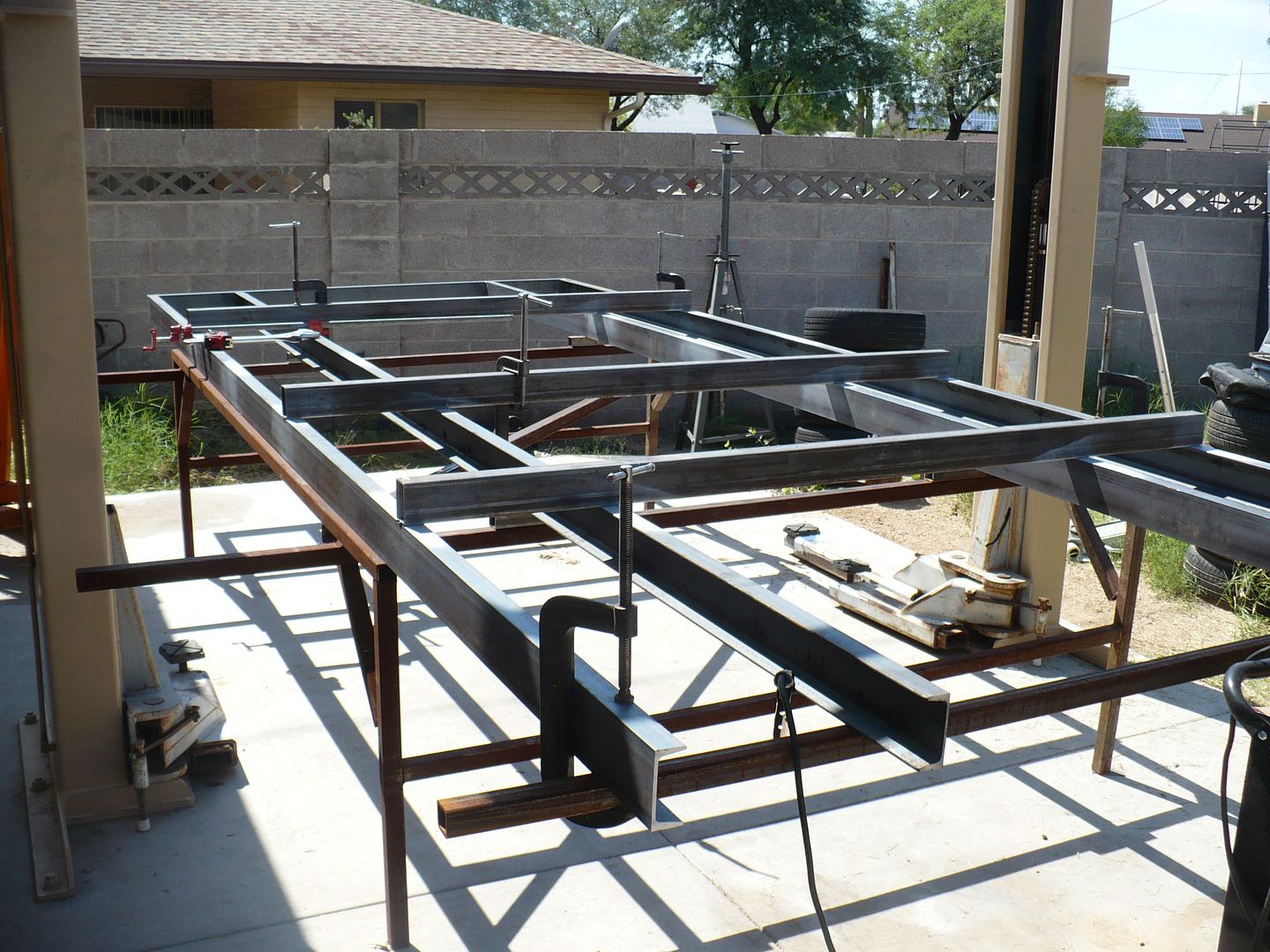

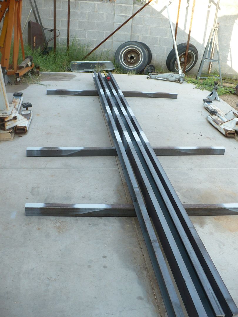

Like a lot of projects "it's 2 steps forward, and one step back". Sunday I cut the pieces that I could to get started with pre-priming (weldable) and some lay-out work based on what I had drawn up. I then realized that I hadn't accounted for wanting to move the axles forward 6", so back to the drawing board!

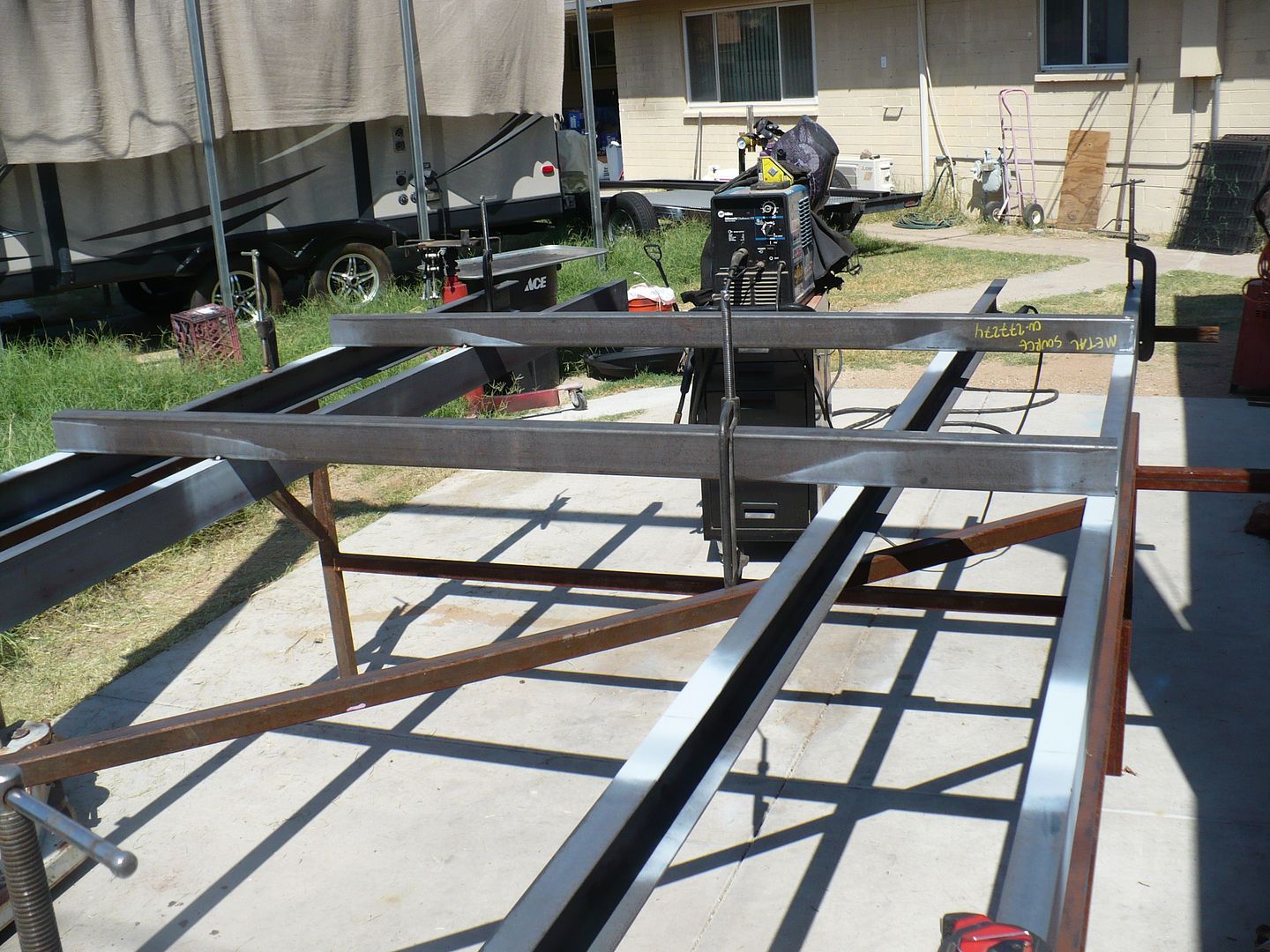

I've got material orders coming in everyday but I am getting going. Got the welding jig out and started tacking it all together.
