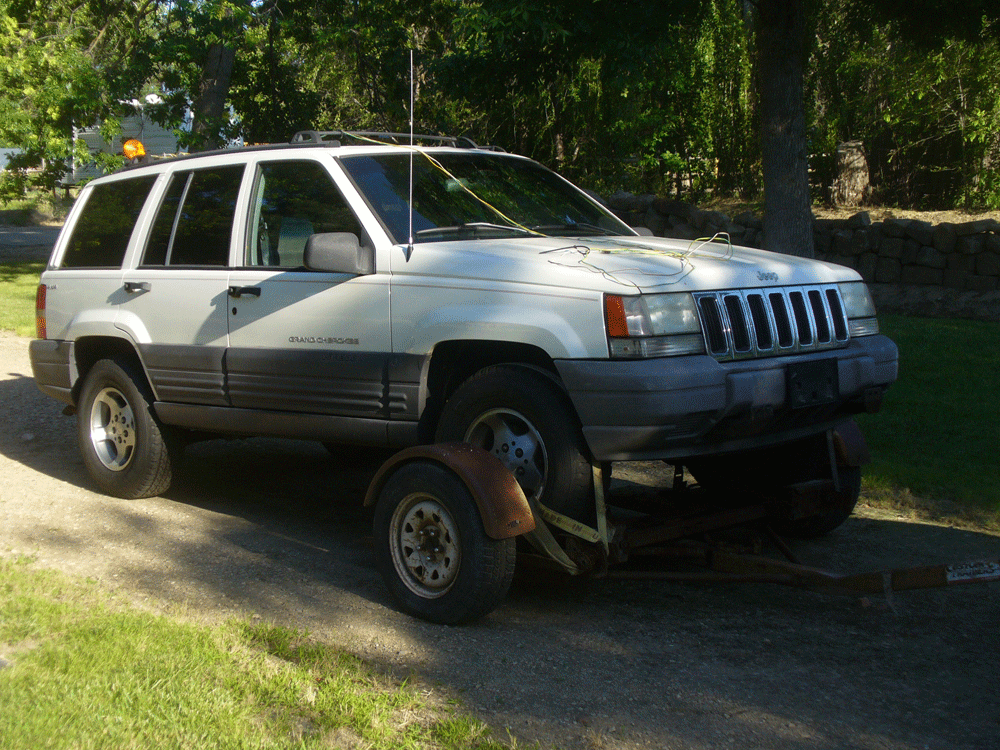

Here is the new toy as it came home:

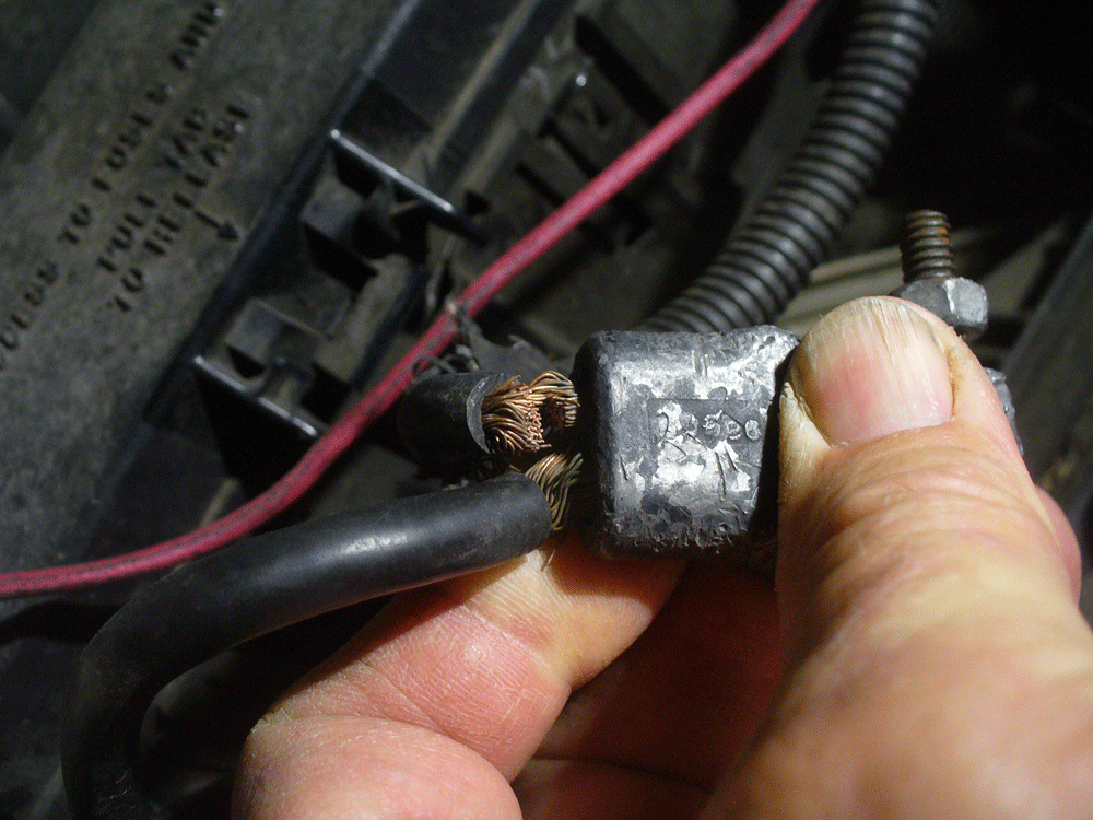

However, when perusing things at my leisure at home I noticed this little detail:
There isn't even half of that wire left to carry any current. And that is the wire that grounds to the engine block, hence the alternator. I have had experience with alternators not being properly grounded in the past. Powdercoating them has an impact on that detail. Took me a while to figure that one out. But this opens up a new and simple project for Varmints to learn. Lets fix these battery terminals.

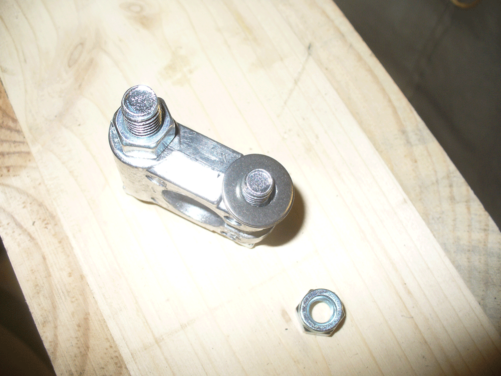

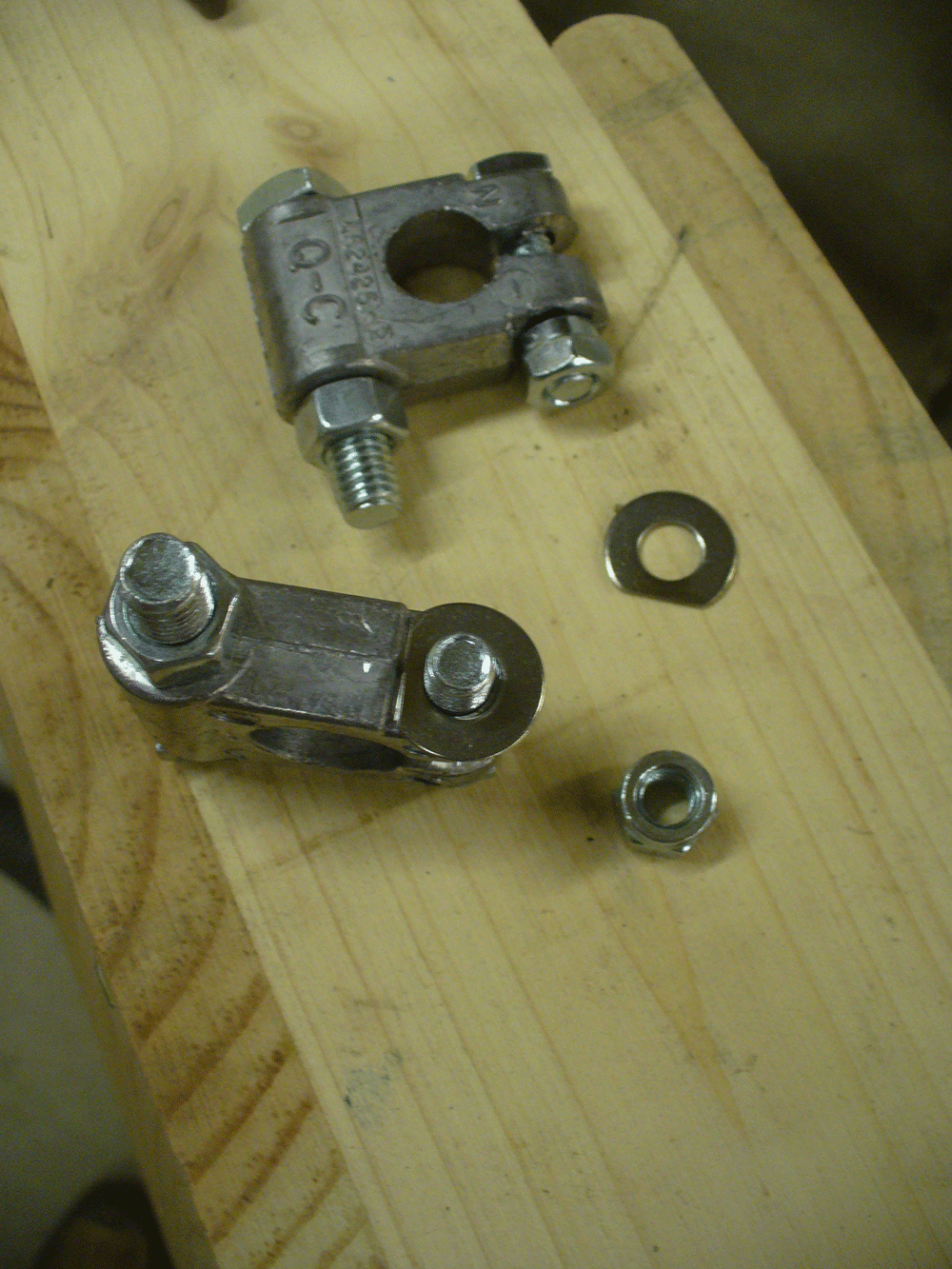

One thing I like to do on new terminals is add a washer to go under the nut. This helps prevent the nut from getting buried in the lead terminal. Problem is, a washer doesn't quite fit right:
That is easily solved with a trip to the belt sander:
(Note: Those are 5/16" stainless washers. Stainless is nice because they are thinner.)

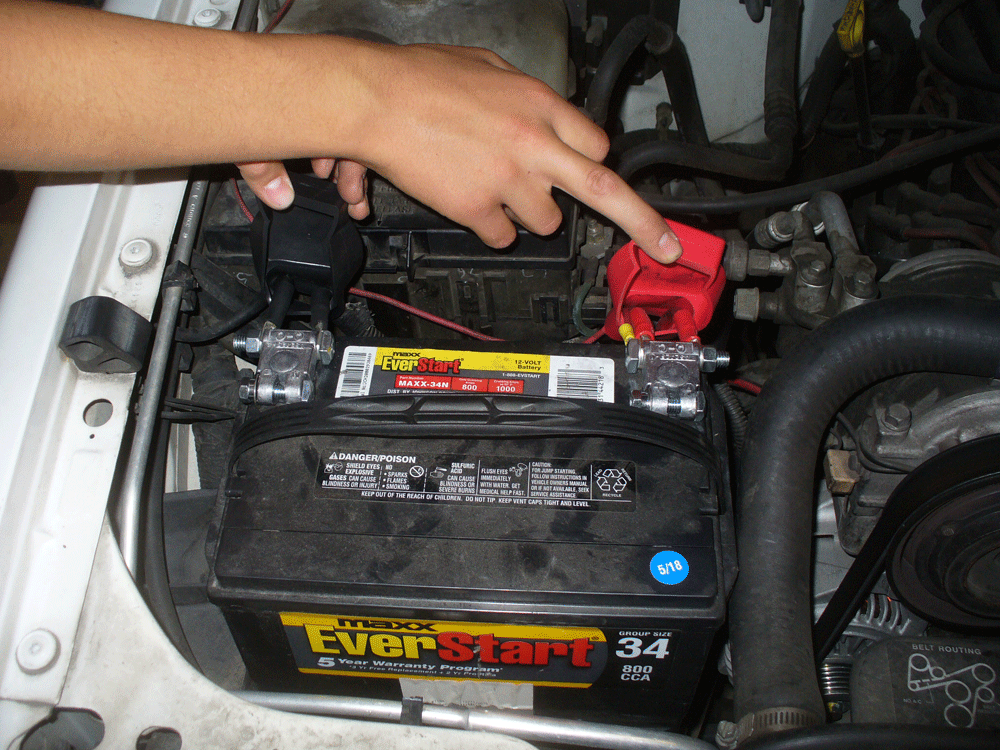

And this is how things look now:
I am not sure if that Varmint is trying to send me a message there or not...
At any rate, now when I start the Jeep the voltmeter immediately jumps up to a charging voltage and holds it. Hopefully this fixes the "needs a new battery" problem. Alternatively I am chasing an intermittent issue. Time will tell.
