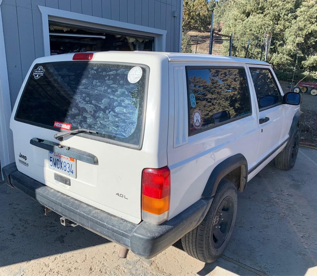

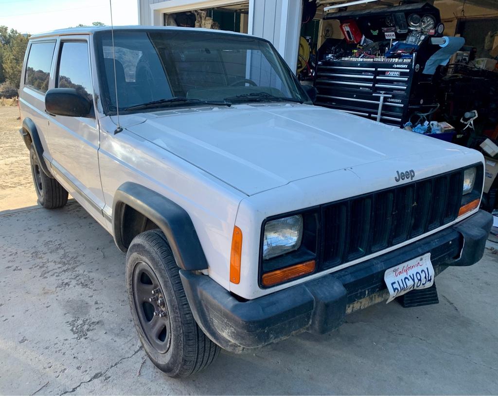

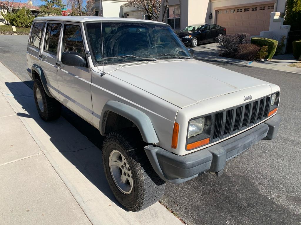

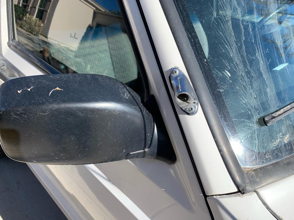

Here is my starting point. 97 two door 2wd auto with a blown head gasket and 150k miles. It had a tree fall on the cowl area so the a pillars need a little massaging. That will be done before the cage goes in.

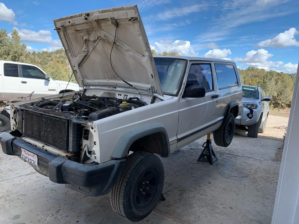

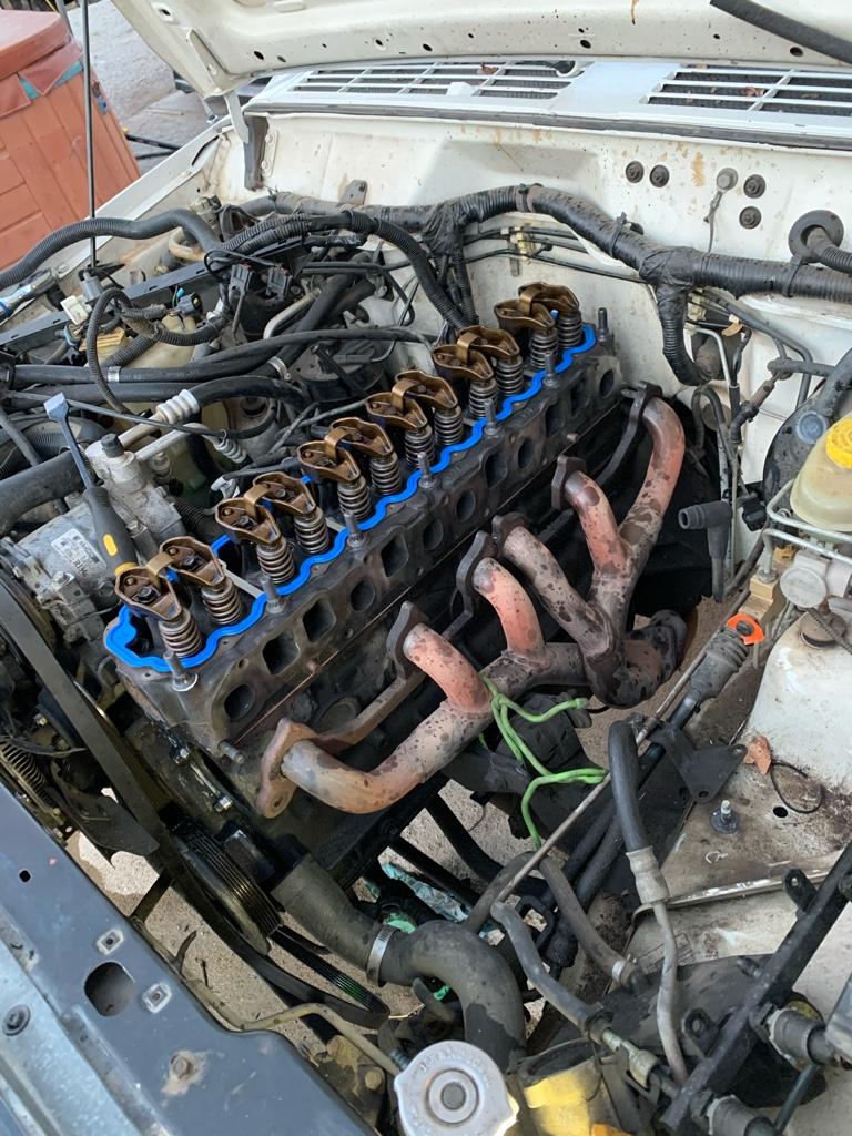

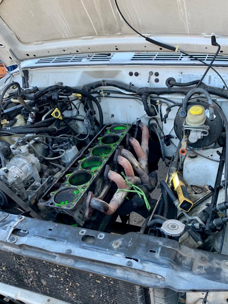

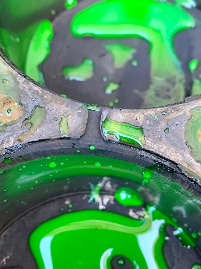

So today i dove in and found the problem with the head gasket. Found the culprit for sure. I did a mps felpro premium gasket when i threw it back together. New head-bolts and gaskets all around. Not sure if ill keep this motor in here but i want to get it running first and see how it runs.
Got it all sealed back up tonight. Gonna do the water pump and water neck in. The morning and fire it up tomorrow. Ill keep updating. If all goes well ill be welding in the stiffeners this week.
Got her back up and running. It runs like a champ. It has 191k on the clock. Definitely a keeper as far as the engine goes. It has quite a bit less valve train noise than my current rig. And the power steering is nice and quiet.

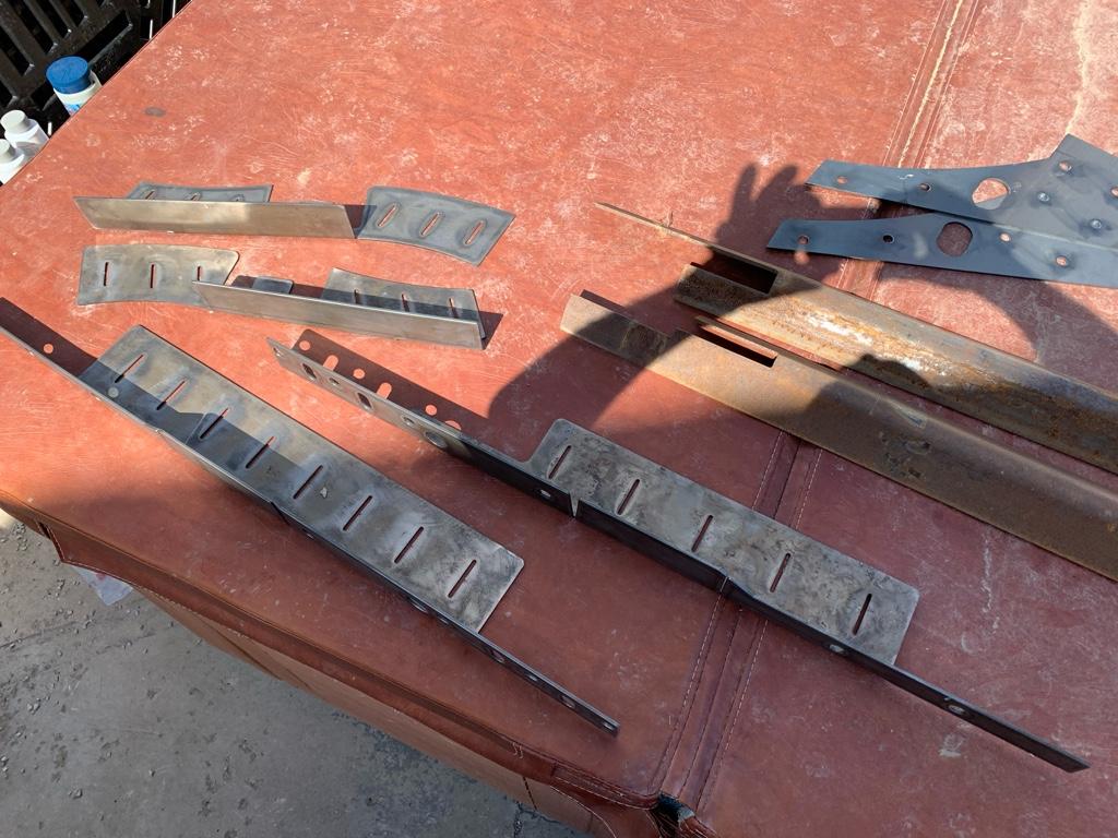

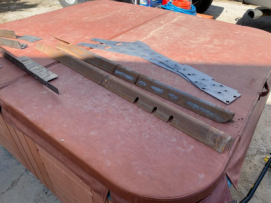

So here is my current stiffeners. I will be modifying them considerably. The middles are from tnt. I will be adding 1/2 nuts on the back side to add on belly skids and a traction bar mount for the rear axle.
Rears are a multi piece setup from dirtbound. I think next round of stiffeners for my camping ring will be a set from dirtbound. I really like this design but i already had the middle and front stiffeners.
Here are the fronts. I will be adding to these so they wrap around the bottom of the frame. These are an ebay special.

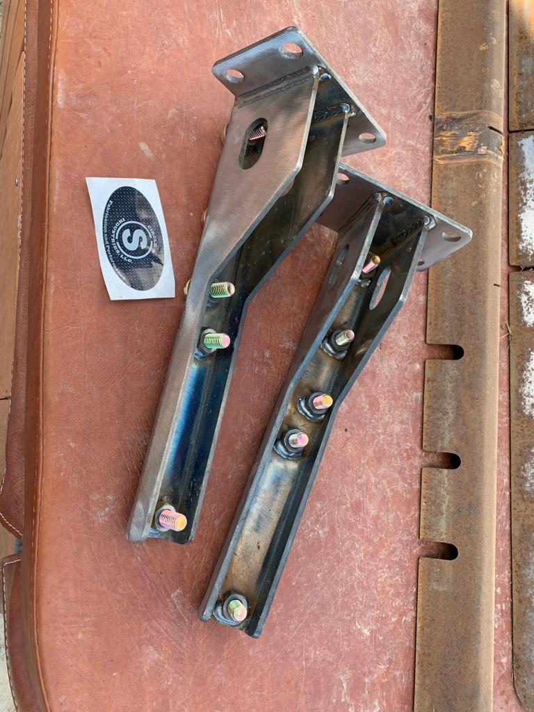

I also found these insane rear bumper tie in brackets. Delivered for $100. So beefy. I really like this style. I buckled my frame on my current rig right in front of the bumper mounts. So i wanted it to be a bit more robust this time around.

What brand are those bumper mounts. I've been searching for a good set but couldnt find any I liked.
I hate welding to these unibodies. But 1/6th completion today. Still need to do a small strip under the trac bar area to tie into the thicker layer underneath. Should go smoother on the passenger side tomorrow.
I run those bumper tie ins and really like them. Piece of mind when you have that. 25 plus unibody pls 10 gauge stiffiners plus a gas tank skid....
As a forwarning I did require longer bottom bolts with my setup.
At least these are a standard bolts i can get practically anywhere...
i will definitely not be worried with these tie ins. Ill have a skid and shackle boxes. There will be alot of beef in that area.
