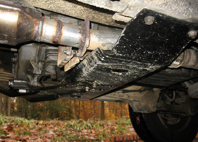

I replaced the stocker with a TNT HD crossmember and am pleased with it. I like it, it's much beefier, it gives at least an inch more clearance, and the stock transfer case skid pulls up tighter (that is a 242 in this pic)
OTOH I don't do boulder ballet like ktmracer so I would defer to his comment if you are going to play hard in the rocks
