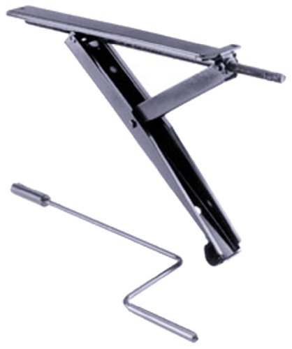

Progress will be slow with the near-zero free time I have but I bought some things. Got a harbor freight tongue jack and some rear stabilizers off amazon
https://www.amazon.com/gp/product/B000V9ATEW/ref=oh_aui_detailpage_o01_s01?ie=UTF8&psc=1
the tongue is angle iron so I have to pick a spot for the tongue jack and box it in for a good mounting spot. Still doing research on adding a water tank, and would still like to add a deep cycle, some lights, solar, and a water pump.
I have those stabilizers on my camper and they are only good for stabilizing. They aren’t good for leveling.
That should be fine, I just want to keep it from going nose-up when it's unhooked while I'm in it dragging something out
