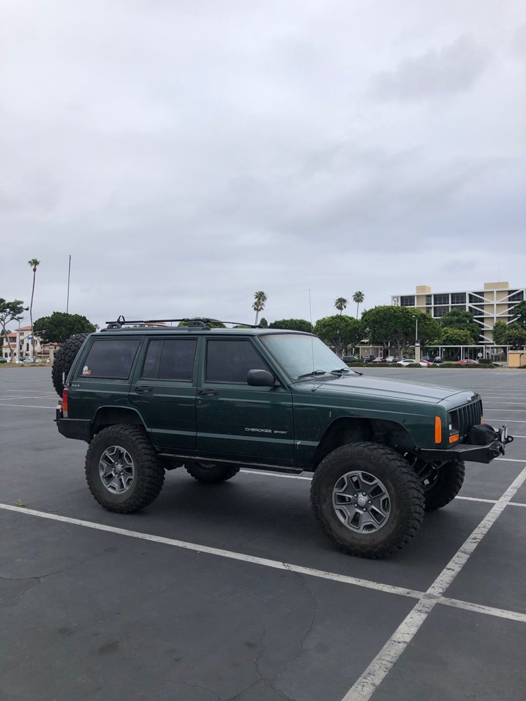

I have a midland 1001lwx that is wired directly to the battery.
I have my a firestik firefly mounted on the rockhard tire carrier antenna mount.
Using the K4R firestik mount, heavy duty spring. and a Wilson CB coax with fme connector and boot.
I cannot get my SWR below 2-2.3ish on channels 1 & 40. Went on a trail run and my transmits were received loud and clear, but I was getting terrible reception back. I could hardly hear the others and would loose reception in like 50 yards.
Wondering if I should just run the antenna on a tail light mount and if that would get me better reception or if i should drill a grounding mount on my tire carrier.
I made one out of 12gauge copper wire, but that did not help. Probably a little long and might need at least 10 gauge?

Basic antenna system theory is the that the antennae is 1/2 of system and the body of the Jeep is the other half of the system known as the ground plane. The higher up the antenna, the longer the antenna, the more centered in the overall mass of metal, the lower the SWR will likely be, and the better the CB signal transmit and receive will be.
Tire swings are about the worst place you can mount a CB antenna. Often they are isolated from the rest of the Jeep body by the latch and the pivot point leading to a lack of the second half of the system known as the ground plane. Depending on the location of the antenna, it may be blocked by the tailgate which reflects and absorbs some of the signals, raising the SWR and reducing the CB signal TX and RX.
Try the set-up you have now but without the spring installed. A 4 foot FireStik should be able to achieve and SWR of 1.8 or less on ch 1 and ch 40.
Sometimes a very large braided strap will help improve the connection of the tire swing to the rest of the Jeep body metal ( ground plane ) and lower the SWR somewhat.
