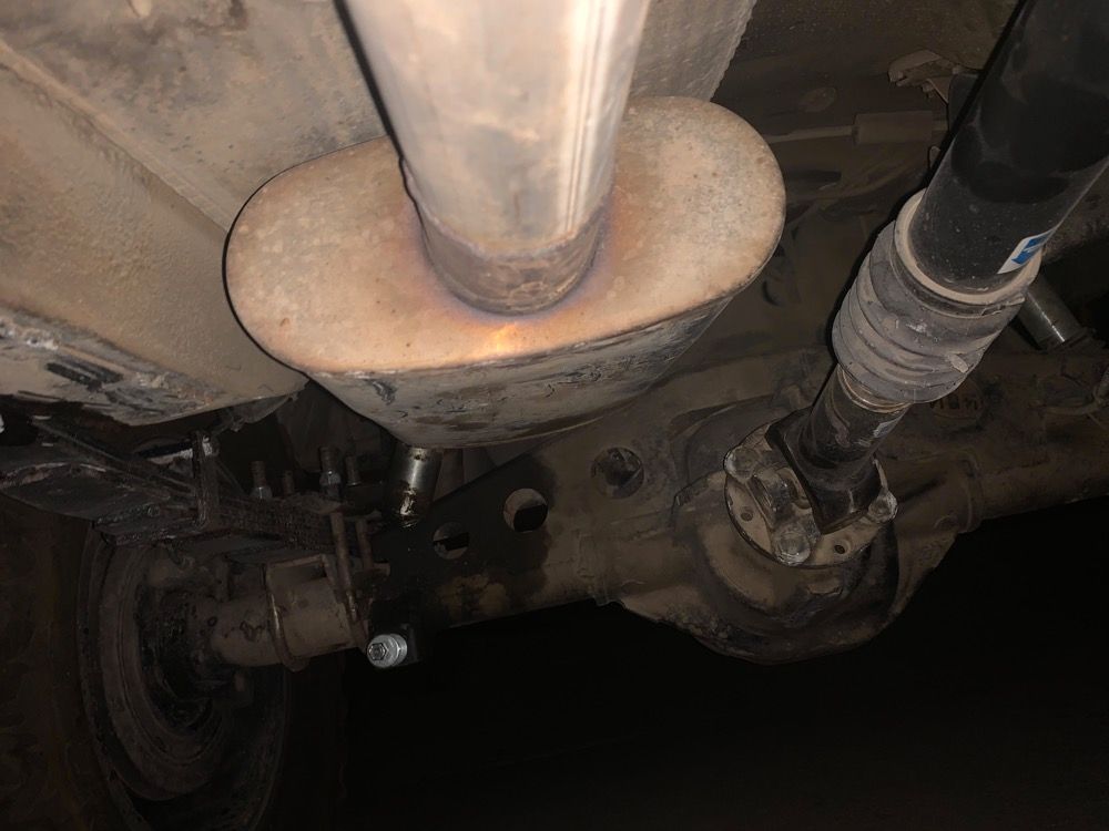

Very similar issue on my '94 but the TW driveshaft ended up being more of a problem. If the 8.8 pumpkin is your only issue, grinding off most of the flange on the side of the pumpkin, and using a shorter muffler, like a Borla ProXS, will give you enough room. I ran that for a while until the rubber boot on my TW driveshaft disintegrated from the heat. Now I'm running a MagnaFlow round-body (10425 I believe). Either way, you'll probably need to add a small extension since both are shorter than stock. Going with a center outlet rotates the turn-down at the back a little. I had to shorten mine and add a new turn-down due to my shackle location.

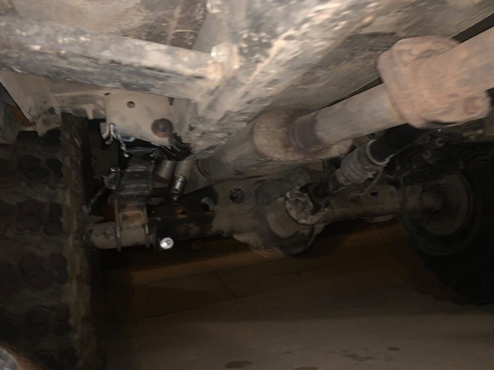

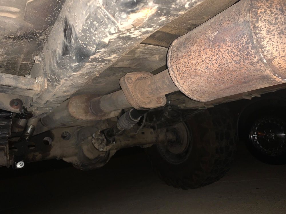

It's not hitting the axle housing just the driveshaft. I'm just looking to replace after the cats, after all the emissions. And correct there are two pre cats in the manifold and another after the bend over to the passenger side.

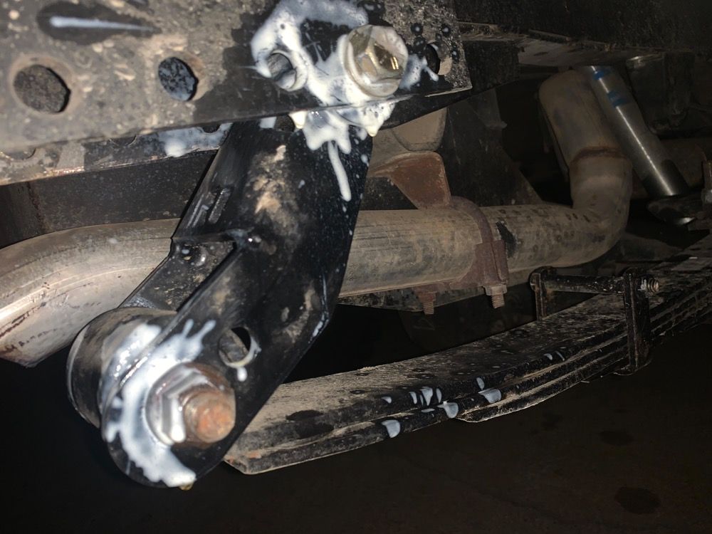

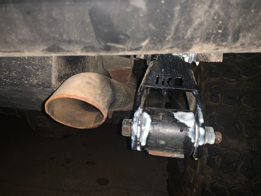

Yes it's old and falling off. When it was intact it still hit the muffler, I hammered a dent in it to alleviate that problem. Just seeing what exhaust systems people were running and hopefully get some pics installed with a 8.8

I have seen this issue before even in older body Jeeps (i.e. 96). On the 8.8 the pumpkin is skewed to the passenger side towards the muffler. A "less wide" muffler than stock/stock shape will help.
