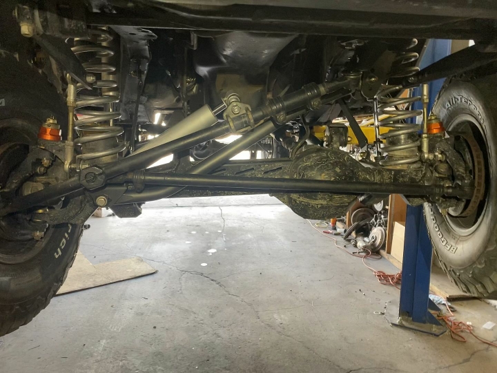

I have a 97” XJ with a custom long arm setup I built. I stretched the front end out 1-1/4”. My front driveshaft now looks too short. What raises the concern is that my front end seems to be binding up somewhere and will not fully drop out. My arms are a radius arm style setup. I have checked Everything! Trackbar is not binding either is the sway bar.. I have 10.6” fox shocks and with the straps off it will only droop out to 9” on my shocks. LCA’s are not hitting anything either as they do with short arms. Any thoughts?

So I looked at pictures. To me it looks like its hanging on limiting straps.
9" of extension is alot considering you say you have 11 " shocks. 2" of up travel?
Yes after looking at the photos both your steering and track bar could be redone. But looks like you have plenty of suspension travel.
I'd do steering and track bar because what pictured is stock junk

I have switched to crossover steering with no stabilizer and it’s still binding but not on the pitman arm heim or any steering components. Trackbar is custom 1-1/2” x .188” wall with a stinky fab stock replacement bracket which is not “stock junk”. Jonny joints on both ends. Most Jeepspeeds have 10-12” of travel so I’m looking to fully droop my 10.6” shocks. I don’t think that is too greedy. I have poly bushings (2-5/8”) on the unibody side and 1-1/4” heims on the axle end. Surprisingly, the Jeep is very stable and steers well despite the improper angle on the trackbar/drag link. I know it has a little bump steer but it’s hardly noticeable. I will definitely be doing an OTA trackbar setup to realign them properly. I just don’t want to waste time/$$$ if it won’t give me more droop because I can live with a little bumpsteer given my prerunning speeds with a 10” travel Jeep. I’m thinking of using the SFR OTA trackbar bracket and to make my own trackbar. Thanks for the replies. Much appreciated
Also, it is hanging on the straps in the pix. I need longer ones now that I have crossover steering. The Currie TRE at the pitman arm was binding. Hence nice the straps. The Currie setup only permitted about 8.5” of shock travel

Is this your current set up?
You want us to tell you what’s binding with photos of parts that aren’t installed anymore?

With the drive shaft, shocks, and limit straps removed, you should be able to droop the suspension enough to pull the coils out. Really there are I only a few things that can limit droop at this point... steering binding, trackbar hitting the factory axle mount, brake lines, or control arms hitting the factory axle mount.
Pictured looks like drag link joint on the pitman arm might be at its max misalignment but I can't tell it has the rubber boot hiding it.
