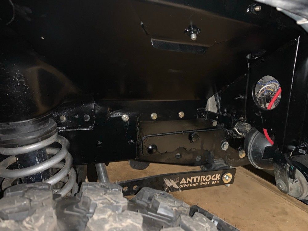

I have pretty much everything wrapped up. Once I get my cowl intake, I just have to get it installed and I will be done, and then off on my Rubicon trip!
Here are some more pics of the new inner fender config
Drivers side inner fender- I am just using a temporary cone filter. With the limited space you have to go with a cold air intake (which with the new config doesn't look like it would get much cold air) or a cowl intake. I am going to be installing a THOR cowl intake.
Limited space for an air intake on the drivers side. -
Passenger Side -
Inner fender clearance on the drivers side after the modification -Lots of room for my 37's!
Clearance on the passenger side
