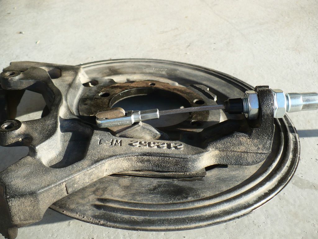

KJ is your disc brake answer, direct fit.

ok e cables too?

I can't answer that, I used the correct length cables from M.O.R.E. on mine.
