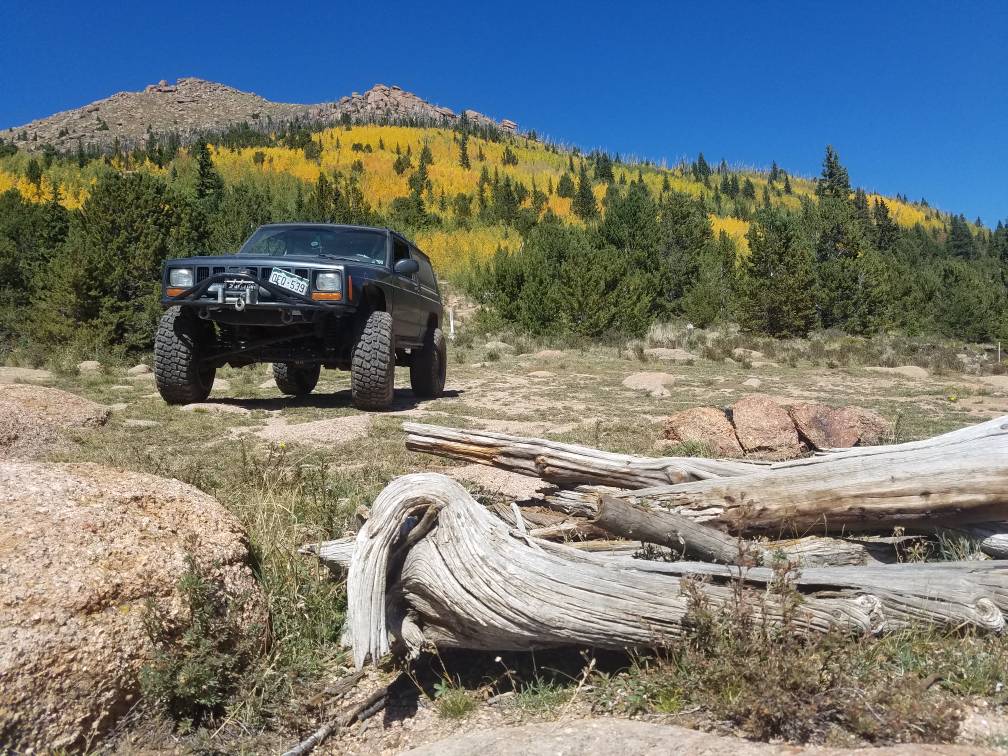

Well this is my attempt at posting my build. As the title suggests this is my first xj build and it is by far one of my favorite projects. Being I'm doing this on my phone I'm sure the pictures will be slightly out of order so please bare with me.
Well starting out I have a 98 2door 5 speed that came with a Clayton 4.5 or 5.5in???? Long arm, custom bumpers, frame stiffness and a ford 8.8...... not a bad start. It also had 4.10s with auto lockers.
Well I initially was happy with the setup but while deployed someone stole my jeep, joy rided it then tried running from the cops and wrecked it. Unfortunately in the state of CO any vehicle that is stolen and involved in a traffic accident is considered a total loss 😣. Nonetheless, i bought it back and the work begin.

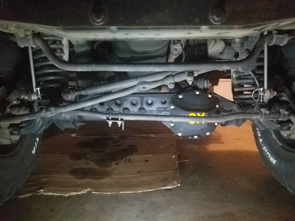

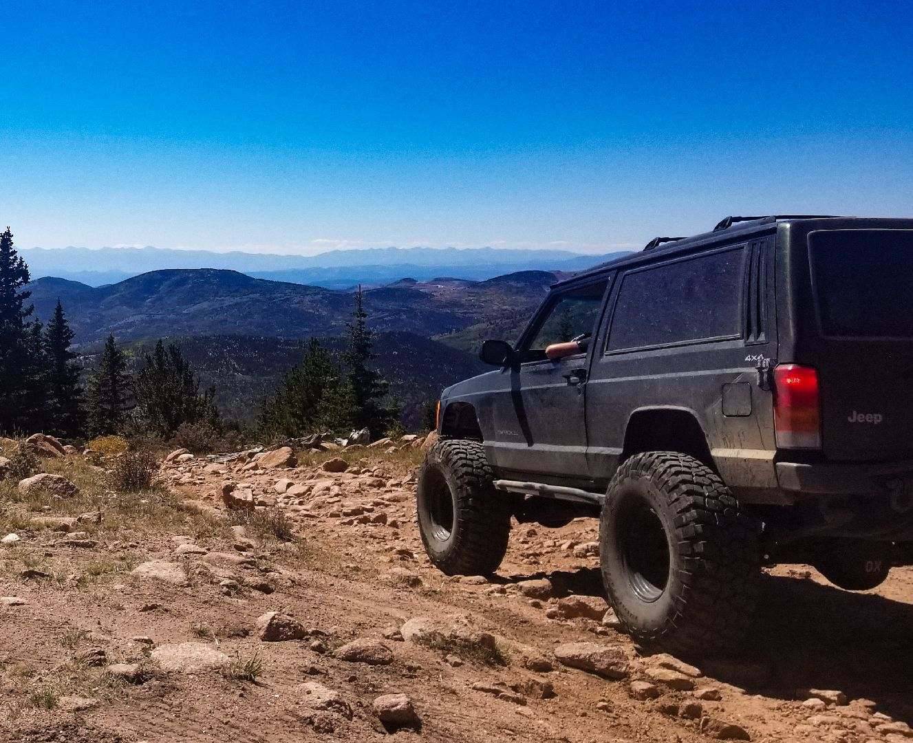

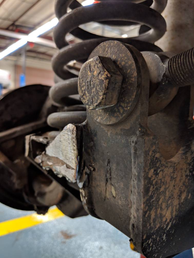

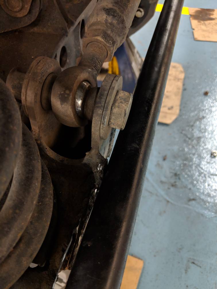

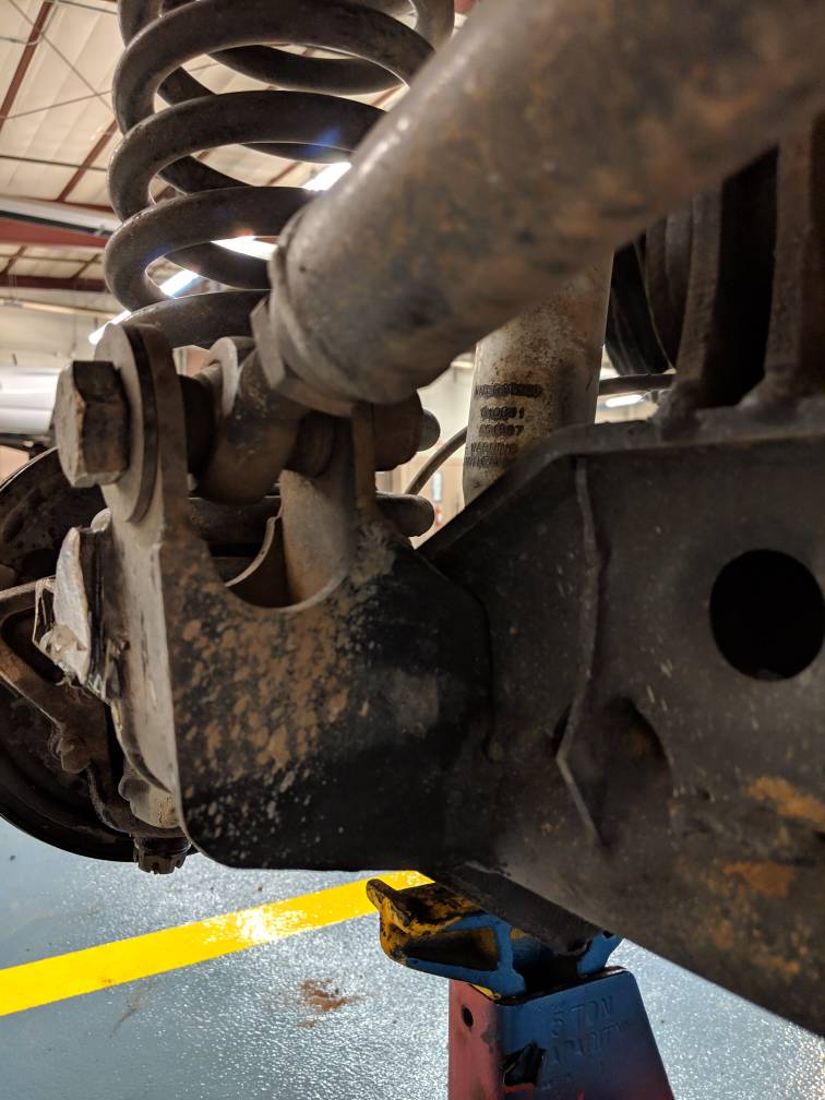

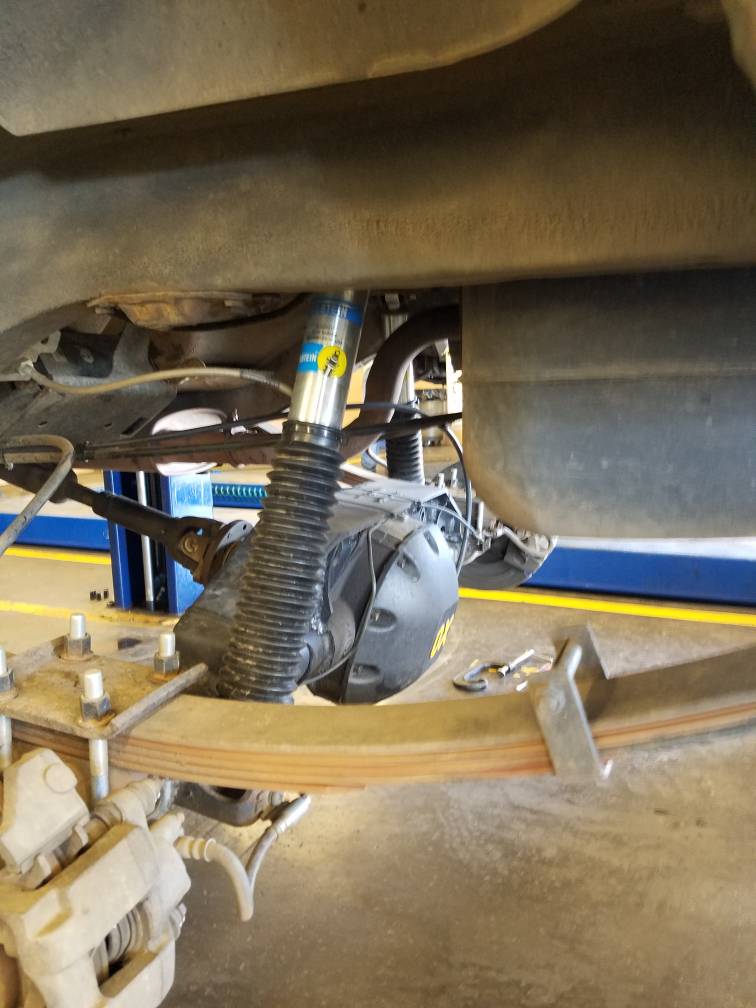

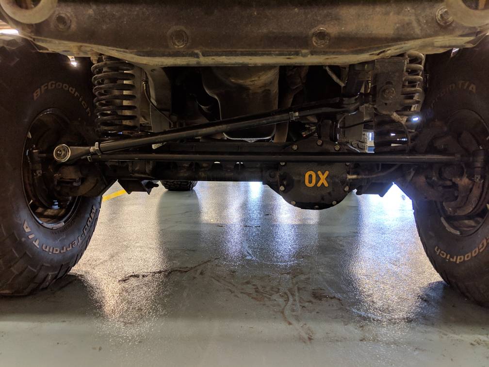

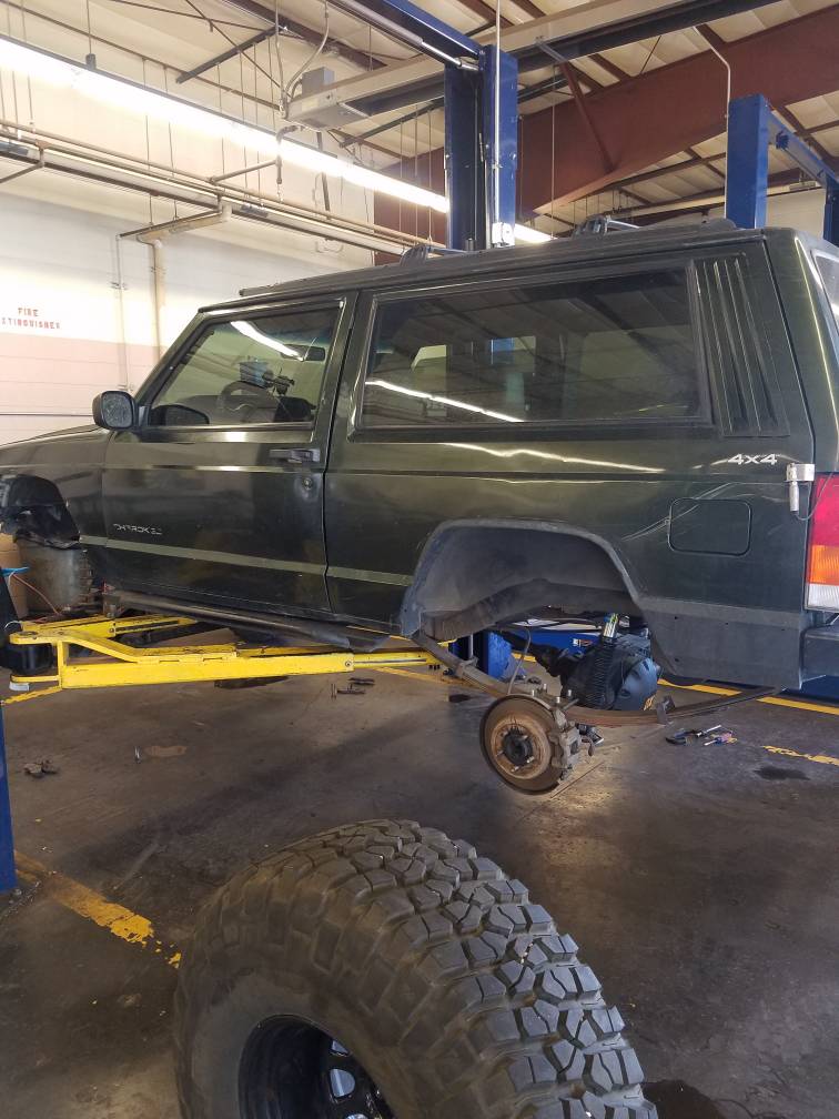

That brings me to today... I don't have "build" pics but i do have before and after. Currently I have trimmed the fenders, added artec truss (front and rear)/ gussets, 4.88s, 35in bfg KM2s, new steelies, ball joints and OX front and rear cable actuated lockers (wanted to avoid air or electrical failures while wheeling).
Next weekend I plan on revamping my cooling system, replacing head gasket, valve cover gasket and spark plugs. I currently have a like new oem radiator (would like all aluminium but got this radiator for next to nothing), flowcooler water pump, and hesco high flow thermostat housing sitting in my garage waiting to go in.

What length cables did you use?

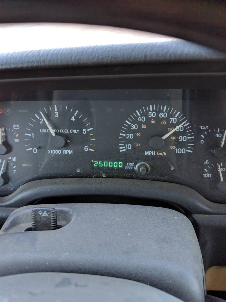

Well I put in the flowkooler water pump and hesco high flow thermostat housing. Today was just in the 80s and I was driving down 25 during rush hour (stop and go traffic mixed with steady flow traffic) and the temp gauge ran just over 210 with the a.c. on (I wanted to put extra load on the engine to ensure it wouldn't over heat). It's still getting hotter and still some what nervous if it's already over 210; despite it not getting hotter than pictured and the aux working. Paranoid I guess. Some people say they never run over 210 so idk the truth behind that.

Be sure to burp the cooling system a few times. 210 isn't bad. Look online for the O-rings for the oil filter adapter. The last time I was at the dealer, they didn't carry them anymore.

Ya I burped it. I ran it for probably 20 mins or so with a non spill funnel. I have a radiator waiting to go in aswell but I'm trying to get a gauge as to where is running currently because I dont think I need it? But won't hurt to get a comparison.

Yeah, if sitting in traffic, on such a warm day the temp sits just above 210 and stays there...... you're doing just fine. Jeep manuals show that operating temp for the 4.0 is 213-215 degrees. Hood vents, or hinge to hood spacers do help.

Temp looks good. As long as it can sustain it and not struggle to hold that temp you’re fine. Remember that the gauge isn’t great tech. Put a gun on it to see what true temps are and go off that.
