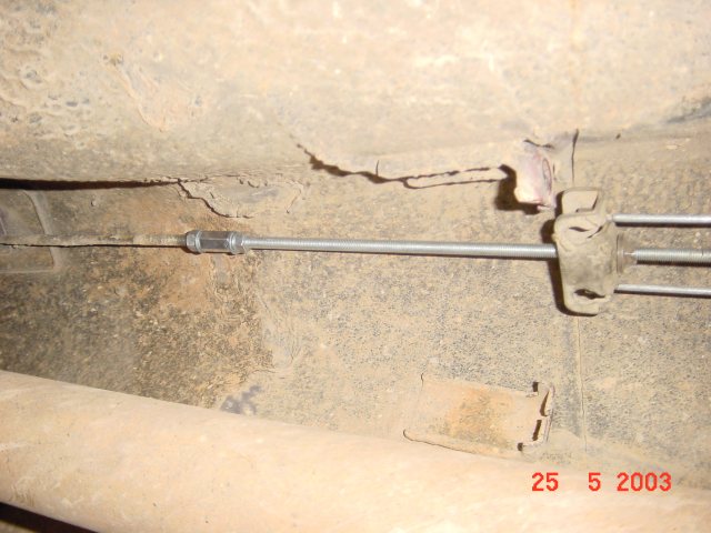

If there is a part of the rod left, (in other words, it didn't sheared off at the mounting point), get the followings:
- an 8mm x 0.125 all-thread
- some nuts for the above, washers etc.
- a connecting nut for the above
Then do this:
This will extend your rod enough to reach the bracket where the cables mount.
Don't hesitate to come back if you have questions.
Rgds
John SV1CEC
Its often times called a rod coupling as well. Most hardware stores should carry them.
I found everything I needed to adapt the above at ACE Hardware; you may have to wander the bins by yourself though as the hired help isn't wont to hang around looking for a $0.90 part. I was going to refer you to http://www.yuccaman.com/jeep/dana44.html for the thread pitch and photos, but it appears someone neglected to upload the writeup after completing the parking brake install...:D I'll get to that in a few days, I hope.
