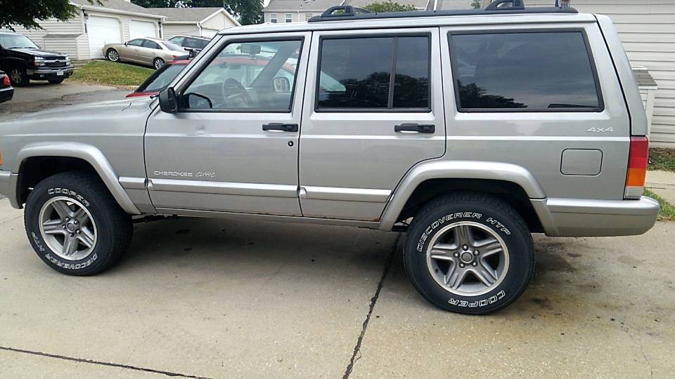

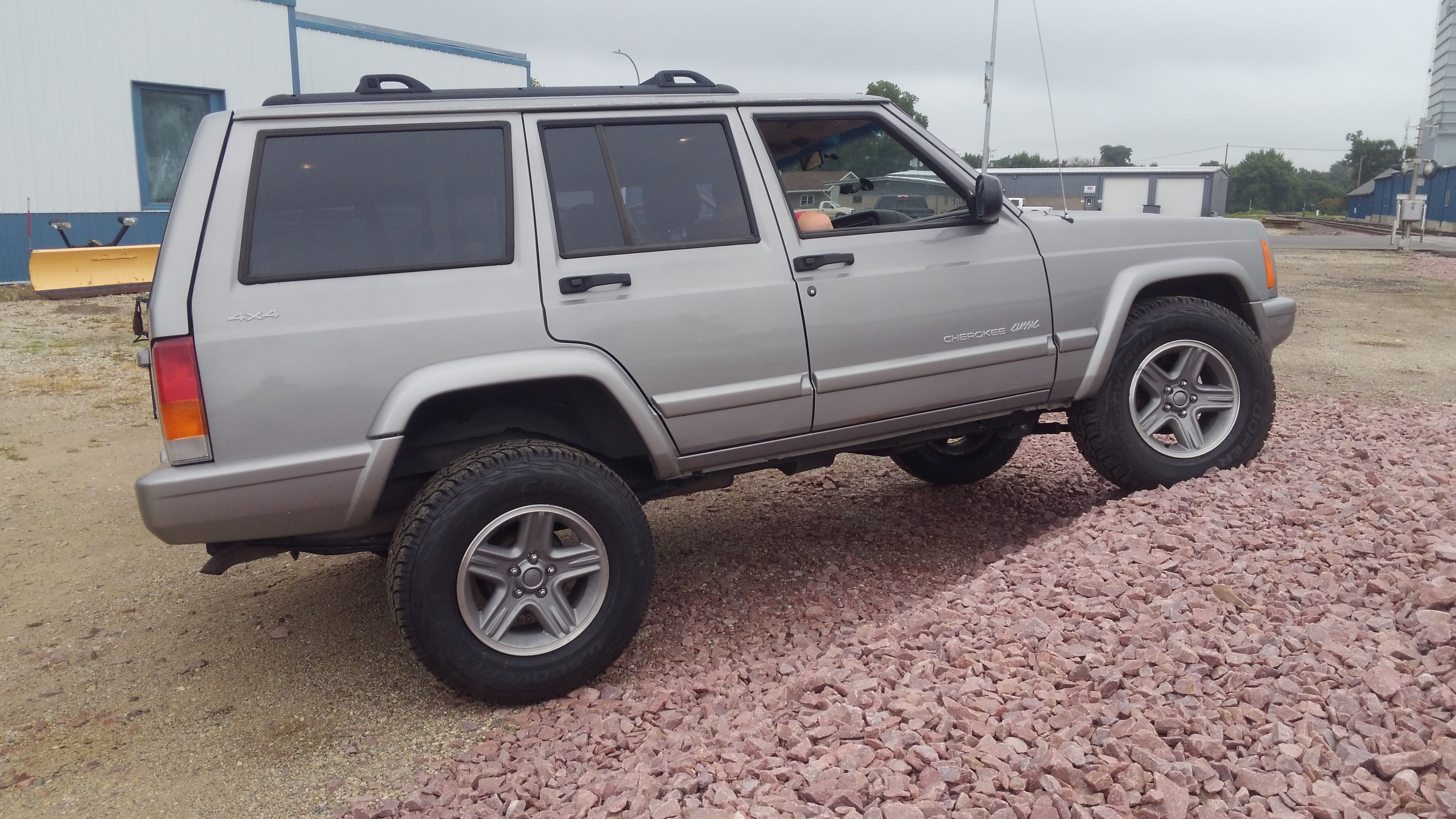

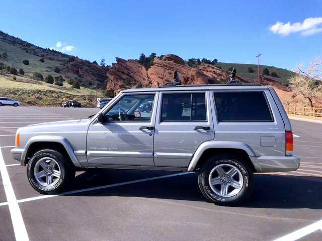

I just did my '00 couple week with Moog CC782 coils, shocks, Husky/General 755# leafs w/ OME D22XL, NOS MJ shackles, and Ironman4x4fab UCA and LCA (did axle side bushings too) with very positive results. I will post pictures up of before and after if I can figure it out.
Rides like Brand-used now after 21 years.

Hard to tell but the leaves in that picture look pretty flat. Are they? The rear lift height looks perfect. Beautiful XJ too btw.
The leaf packs were flat almost immediately after installation without the OME add-a-leaf. I've since put in a request to Husky/Dayton Spring for a warranty and or refund. The full length AAL really smoothed out the ride quality and firmed it quite nicely also. Thanks for the compliment, it lived in CO most its life before the drive to live in the rust belt.

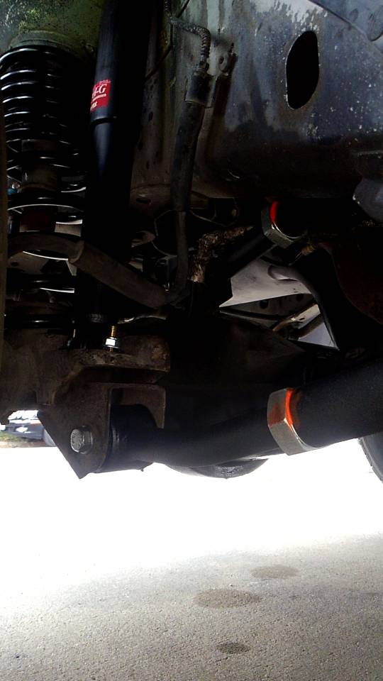

I got the springs yesterday and was surprised by what I got. They are the same part number but were made in two different countries, Mexico and Columbia. You can see that the Columbia product seems to be of better quality. The Mexico springs taper to a thinner edge and are cut square instead of having the corners trimmed to reduce friction.
I am afraid that one will have a different loaded height or shorter life than the other. So I ordered a third spring in hopes of getting one that gives me a matched pair. I am really hoping for the Columbia made version. Guess I will see.

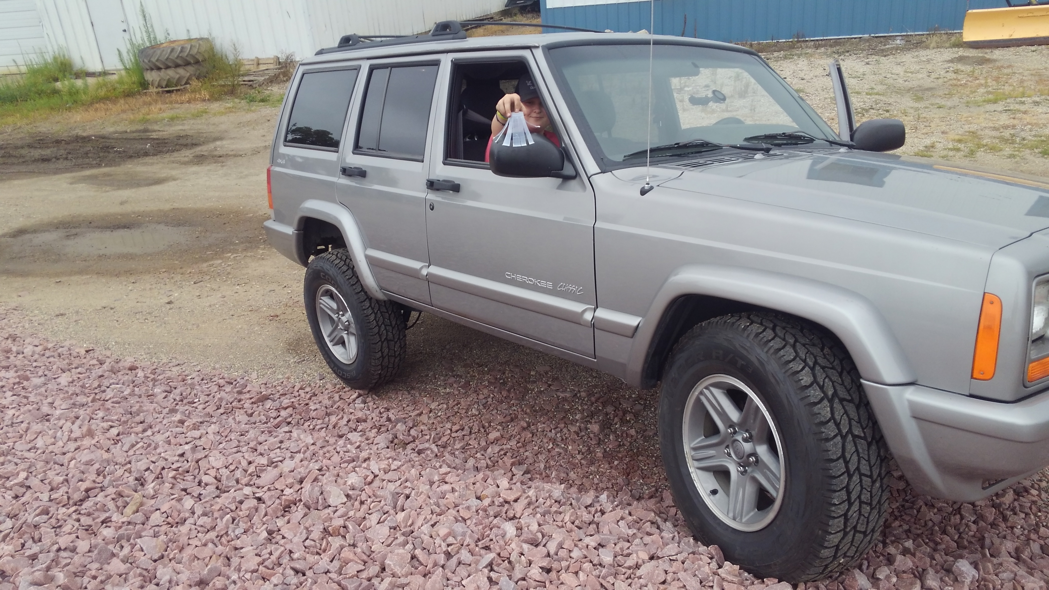

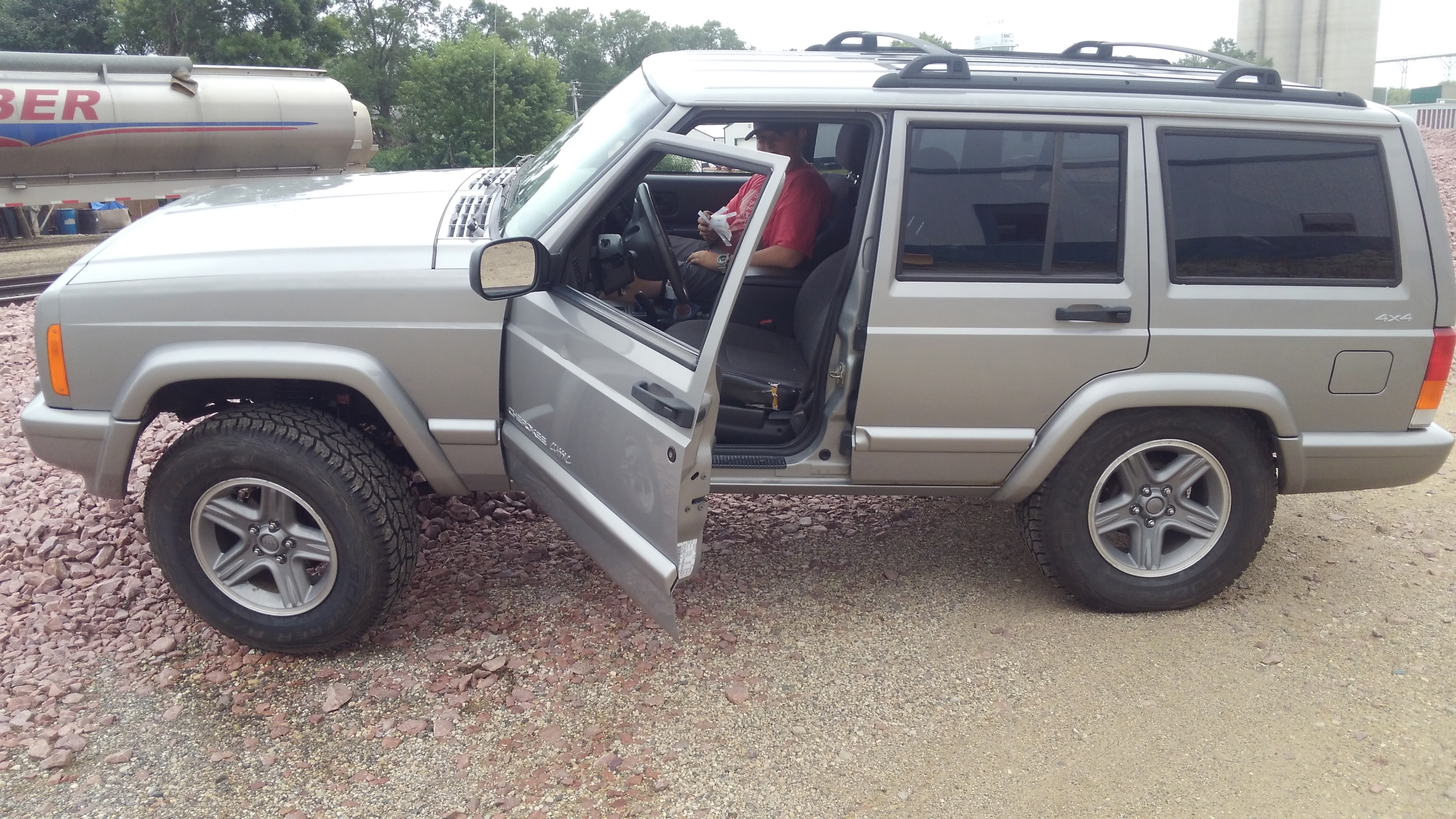

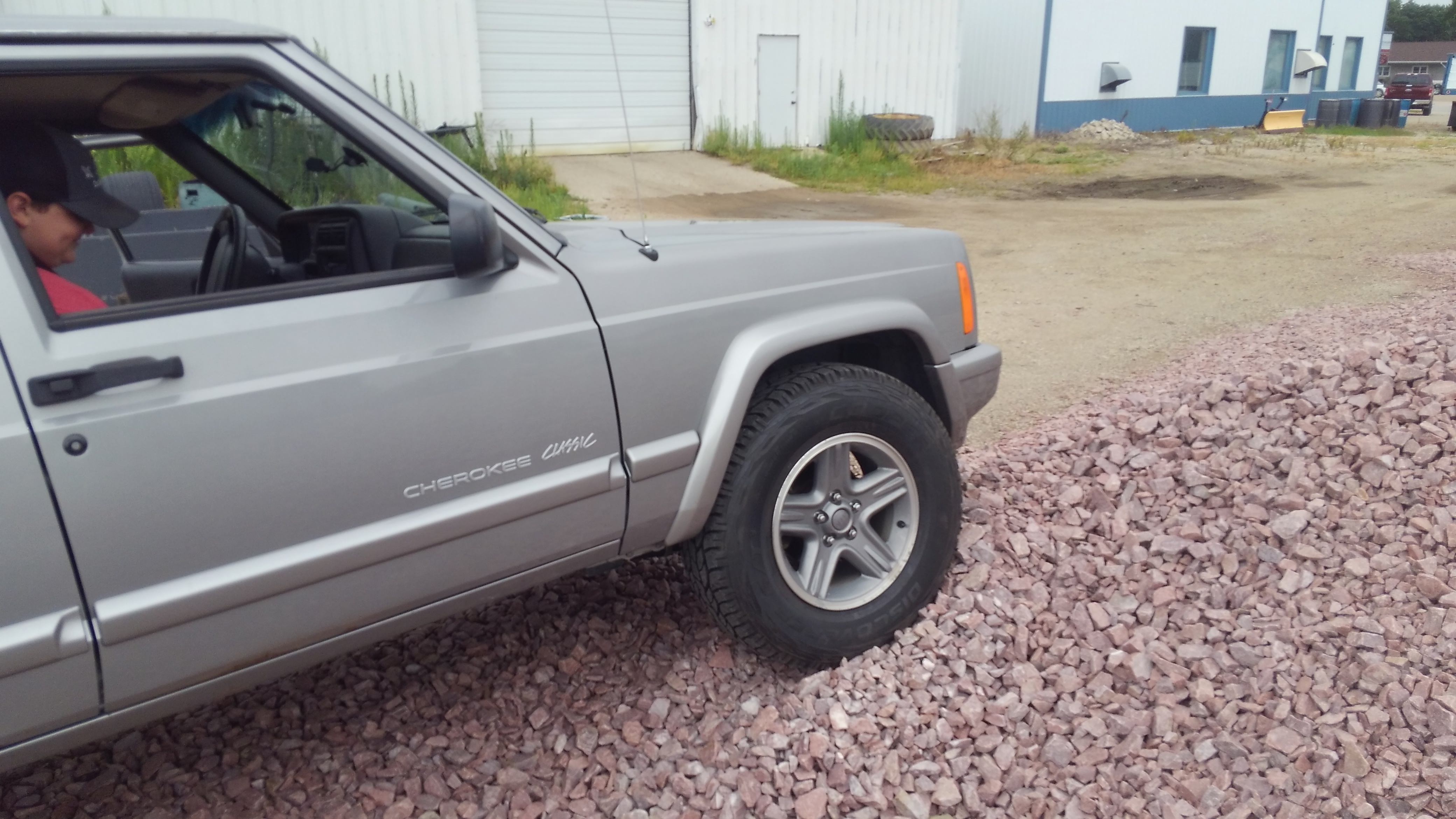

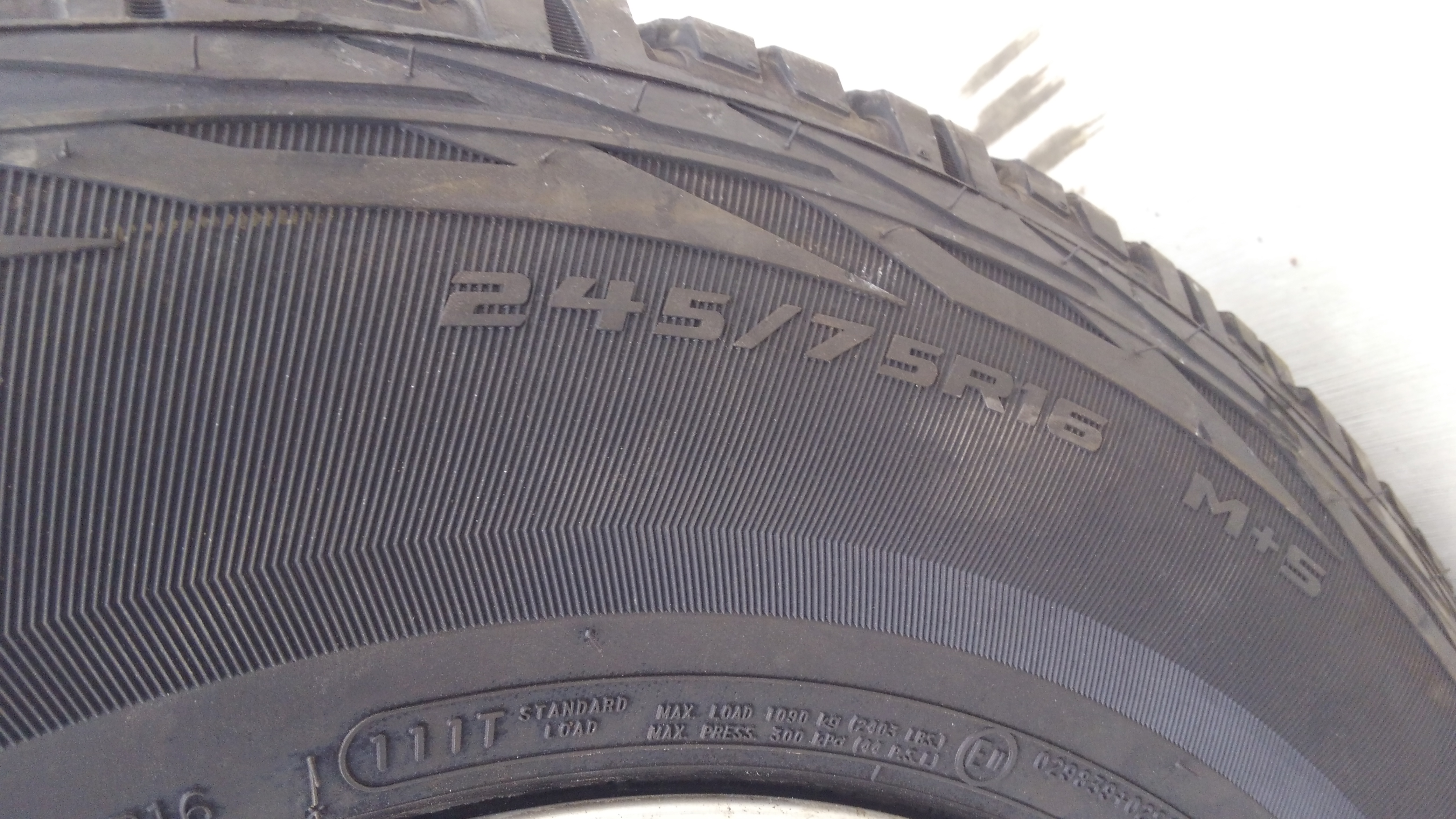

Cooper AT3 mounted today with matching spare wheel. Looks like it should have been made this way on 245-75/16.

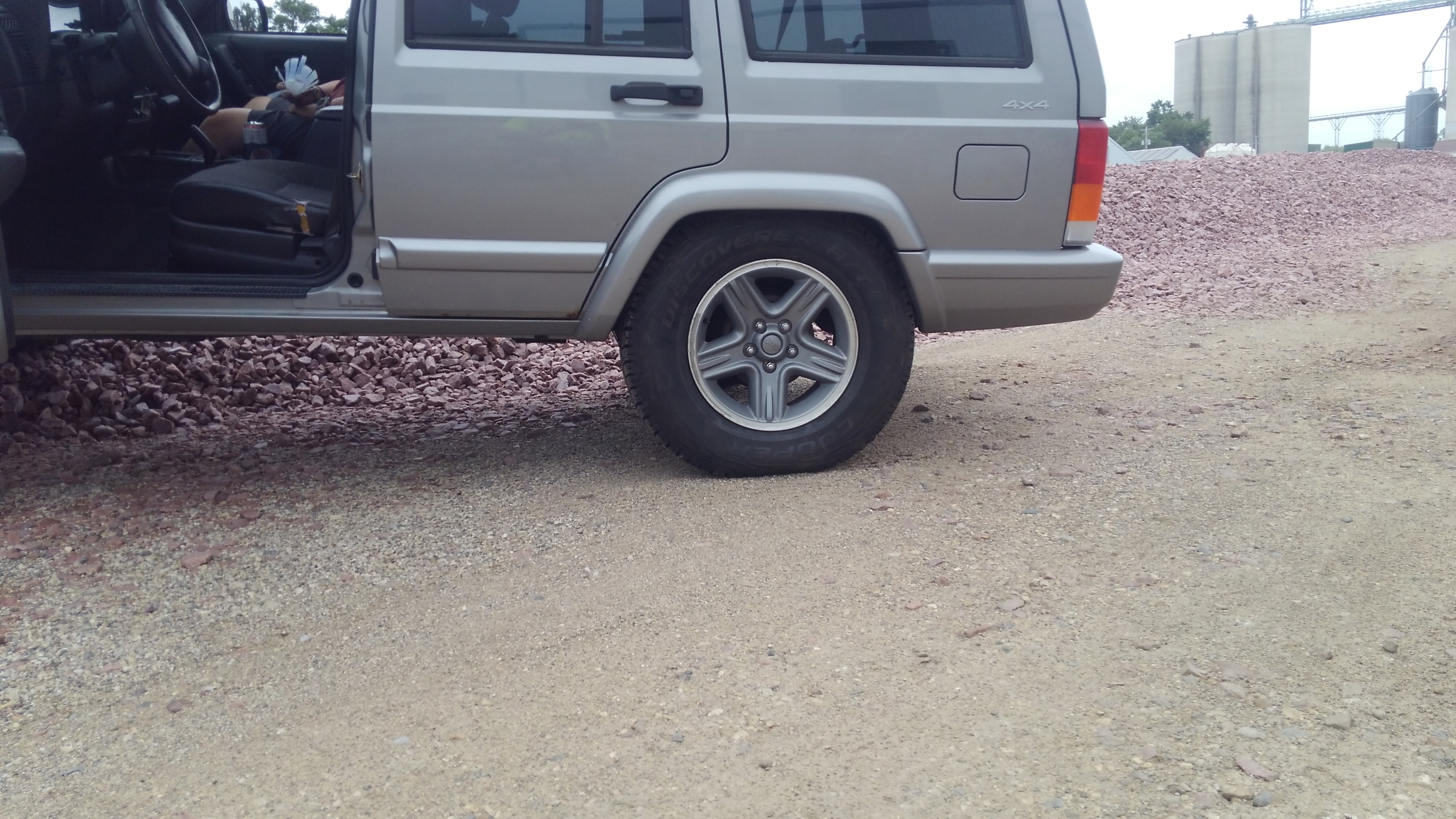

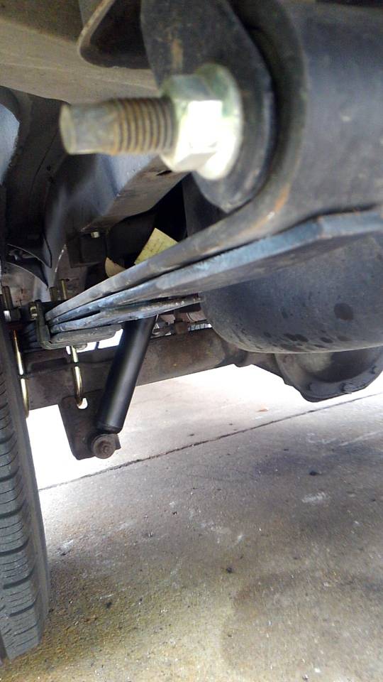

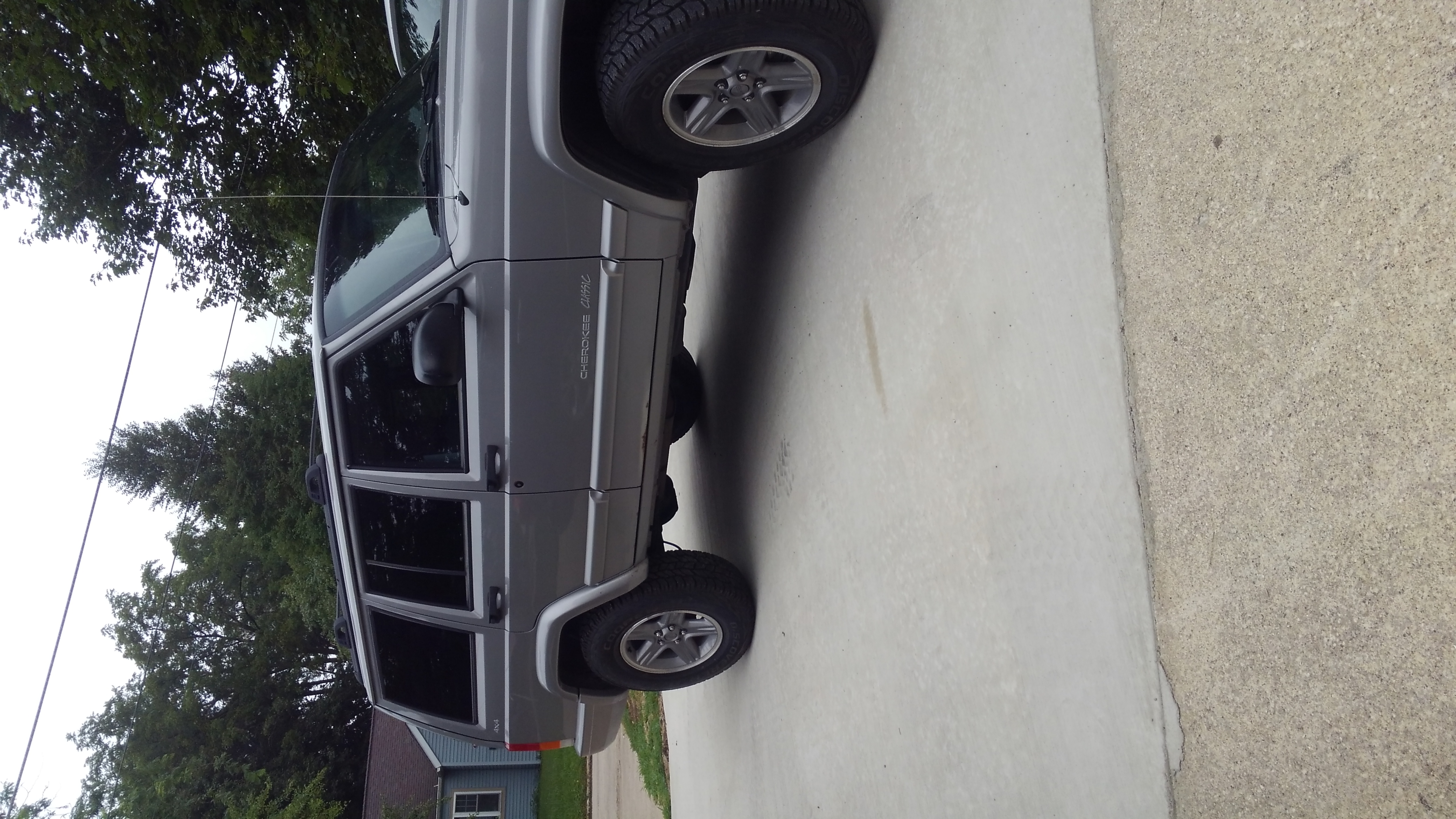

This is how tire the factory springs are. Previous owner put 2" shackles on it and it sits at 18" in the rear (hub to fender)

I'll get measurements on mine tomorrow. The old leaf packs on mine were about the same without a lift shackle. Yikes those are sketchy.
